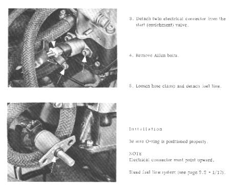

Looking at the Cold Start Valve from the top, it has a fork connection with two wires: yellow (starter) and red (ground)
Which way around should they go? Yellow on left or right inside the fork connector (looking at above pic?)
Related to this: how to the wires go around in the thermotime switch (left chain tensioner cover). Brown fits left or right (from rear)?
Many thanks

Jacob,
I'll answer the easy one first. The thermotime switch has two different size terminals. Look very closely and take notice that one terminal is bigger than the other. The red/black or (brown) wire goes to the bigger terminal and the yellow or (yel/blu) wire is for the smaller terminal.
For the CSV, yellow on passenger-side (letf on picture) and red/blk on driver-side (right on pic). BTW, these were in reference to CIS-SC engines.

Good stuff; like Tony says.
BTW: The plug for the CSV (and AAR, WUR, ASS) on SC's usually fits one way only.
