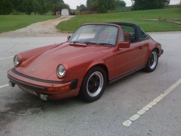

my new 83 sc targa and some questions
got home from the 13 hours drive today and loved every minute of it, but my face and head look like a ripe tomato (targa off the whole trip). the only complaint would be the previous owner's "sound system". he installed a cheap pioneer hu and some speakers with an amp but either the installer did not know how to tune an amp or the amp is crap. my money is on the former. the entire way home the front speakers would work for 5 seconds then shut off for 5 seconds. doesn't sound like much until you drive 13 hours with that happening. the amp may be going but due to the on/off nature i think the gains were not set properly and it is being overdriven. he mounted the amp under the driver's seat so i could not get at it to swap the speaker wires either. god that was annoying.
no problems along the way but i do have a few questions.
on the dash, under the oil pressure gauge on the bottom, is a rocker switch. can't for the life of me figure out what it does. anyone?
top of the dash has a little red light with SWB or something similar on it. what is that for?
the light for the parking brake works but not for the seat belts. can anyone tell me when the seat belt light should normally be on? based on the age i doubt it but is there some sort of a sensor connected to the seat belts?
while it came with AC it does not work. in the middle of the seats, under the heater controls, is a button that says defrost. what is that for? i already have defrost on the normal controls as well as the rear defrost knob.
is there a way to recalibrate the speedo? mine is about 12-15% off.
i noticed during the few short times when i had the top on that it sounded like the defrost/heat fan was running when it was not on. it sounded just like it did when i had the fan on, only it wasn't. i then saw the vent in the hood just in front of it. is this a direct path for fresh air? if so it seems like at freeway speeds the air is rushing into the cabin and pushing the fan on it's own. is this the case? at first i thought it was coming in via the targa top but there is not a bit of air to be felt on the inside. it is a pretty loud sound and got to be annoying after a while.
the passenger side window does not go down all the way. the front sticks out just under an inch when "down" all the way. i am assuming this will be an easy fix once i get into the doors but does anyone have any insight?
the driver's lock only works via the key. try as i might i cannot get the round knob inside to spin nor does it move when i lock it with the key. again, once i get the panels off i will know more but looking for any insight on this as well.
lastly, where is the button for squirting the window washer fluid?
the body had a few more nicks and discoloration spots than the PO disclosed but i was already out of state to buy it with a one way ticket, and from 6' it looks perfect, so i will live with them for a few years until i get a respray. overall i am very happy with the purchase. not only did i get the car i wanted but i also got a car that will give me tons of projects to do over the next few years. that's is why the jag is going up for sale - i have nothing left to do to it
fwiw i averaged just over 23mpg for the trip with about 90% driving at 65-75mph.
