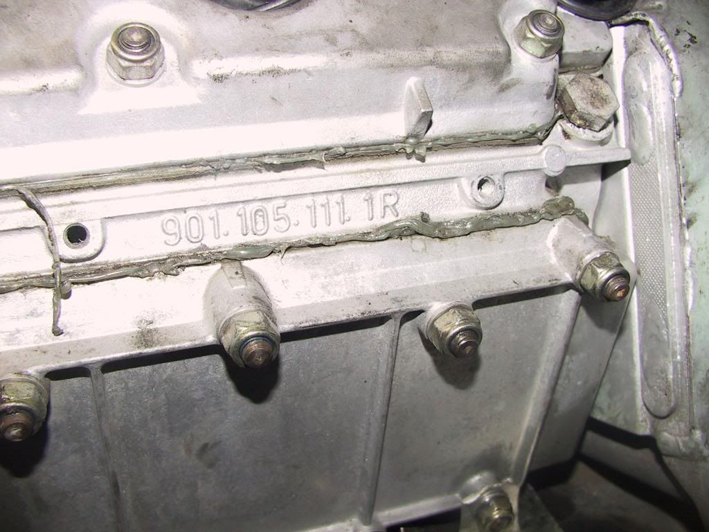

Originally Posted by Rebel911 View Post
the engine number is 6399095
thanks for the help.
Well, something doesn't look right but I could be wrong. The 639 indicates it is a model year 1969 911 S but the 9095 indicates they made over 9000 engines with that series. My info shows engine range is 6390001 to 6392126.
Look beside the number and check for the engine type. Should be 901/07 or 901/13
Tony G
2000 Boxster S
Old 09-03-2009, 05:02 AM
Join Date: Dec 1969
Posts: 943
Honestly it does not look correct you sure you copied the number correctly?
639001-6392126 are 69 s engines 2.0, your 6399xxx does not compute. They only built 2126 S (the last one I own)

even the T and E engines did not go that high for a serial number T s stoped at 6198184 and E's at 6298583

Old 09-03-2009, 05:18 AM
Join Date: Dec 1969
Posts: 943
like Tony said you need to look for the engine type. Should be 901/07 or 901/13.
Can you post a picture of the whole engine?

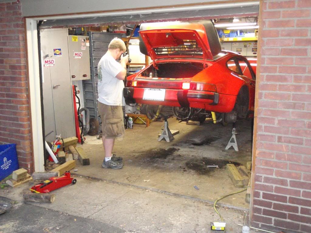

Don't knock the silicone, this is the way I got the engine. I decided to go another route.

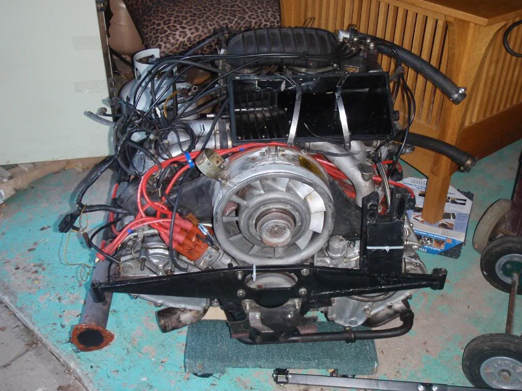

this is what it cam out of:
Old 09-03-2009, 05:42 AM
Join Date: Dec 1969
Posts: 943
its an SC 3.0 engine

I am looking to confirm that this is a ROW engine like the rest of the car.

I personally can't tell if it is a 2.7 or 3.0, but it is a CIS injected engine. Someone may have stamped in numbers from a factory replacement case, which does not come with a number. The red shroud and 639 appear to have been intentionally misleading.
YOU NEED TO IDENTIFY THE ENGINE TYPE BY THE NUMBER BEHIND THE SERIAL NUMBER.
