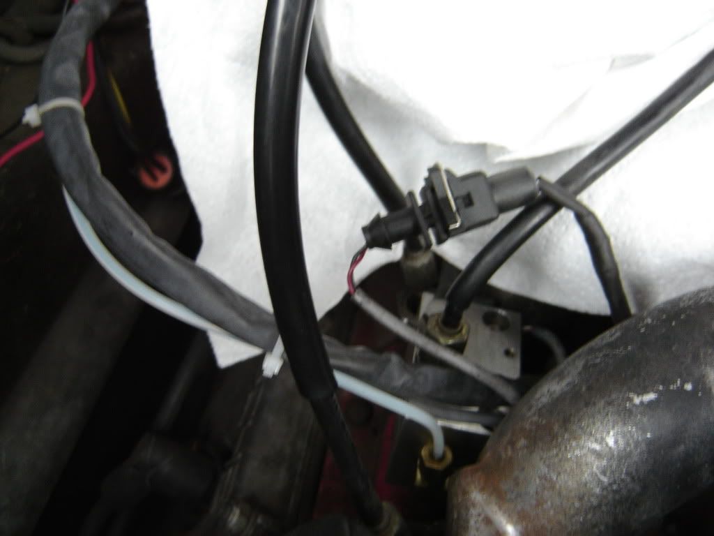

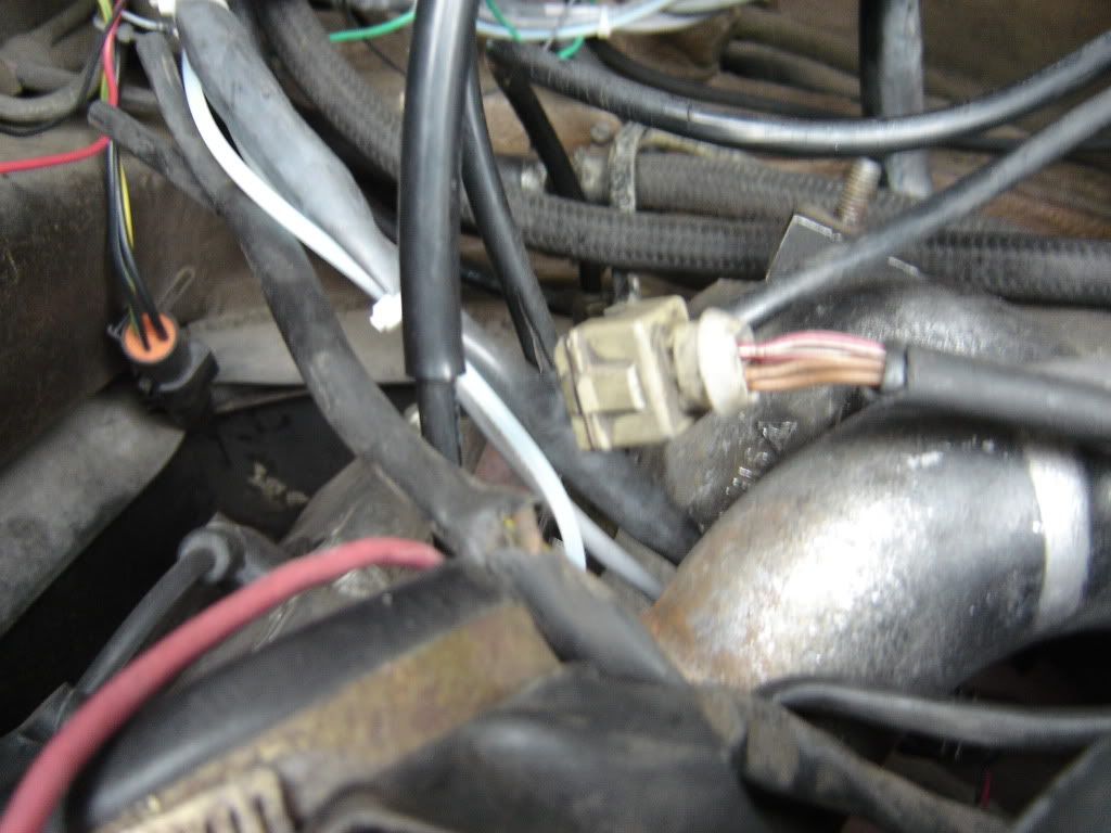

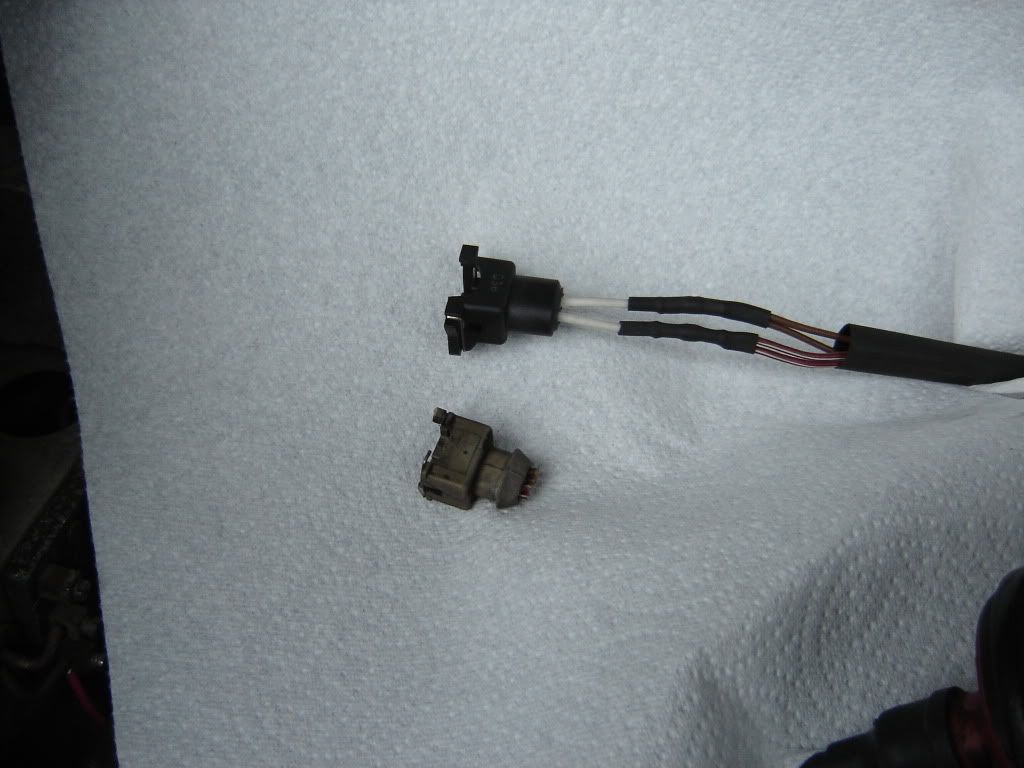

Old 12-07-2009, 12:55 PM
Join Date: Dec 2009
Location: Glendale AZ
Posts: 15
Found power problem! Bad crimp(age?) at wur plug. The crimp is for the plug and the line going over to the AAR. What a PAIN!
The red/white crimp.
First poor power to stepping motor in UTCIS-V unit.
Then no idle control. (To high.)
Then no power to AAR.
Well,just like me ,she is just getting older?
Part now on order!
Old 12-07-2009, 03:43 PM
Join Date: Dec 2009
Posts: 15
New end installed, NAPA # 2-18457
System reinstalled and running!
