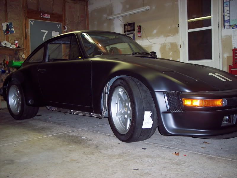

Working with a 76 3 pin box, pins A,B and C I know A and C are coil and points but where does pin B pick up its power? and is it 12v? We are having some problems getting spark to the plug wires, we did the test using the coil wire and a spark plug along with tripping the points and get a spark there but I am thinking when we crank the starter something is dropping out.

Thanks, The car this is going in has hacked wiring, everything seems to work up to the point of cranking the engine then it seems to loose power so we will check voltage as we crank and see what happens.

OK, got it, What was happing , I had 12v to the B wire but when cranked the 12v went away. So there needs to be another 12 v supply only with the key turned to the start position. I found out the the one wire came of the fuel pump rely which its suppose to do. That one loses voltage when cranked This wiring harness is a mess, if you could just see it you would pull your hair out. Put 12v to the B wire and it fired up!!! so everything is good
