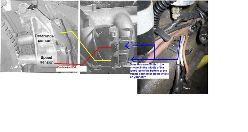

Which body wire is for the Crank speed sensor?
1987 911 3.2L Stock Motronics system. Getting ready to put the engine back in.
I had a lousy loose label on the wires that connect to the two crank triggers and the head temp sensor. When I pressure washed the engine bay last week, I blew the label off.
I know the engine won't run if you mix up these sensors. I'm hoping someone can guide me on how to identify which wire from the body goes to which sensor?
I kept the wires on the engine side in the correct positions on the bracket (Pictured) that bolts to the intake, so I'm hoping that Porsche kept the orientation correct AND hoping that the body wiring is somehow identifiable without tearing things apart.
The closest I can hope is that the two white wires shown below are always in the same orientation, left to right, in the factory wiring loom.
Scanned in from my Bently manual:
Can anyone tell me which body wire is the speed sensor, and which is the reference sensor?
Thanks,
Richard

Old 03-10-2010, 07:47 AM
Northern, CA
Join Date: Dec 2009
Posts: 275
Try This
If you didn't disconnect the plugs from the bracket in the engine compartment this may help. According to Bentley both sensors are electrically identical. The wires going to the engine compartment bracket should be labeled. The speed sensor is labeled 'DG' and the reference sensor is labeled 'BG'.
The bell housing should also be marked 'D' for the speed sensor and 'B' for the reference sensor.
The white connector on the engine compartment bracket is the CHT sensor.
I couldn't find a picture that actually showed which of the bottom two connectors were which. Hope this helps.

Old 03-10-2010, 10:02 AM
RichHawk's Avatar
Join Date: Jul 2009
Location: Kansas City
Posts: 487
Pictorially, this is what I'm hoping you can look at for me..
Does this wire (White 1, not in the middle of the loom) go to the bottom connector or the middle connector bolted to the intake?
Thanks for taking the time to do this. Richard

Old 03-10-2010, 10:27 AM
Northern, CA
Join Date: Dec 2009
Posts: 275
My '89 Carrera Sensors
I looked at my '89 Carrera if that'll help. The reference sensor is the BOTTOM of the three connectors in the engine compartment (labeled BG).
It looks like the yellow line on your diagram. If you think the '87's and '89's are the same, maybe this helps.
Since your brown wire has a white connector I would think it is the #3 CHT sensor.
All three of my wires are light grey. Only the CHT sensor has a white connector.
Old 03-10-2010, 10:48 AM
a.k.a. G-man
Geronimo '74's Avatar
Location: Flanders, Be
Posts: 13,652
Cyl head temp is the white one
Speed sensor in the middle
Ref sensor is the bottom one
Old 03-10-2010, 10:56 AM
Northern, CA
Join Date: Dec 2009
Posts: 275
Confirmed
I agree with Geronimo '74. I found a diagram in the Bentley manual that shows the sensors. P. 101-14 if you have the manual.
Top= CHT, Middle= Speed, Bottom= Reference
Old 03-10-2010, 11:02 AM
RichHawk's Avatar
Join Date: Jul 2009
Posts: 487
Yep I agree with all of that. Yellow line and red line are definite knowns. it's the blue lines that are the question..
Imagine you disconnected all three wires from that connector, How would you know which one fit where? The Body wires are not labeled. White plug Brown wire is definitely the Head temp sensor. That's easy. it's the small 2 prong plug it only fits in the top location. But what about the other two?
it's a long shot, but can you look at the orientation of the wires as they disappear in under the fuel filter. What is the order of the three sensors left to right as they enter the loom.
Pic again...

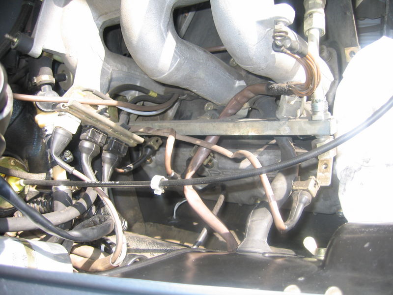

Old 03-10-2010, 01:39 PM
steely's Avatar
Location: sectors R&N, SE Pa
Posts: 3,117
Here's a pick showing DG in the middle.
This is before cable replacement. The corresponding mate had a piece of tape I think.
If the pic doesn't turn out look for the blob of yellow label - it's marked DG at the rez I can see it with under the intake - speed sensor cable side.
HTH
PS..in German...(from Wil Ferch)
BG = Bezugsmarken geber ( reference mark identifier or "giver")
DG= Drehzahl geber ( revolutions identifier or "giver")
Dan

Old 03-10-2010, 01:49 PM
RichHawk's Avatar
Join Date: Jul 2009
Posts: 487
Thanks Dan. your picture is the closest to an answer. I'll plug my White #1 wire into the bottom connector as the reference connector and cross my fingers.
So It's still just a guess, 50:50 in my unfortunate experience means it WILL be wrong the first time. and if it's not wrong the first time, I'll swap it to be wrong in error of something else not letting it run.
