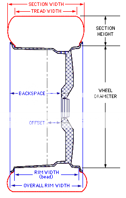

Hi all,
Is it possible to tell me the offset and model details from the following fuchs part number. I was under the impression that the Fuchs rims had a stamp on the inner rim with the offset details but mine didn't have any such stamp other than the following numbers
91136102044
AS106228139p
7jx16
fox head logo
The offset details may have been removed when the wheels were blasted
apppreciate any help

Follow this for offset calculation:
(Overall rim width / 2) - Backspace = Offset
Your wheel is most likely ET 23,3 mm regarding it's a 7"/16" with 911 part number and pre -84.

It's a '77 up 7x16 ET23.3, black ctr Fuchs, first use was on '77 C3 then later on '78 up SCs

Thanks heaps guys, huge help
