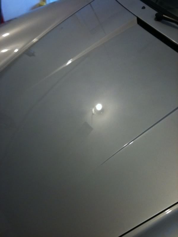

So i finally got around to wetsanding and buffing the SC
New paint this summer, BMW titanium silver metallic. wetsanded with 2000 grit sand paper, 3M rubbing compound, 3M machine polish, and Meguiars swirl x, along with zymol wax.

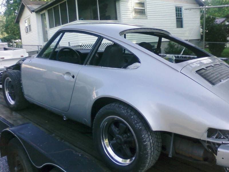

honestly.....its a $1200 paint job. It took the guy about a month and a half to do it. I took the car apart, and had all of the individual pieces painted, and then reassembled the car when i got it back. Of course i did the wetsanding/buffing on the car. Thats the biggest difference between a cheap paint job, and an expensive one. Paint was BASF Limco, with a higher quality clear. I have a couple of small issues, but the guy is going to fix it when i get my Yellowbird bumpers painted.
here is what it looked like when i bought the car last spring
here is what it looked like when i picked it up from the painter. BTW, this was done in a shed in his back yard, with NO junk in the paint at all.

I love this shot. Paint looks like it's still wet. Really beautiful car, the whole package looks perfect.
