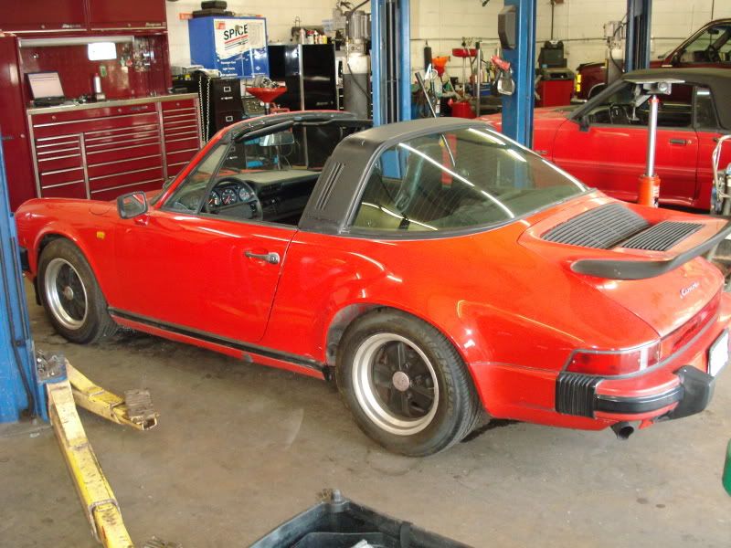

Guys I just picked up an 85 Targa ROW car. It is in ok shape. I plan on a resto this winter. I picked up the car form a customer at our shop. He bought it over a year ago for 12K and never really used the car. The fresh air motor caught fire and melted the intake. The transmission is a little funny, I suspect syncronizers. He got fed up with the car and brought it into the shop and said he wasn't coming back for it. I picked it up for 2K. I know the tail is not stock. I have serviced it and plan on having fun with it for the summer. Now to my question. I have an oil leak at the vacuum valve above the oil tank. What is that valve?

The tail is an early Turbo Tail, most likely a replica, but goes well on your ROW.
Can you show a picture of the leaky valve?

I believe it's a fresh air valve. Something to do with letting air in while the car warms up. There are a few threads about the valve but they are from a weird noise coming from them, like a kazoo, not oil leaks.

If you have an oil leak there you may have over filled the engine/oil tank. The car needs to be fully warmed up with the engine running to check the oil level.

Agree on possibly overfilling oil.
Only check on level ground, while the engine is idling at full operating temperature.
Fill to half way between the F and L lines.

It was probably overfull. I don't know who last serviced the car. The leak looks old and the valve is oil soaked. I didn't check the level before I serviced it. I have yet to put any real miles on it yet so it is probably fine. Yea I couldn't pass the deal up. It is going to be a fun car. Also what is the HP difference between the US and ROW cars?

As a first step in sorting the dodgy transmission, check the shift coupler bushings (access panel in the center rear floor). Likely it is the synchros, but you might get lucky (again) as you did with your super buy-in price. Enjoy the car!

US is 207 HP, ROW is 231 HP for the 3.2.
Oh, and the ROW 3.2 should have premium gas; 10.6:1 CR. (US is 9.5:1).

windsoreight, your '85 Targa has Porsche's old 915 transmission.
It does best with non-synthetic fluid...I'm using Swepco 201, but there are other choices out there as well. There are a bunch of threads on this.
The slick stuff is better left to the newer G50 trans, which came in 1987.

I put non synthetic in it. I think the shifter is the biggest problem. 1st is into the dash and 2nd is into the back seat. I may be exaggerating but the shifter is sloppy. I took it out tonight and flogged it. The air valve didn't leak a drop. The 2 main things I am going to concentrate on is the shifter and it has a rough idle. The idle is a little lopey but the car runs fantastic. The car has been sitting for 9-12 months. I found no vacuum leaks, I am hoping the idle clears up.

You're not exaggerating by much! Porsche shortened the throws in '86, but it's still long.
You have plenty of aftermarket choices, including Porsche's own Short Shift which was an option at the time. Pelican has a good selection.
As for the idle: mixture, O2 sensor, idle control valve, cylinder head temp sensor...the usual suspects. What's the RPM when your engine is warmed up?

nice car. sloppy shifting and "transmission is a little funny" are not the same thing. if the gears change ok but the shifter is sloppy, its probably the bushings and, the fact that your not used to these shifters...when i got mine it had new synchros but the shifter still seemed like an old tractor....to a degree, thats just how they are and you get used to it....but still check the bushings and maybe install a short shift kit
