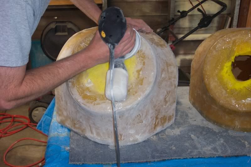

using a fiberglass roller will dramatically improve your results. i rip the mat into 2"x 2" pieces and dab a spot in the middle of each to hold it on to the surface. next i dab all over with a 2" wide brush cut down to a 1" length to fully soak all the pieces. go over everything with the roller to get rid of air and then add another layer and dab a little more resin as needed, but since i purposely put a little too much on the first layer it all works out in the end.

If you are working like these examples shown, you are using way too much of resin and this ends up in a weaker and heavier part.
The use of this batting like stuff is cheap, but only good for covers with no load, but a big mess to work with any way.
A good fiber cloth can be draped very good, is multiple stronger and will give a light and firm part.

are you talking about the pics i posted? i certainly hope not, because you are making way too many assumptions that are incorrect.

"...a little more resin as needed..." In composite business you would use a peel ply to get surplus resin away. If not, there is way too much resin on the part and this highly weakens the part. Maybe the pics are not that clear, but the first part on top with the 2 holes in looks very shiny, to me a sign of resin excess.

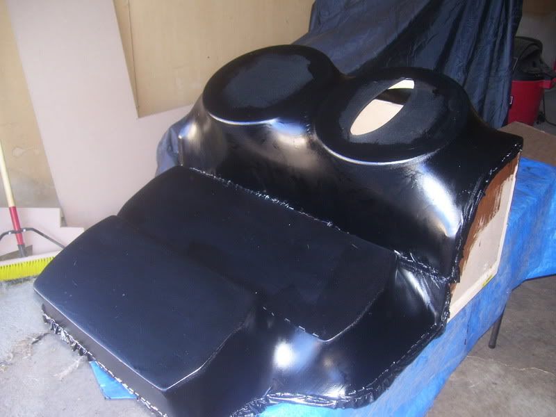

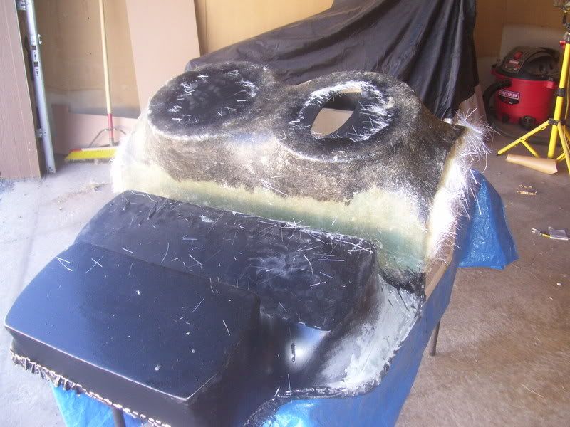

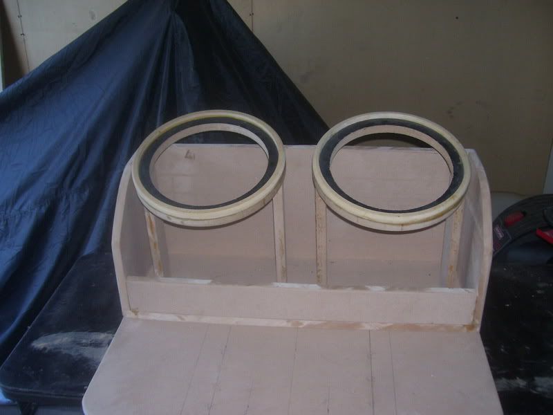

maybe we just have a communication breakdown i only use enough resin to fully wet the 2 layers per session that i use. the first layer does get a little extra resin but that is used up when applying the second layer with the roller which gets minimal, if any, resin added. the shiny part is a result of the material used to make the initial form. it is comparable to lycra (think women's gymnastic outfits) in that it is very thin and stretches in every way, however once it has a very thin coat of resin to hold it's shape and form my base it appears very shiny. it is just a byproduct of the reaction with the polyester resin.
no resin applied
resin applied
glass applied (note that this pic was taken just after i finished applying the mat and resin, so it was still wet)

Ahhh this pics are much clearer
Sorry for missunderstanding from myside
And what is this nice part?

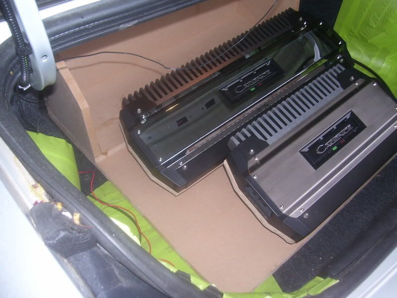

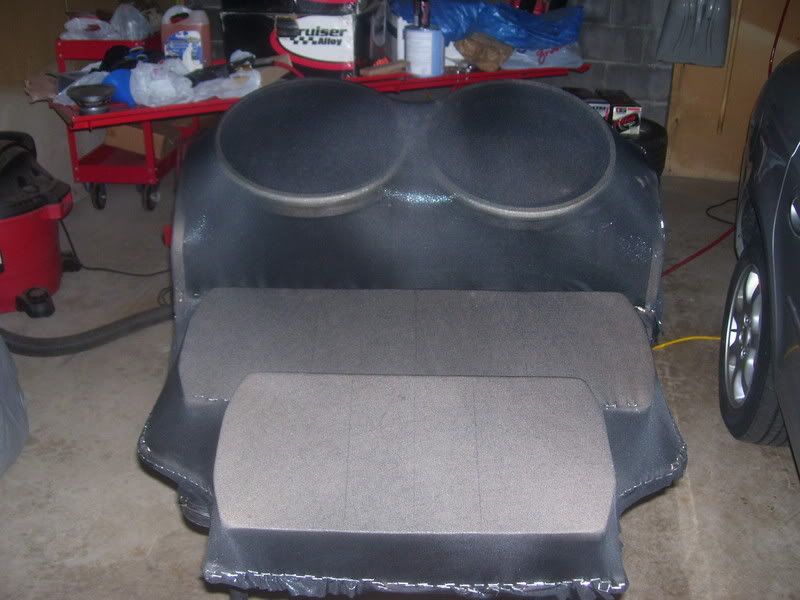

this was a build for car audio. the holes were going to house 2 10" speakers and the platforms were for amplifiers. sadly my shop was broken into before it was completed and not only were all my tools stolen but they destroyed the box with a sledgehammer. here are some computer renderings of what the final product would have looked like.
