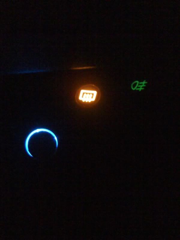

mine have bulbs inside the knobs. they come on with the lights and then get brighter when turned on, or if the lights are not on the knobs are illuminated when turned on.
lights on at night
defrost engaged
i read several posts that talk about the multiple stages of this switch (one pull out for defrost, 2 clicks out for super defrost, rotate to the right for heated mirrors). my switch will pull out but only one click. it does however rotate one click to the right. i am assuming this means i have heated mirrors but not the upgraded rear defrost setting, which seems strange. all the posts i found said that the second pull out (super defrost) was standard but the heated mirrors were an option.
