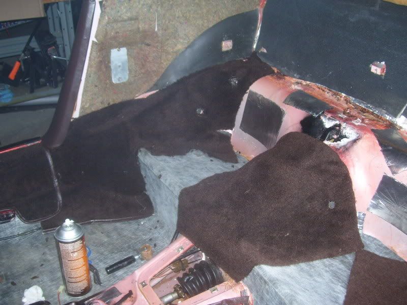

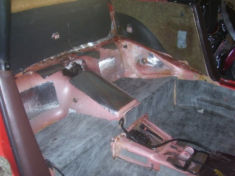

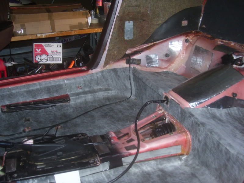

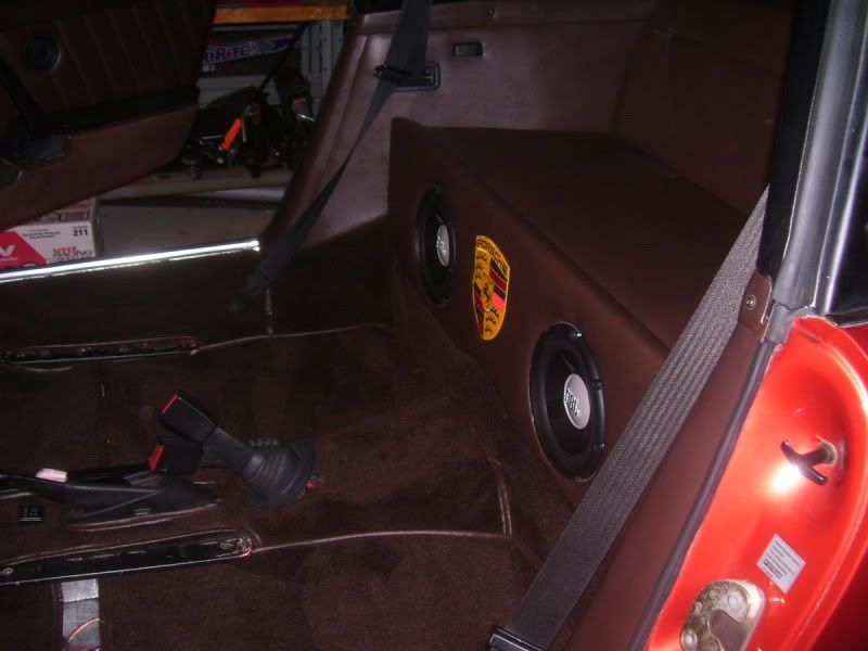

had a few hours tonight so back into the garage. finished putting down the padding first.
http://i15.photobucket.com/albums/a3...r/100_5743.jpghttp://i15.photobucket.com/albums/a3...r/100_5744.jpg
as you can see i did not cover the entire rear seat area with padding. the main reason was that the seat delete / sub enclosure will be covering all of that area already, so the padding would not really accomplish anything.

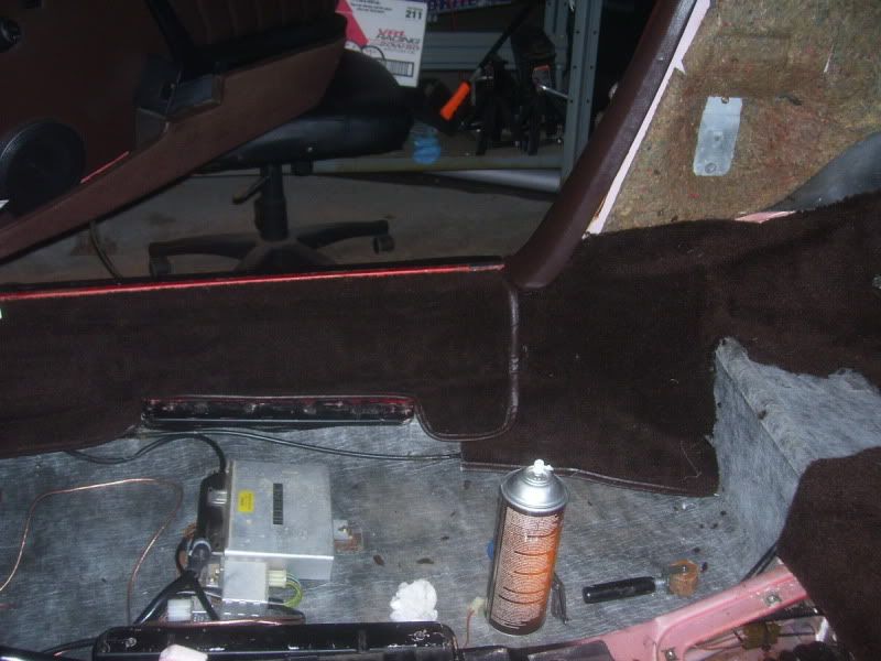

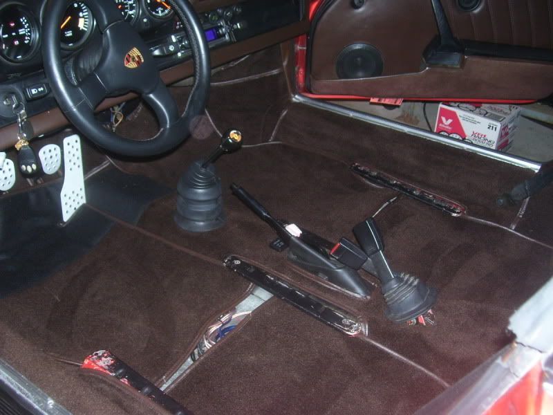

time to finally start installing the carpet! if you are planning on doing this job yourself be sure to lay out a few pieces at a time before you glue anything down to see how they will overlap and how much extra you have to work with. it took some effort and a lot of head scratching to get all the edges to overlap properly. another tip that i found very helpful is to wear 2 or 3 sets of rubber gloves at all times. you can't avoid getting glue on them and being able to just take off the top layer and having a fresh set of hands to work with was so helpful. in some of the pics you will see some new wire (mostly getting in my way!). i used some extra 12g speaker wire i had for grounds for the new power seats and connected them to the ground for the jetronic underneath the box. i left them way longer than i needed to give me lots of room to run them hidden as need be. i started off by taping up the area around the door jam that i did not want to get any glue on.
http://i15.photobucket.com/albums/a3...r/100_5747.jpg
http://i15.photobucket.com/albums/a3...r/100_5748.jpg

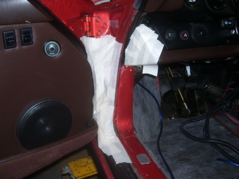

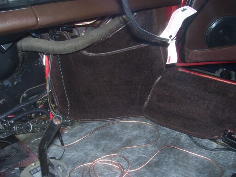

the carpet set i bought had the kick panel and the top trim piece sewn together along one edge which made it a little easier to install. i sprayed some glue into the door seal mounting area and on the back of the vinyl edge of the carpet. tacked it up into place and then formed the vinyl around the jam. once that was dry i sprayed some glue on the lower (kick panel) piece and worked that down into place. repeated the same method on the other side as well. once both of those were in place i glued down the front edge of the door sill piece to hold the front into place. it was a little tricky trimming the vinyl edge to get it just right where the carpet meets the dash but a sharp razor, some good scissors, a lot of patience and small cutting got the job done.
you can see the color difference between the kick panel and the door pocket carpeting. 27 years apparently turns brown carpet purple.
http://i15.photobucket.com/albums/a3...r/100_5749.jpg
http://i15.photobucket.com/albums/a3...r/100_5750.jpg

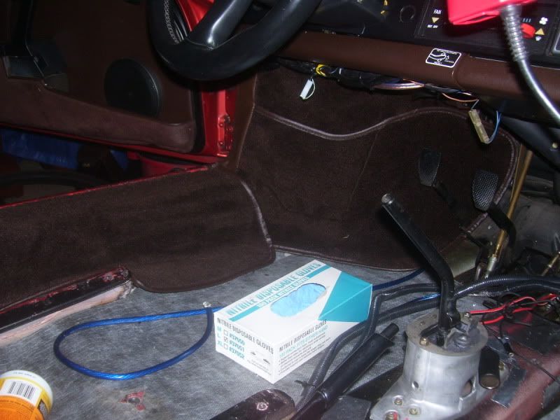

next i glued the piece that goes over the hump in the rear. again, in order to get it right i had to put the piece that goes over this (where your lower back would be if you were sitting in the rear seat) to see how much that covered and adjusted the hump piece accordingly. once i had it in place i taped up the left side in place and then glued down the right side. this is a good time to get a new razor blade to cut the hole for the seat belt bolt (i won't have any rear seats but if i ever sell it and the next owner wants the rear seats in all bolts and holes will be accessible). repeated the process for the other side.
http://i15.photobucket.com/albums/a3...r/100_5752.jpg
that pic shows the passenger side quarter piece in place as well. that piece was started with the front most edge that ends up underneath the door sill piece. had to work it up into the cracks but it wasn't that hard. started out by just gluing the first 8 inches towards the back. this piece was glued down in 4 different sections slowly working my way from the front to the back. it also required some relief cuts to be made into the carpet and i gotta say this was the scariest part of the install. there is something that just doesn't feel right about taking a blade to a brand new piece of carpet but it had to be done. had 3 seat belt related items to cut out but none were very hard. the end result has the passenger side complete from front to back.
http://i15.photobucket.com/albums/a3...r/100_5751.jpg

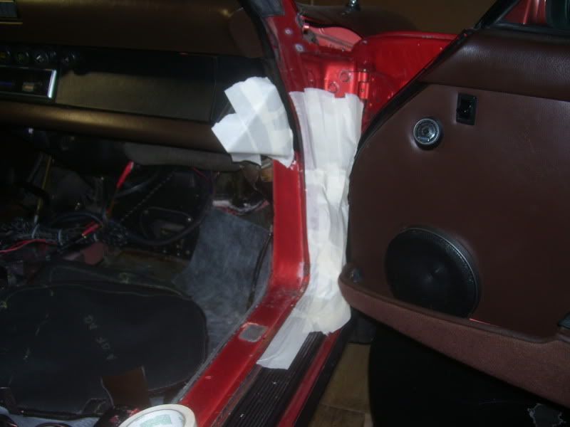

that is as far as i got tonight, and unfortunately i am almost out of glue again. i hate to do it but i think i am going to have to glue down the remaining 3 pieces with super77 since i am out of 74 and it takes 3 days to get here (i want to dirve it this weekend to a couple parties!).

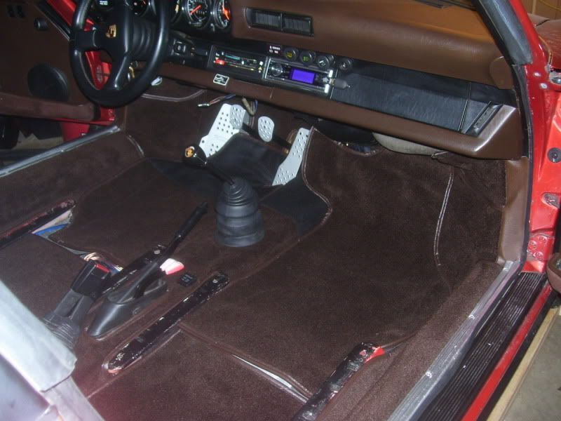

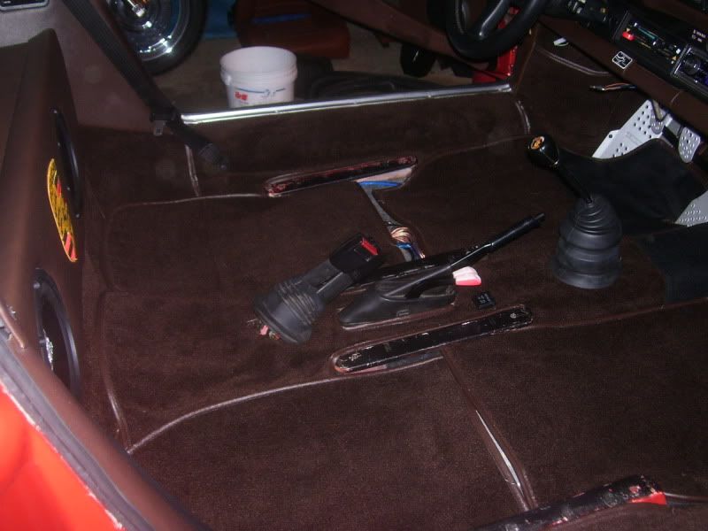

nineball 05-28-2010 07:57 PM
had the day off but got a late start. i live in a condo and a few of my neighbors are older to say the least, so i take care of about 6 cars in my association for things like oil changes, brakes, tire rotations, etc. i had promised one of them i would do an oil change and rotation at 10 this morning so an hour later (and a nice plate of freshly baked cookies) i got started.
first thing was to try to find some more glue. i called 3m and asked about using super77 or 90 but was told neither was good for my application as they are only rated to 105 degrees, at which point they become mush and lose all their stickiness. looked on their site for a local supplier, 27 calls later i found an ace hardware that said they had the 74 in stock. the only catch was that it was about 35 mins away, but an hour of driving beats the hell out of waiting for a tuesday delivery with 2 parties to go to this weekend so off i went. got all the way down there to find the woman who answered my call, even after saying she checked, lied and they only had 77 and 90 like everyone else. i was about to say f-it and go ride the bike but then i pulled out the iphone, googled "auto upholstery" and found a place about 10 mins from where i was. called the guy, explained my morning and asked if they sold supplies. he said they were not a retailer and bought most of their stuff in bulk but he did have half a can of some high temp fabric adhesive that would fit me needs. drove over, talked for a min and they guy gave it to me for free! no kidding. i asked him a few questions about dying my seats and after a nice discussion i realized that this job was a little more than i wanted to attempt, especially on my first try. if they were like my stock seats, meaning no inserts, i would have done it but since i only get one shot i have decided to let that shop do it for me. he quoted me $200 as i was supplying everything, and for the piece of mind the price is right.
on to the carpet....
almost everything is done now (still have to do the door pockets but they can wait til monday or tuesday) and it came out great, with one minor exception. in my excitement as i drew nearer to the end i completely forgot to put the factory sound pad back on the seat bottoms before i glued in the carpet, so it will not be going back in. i guess overall it is a good thing when you add the weight of the rubber pad with the asphalt sheeting i removed it just about evens out the added weight from the rear seat delete / enclosure and speakers. the damplifier pro and padding weighed in at right about 19lbs so that was not a big concern either. i have some damplifier pro down, some padding over that and the enclosure so it should be just as good at blocking noise as the factory piece was alone. i also put in the new door seals and a set of rennline pedals and dead pedal. everything is glued into place but the center tunnel piece as i plan on installing a factory short shift kit sometime next week and wanted to make life easier. the jbl subs are pretty damn amazing for a pair of 8 inchers - THANKS TODD!!!
here is the finished product:
http://i15.photobucket.com/albums/a3...r/100_5754.jpg
http://i15.photobucket.com/albums/a3...r/100_5755.jpg
http://i15.photobucket.com/albums/a3...r/100_5756.jpg
http://i15.photobucket.com/albums/a3...r/100_5759.jpg
http://i15.photobucket.com/albums/a3...r/100_5760.jpg
http://i15.photobucket.com/albums/a3...r/100_5758.jpg

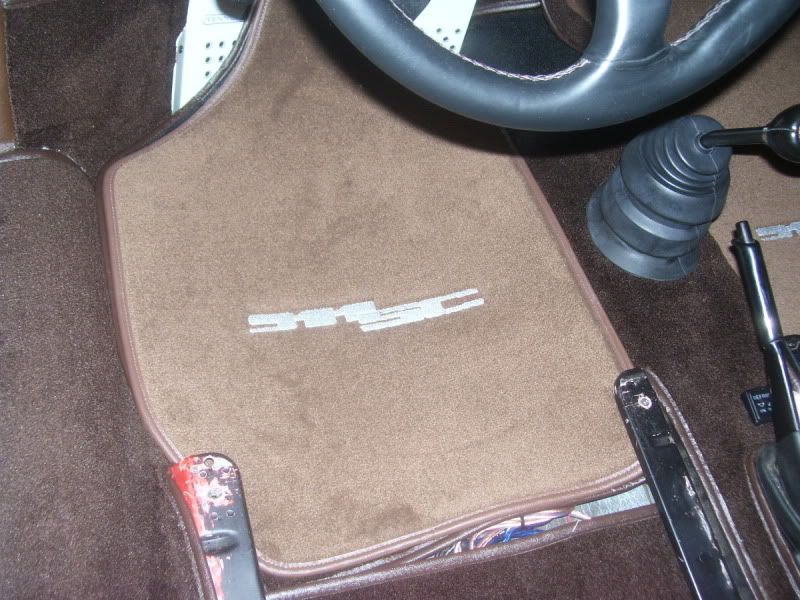

i had some custom mats made as well, and while they are a lighter shade of brown they will only be used for shows and such, not regular driving, so i can live with it. once the seats are back in it will separate the front from the back and it will look a lot better.
http://i15.photobucket.com/albums/a3...r/100_5761.jpg
http://i15.photobucket.com/albums/a3...r/100_5762.jpg
now i can actually enjoy the car for the summer. all the engine work was done over the winter and the interior is now complete. next winter i plan on new paint and then (i think) i will be done, but we all know how that goes....
