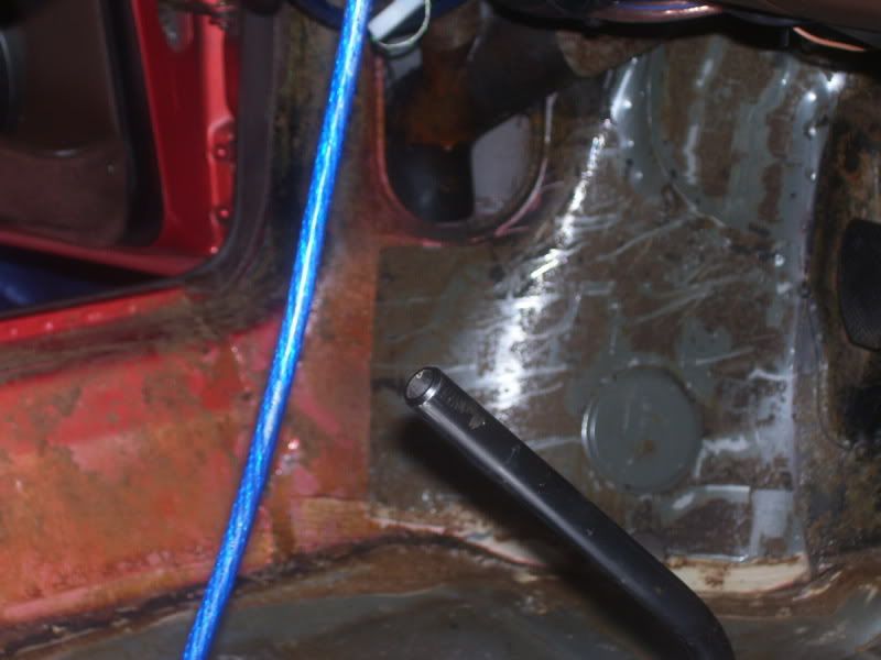

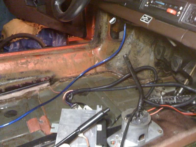

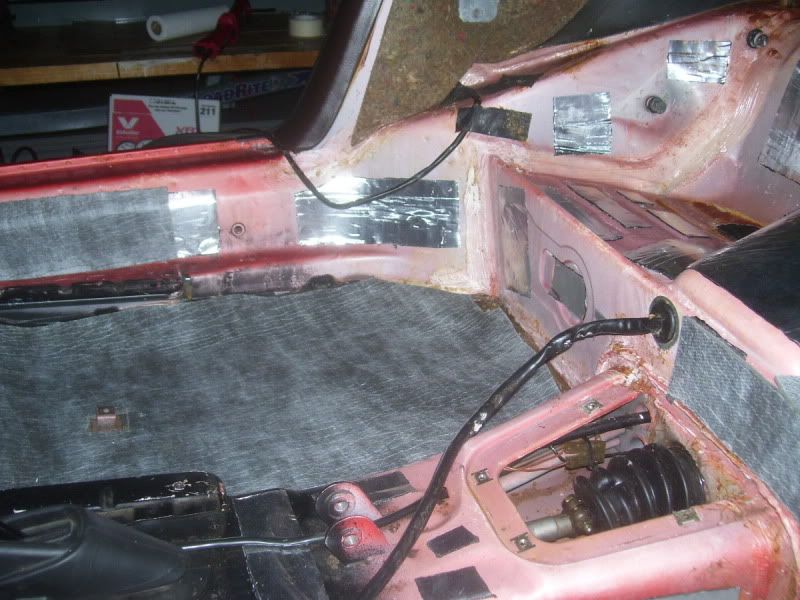

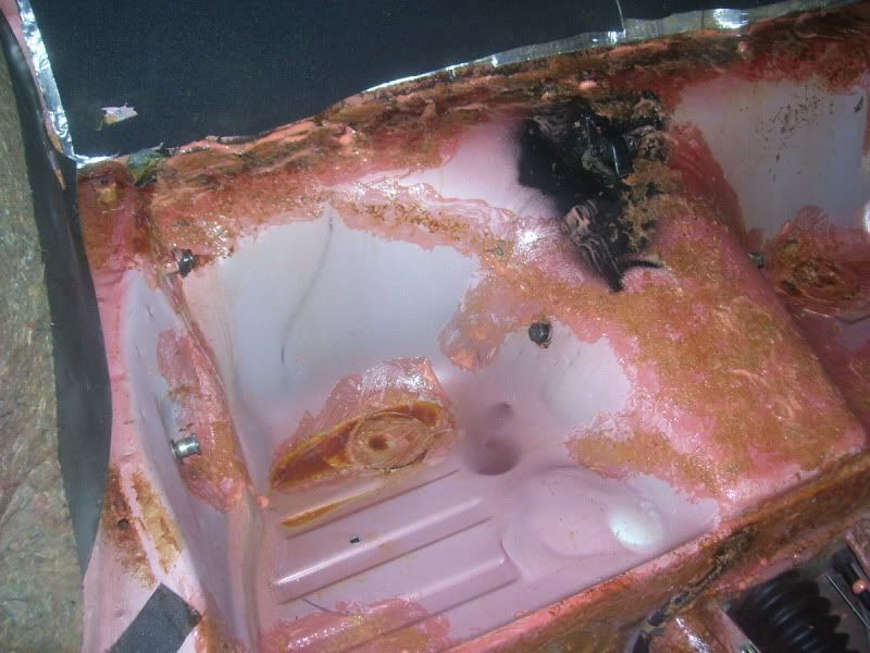

finally had some free time to start this project so here we go.....

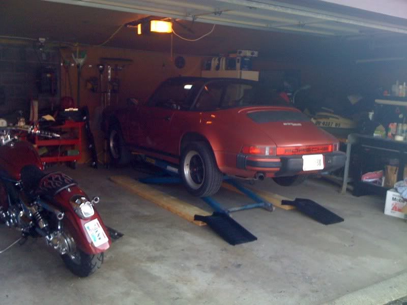

found a used scissor lift a few weeks back on cl and snatched it up quick. the brand is benwil (never heard of it) and it is a 48" 6klb lift. this thing is massively heavy and made of very thick steel, much thicker than pics of some other brands i have seen online. it works very nicely, and it is 110v, which is a godsend since i can't get a 220v line in the garage. bought some 2x10 boards, doubled em up and screwed em together. took an old pair of steel ramps that were useless due to their angle and chopped off the back and gave em a few coats of rustoleum. screwed these into the 2x10s and i have a nice cheap set of ramps to drive up. they were still a little too high for the 2x10 boards but i set it up so that as soon as i "drop down" i am in the perfect position on the boards.
went to the grocery store and bought a box of ziploc sandwich bags and used them to hold all the screws for each piece i removed. hopefully reassembly will be much easier now. removed the seats and everything else that i needed to, then took the carpet out. took out my handy dandy multi-purpose scraper and my heatgun and went to town. the old asphalt came up surprising easy and the whole job took about 3-3.5 hours to ge to this point.

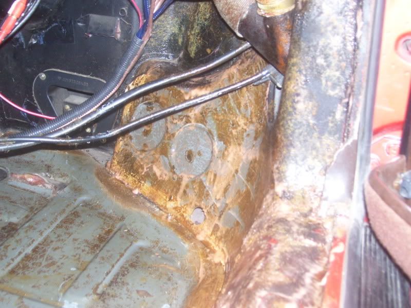

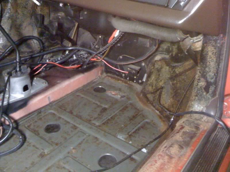

i am very happy to report that there was not a spec of rust anywhere to be found. i was also able to save about 90% of the padding on the back of the seat sound pad by slowly working it off with a gloved hand. this is all that was left on the floor.
i noticed a few things while doing this job.
at some point a window was broken because i found a lot of little glass pieces on the floor. looks like it was on the driver's side of the car.
the factory asphalt, while one solid looking piece, had different sections. most of it was a solid sheet but some of it was cut into small hexagon patterns which made it break up into tons of little pieces.
it is a good idea to keep track of where you lay your heatgun down. my right ring finger has a nasty burn on the side of the tip as i wasn't paying attention and touched the heatgun tip with it. ouch does not even begin to express the pain.

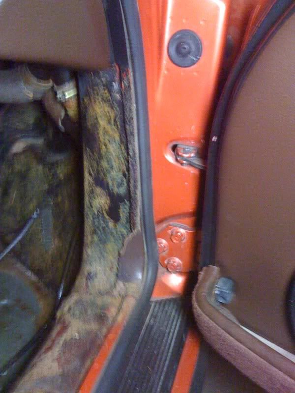

i do have 2 questions and hopefully someone can shed some light on them for me.
do i need to remove the rubber seal/weather stripping to get to the rest of the vinyl that was attached to the carpet here?
if so, how does it come off? i am assuming it just pulls off like a modern car but before i removed anything i wanted to ask. i looked over the length of it but i did not see a break anywhere to start pulling it off from.
similarly, how do i remove the trim piece on the back side of the door frame? i got the top trim piece and the rear side trim piece but that part that is on the door frame is on solid and i cannot see any screws holding it on. the green arrow is pointing at the piece i am talking about.

one other thing.... goo gone is freakin amazing for removing glue/ashpalt/crap from your hands that happens while doing this project. smells good too.

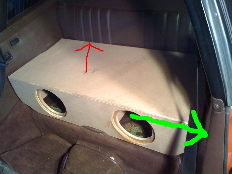

The weatherstripping just pulls out. Its glued in but it shouldn't give you much trouble. The vinyl edge of the carpet is wrapped and glued to the metal edge behind the rubber.
..and if you want any decent sound coming from your sub enclosure, you are going to want to seal the bottom of the box, making sure the entire enclosure is air tight.

thanks, i thought it was just glued in place but wanted to be sure.
no need to worry about the audio end of things, i have that covered.

so, on CL, where exactly did you find the lift? EB auto parts, garage sale, ??? find the screw and extract. you will have a much better finished product with the trim (as much as possible) taken off. it all (door rubber & other trim) goes on in a heartbeat. it it tough stuff.
Old 05-19-2010, 09:10 PM
nineball's Avatar
Join Date: Jun 2009
Location: ohio
Posts: 4,306
over the past 7 months or so i have been searching for the term "lift" on my local cl as well as the neighboring ones. you get a lot of results you don't want (lifted trucks, lift kits, wheelchair lifts, scooter lifts, etc) but when checking everyday it goes pretty fast after the first time or two.
fwiw 2/4 post lifts around here go for $1500-4000 depending on condition and capacity. i have only seen two scissor lifts like mine and the first one sold for close to $1000. i found mine about 35 mins away listed for $500 and i was out there the same day to look at it. paid the guy on the spot and gave him an extra $50 to deliver it using his flatbed trailer that had a winch on it. best money i have spent do far.

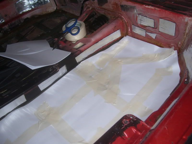

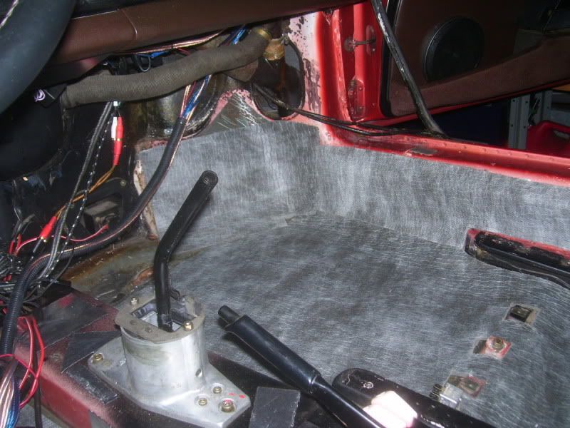

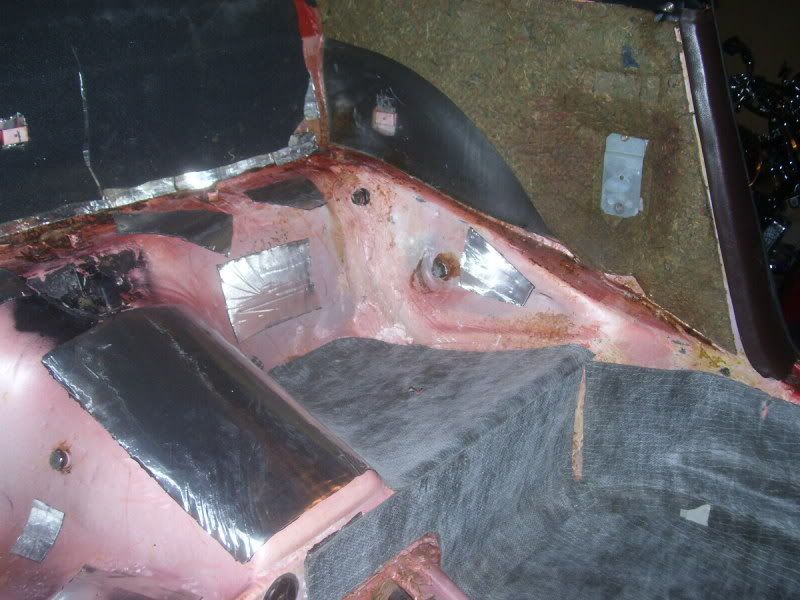

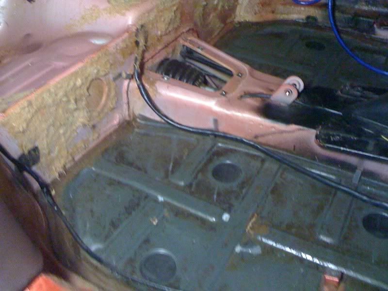

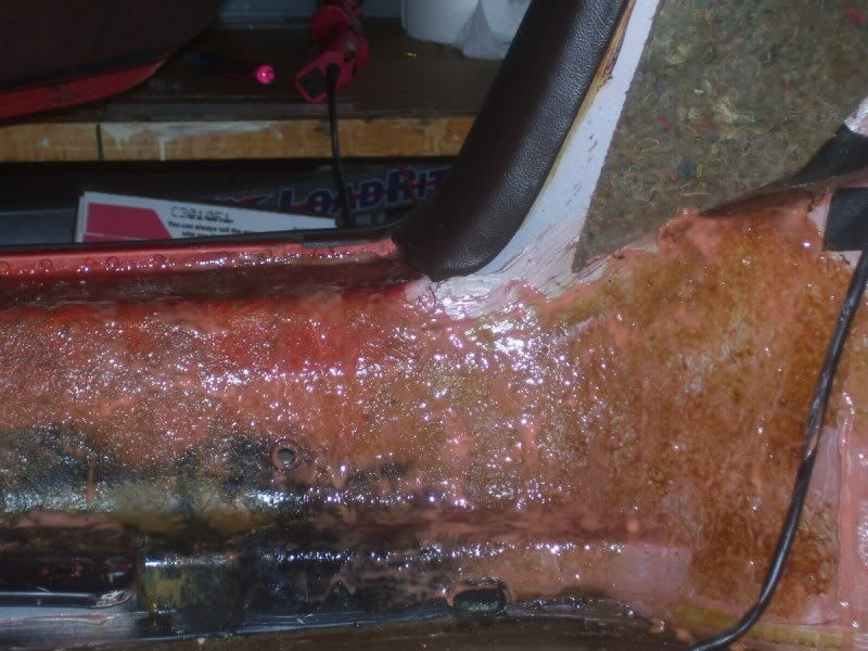

had the day off so it was right back into the garage for more.
somehow i missed the asphalt sheet on the kick panel so i had to remove those first. this stuff was the third version of this material in my car. it was much harder to get off than anything else i had before.
before
after

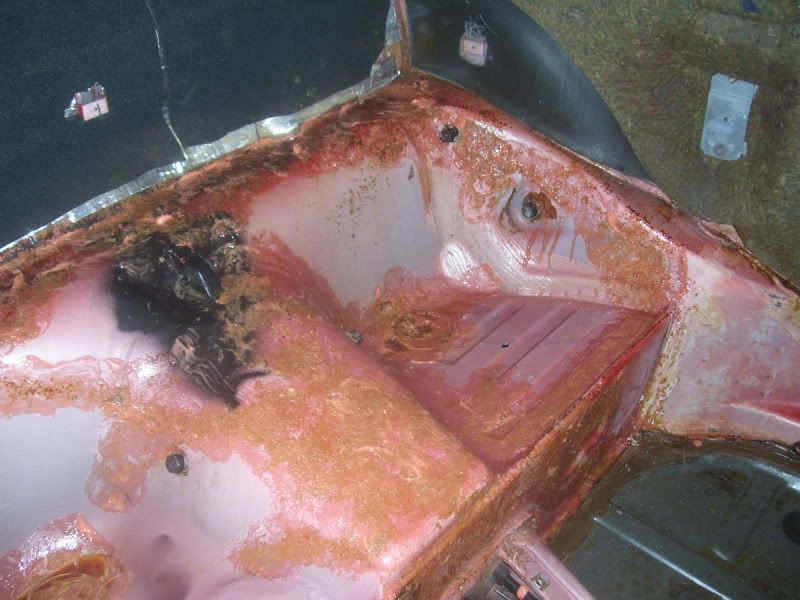

from another threads suggestions i went to home depot and picked up a bottle of this:
worked pretty damn good and smelled like an orange creamsicle! i left it on for about an hour but for future use longer would do better. poured some out into a cup and used a 2" brush to dap it on.
after an hour or so (remember leave it on longer if you use this in the future) i was able to wipe about 60-70% of everything off with just paper towels. after that i cut a plastic scraper down to about 2" wide and started scraping the remaining bit keeping my shop vac right next to it to suck up everything i was scraping up. the results:

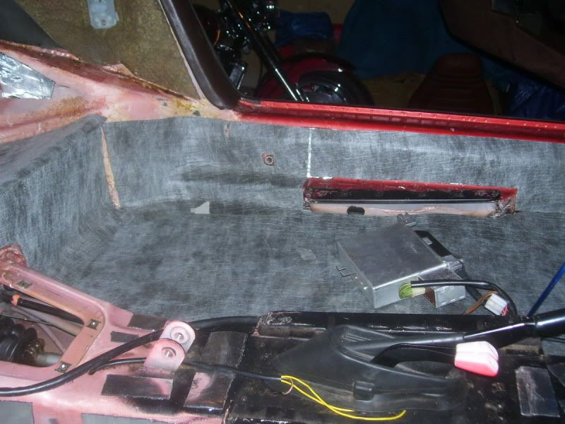

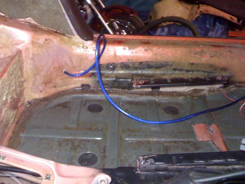

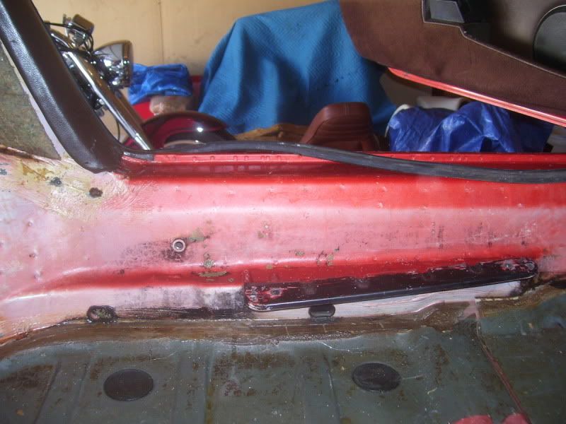

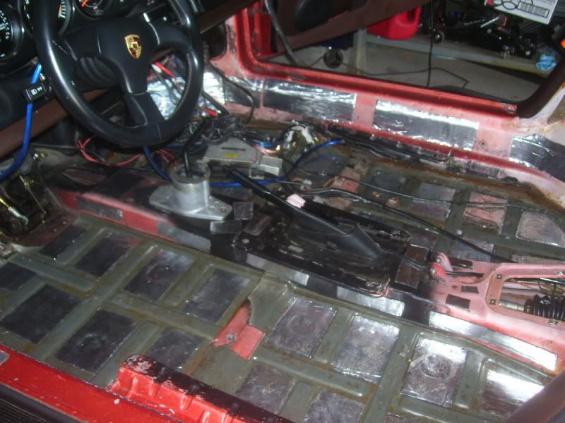

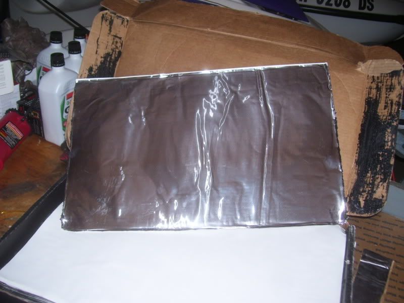

did the same thing to the left over jute on the rear seats. it took a little more to saturate everything but it worked just as good.
once that was removed i had to go back and wash down everywhere the remover was. it wasn't toxic or anything but it did leave a residue that would have prevented the next step from working. bucket of water and a rag, the shopvac to hose up the water and some elbow grease and everything was done.

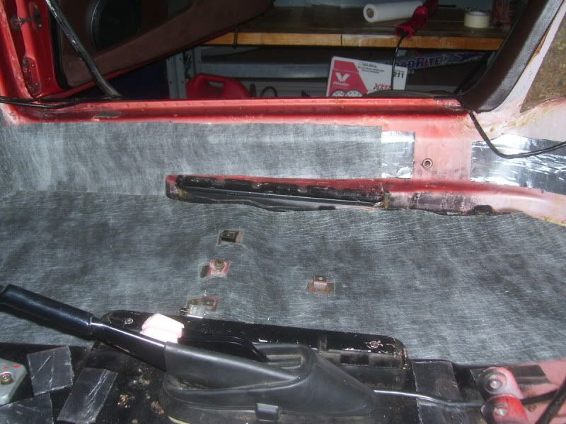

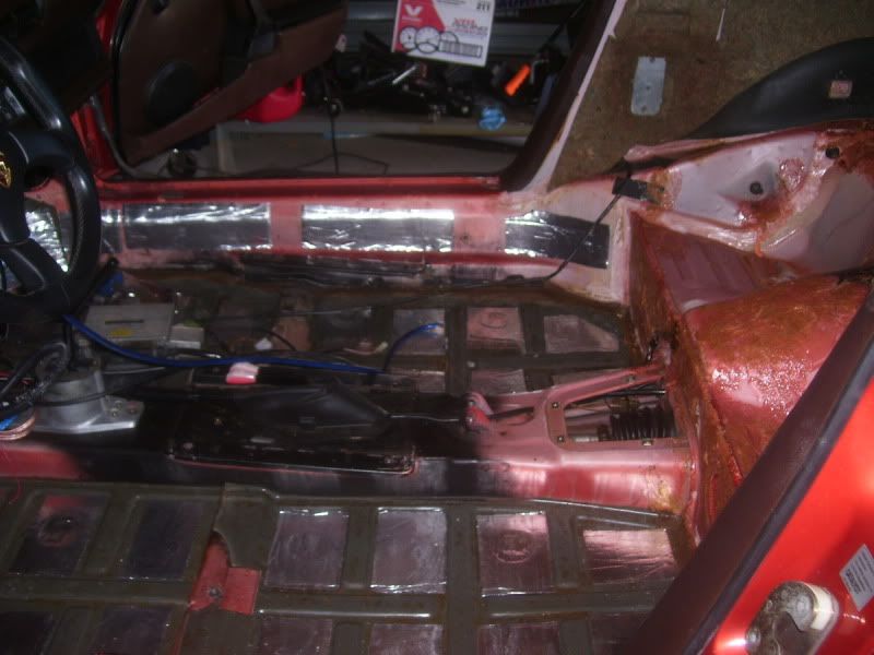

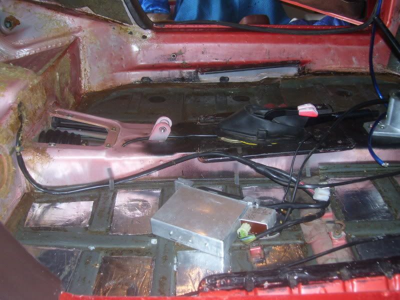

next up was to lay down the damplifier pro. i had a bulk pack (36sqft) leftover from previous installs so in it went. i probably went a little overboard but what you see below used 7.25 sheets (12.2 sq ft or about 7.26lbs total).
taking a break for a little bit now to shower and get some food. i'll be spending the night out there putting in the padding and possibly getting a start on the carpet but that may be a bit more than i want to do in the same day.

If I recall, you already did the doors and rear shelf (I followed your work closely). What were you going to lay over the Damplifier? - Maybe you mentioned it and I missed it... I did the rear shelf with Damp Pro and Luxury Liner Pro and wasn't impressed. I'll be rooting for you to quiet these beasts down.
I'm still intending to do my floors and was looking at the Super Soundproof CC foam from Aircraft Spruce. They have the thickness I'm looking for.
yes the doors and rear shelf are done with a layer of damp pro and then some open cell foam. the floor now has (see below) a layer of damp pro and some 1/4" high density rubber/vinyl commercial carpet padding. i have a friend who does commercial carpeting for a living and saw this stuff in his shop and bought some. i was going to use the llp but since i have a targa and 99% of the time i drive it the top is off going for a luxury-type quiet would be impossible. the padding has practically the same mass as llp but no where near the cost (i got a 10' by 54" piece for $10). it has a dual purpose - make the carpet feel that much nicer with padding and it will help with road noise.

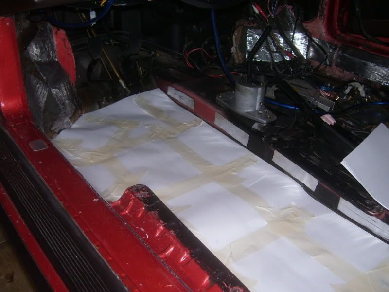

on to the last part of today. got some 1/4" high density vinyl/rubber commercial carpet padding to put between the damp pro and the carpet. used about 100 sheets of paper so far making templates for the first step. since all the pics would look the same here is an example:
once i had a template made i took it to the padding and then cut it out. i can't stress how nice it is to have a fresh razor blade, and since i grabbed a 10 pack of refills from HF i can swap them as soon as i like. i got about 80% of it done when i ran out of glue. btw, 3m 74 glue is excellent stuff. it comes in clear (like i bought) and orange.
