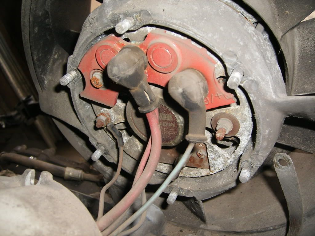

Here's a picture of the rear of the alternator when I was checking the connections, I believe that it isn;t the upgraded type.

Old 08-04-2010, 01:45 PM
Moderator
304065's Avatar
Join Date: Dec 2001
Posts: 9,569
You connected the B+ to the D+/61, no wonder the light won't go out, and the alternator's not charging the battery, either. I bet if you check the battery voltage with the engine running it's only about 12.5v.
The fat red wire from B+ should go to the starter 30 terminal, the same one the big fat black one from the battery connects to. That way current can flow to the battery and charge it.
The thin red wire goes to the rear fuse box, fuse #3.
Search here for "blue wire" for more information about how the charging circuit works. I would have tried to use the engine harness from the '69, it's a one year only thing.
Needless to say, be extremely careful working around the battery and alternator wires, you can kill yourself with the amperage or burn the car down.
Good luck!

Sorry, I'm not completley clear on that. Are you saying the way the alternator is wired in the piture is incorrect?
As I didn't touch that, it's as it was when I took the shroud off.
I checked the voltage at the battery with the eninge off and it's 12.35v. With the engine running it's 11.98v, so I'm assumung that would suggest it's not charging.
When I was looking at the picture it dawned on me this alternator is a motorola and the old one was a bosch. The regulator in the car was a bosch, so I swapped it out for the motorola one and ancilaries that I had. Didn't make any difference though. The light is on with the ignition and stays on when the engine is running.
Is it possible to check the alternator at it's wiring, as opposed to at the battery?
I wasn't able to use the 69 harness, as it went with the engine.
My B+ goes to the starter via the brass terminal bar by the fuse box (60 on the wiring diagram).
The thin red wire isn't connected, as I don't have a heated rear widow (fuse 3 on rear fuse box).
The blue wire (D+61) goes to the voltage regulator and judging by the wiring diagram, goes to illuminate the charge light in the dash.

Old 08-06-2010, 07:32 PM
Moderator
304065's Avatar
Join Date: Dec 2001
Posts: 9,569
Adam, before you do anything else, tape off that second B+ red wire and insulate it from shorting against the body sheet metal. If that touches ground you will have an 800 amp arc welder on your hands.
I don't think it's the alt connections that are wrong-- to review
Brown D-
Red B+
Blue D+/61
Black DF
It's the connections at the other end that are wrong. You need those same colors to go to the voltage regulator
DF- black-terminates at DF terminal on reg
D+/61- blue goes first to D+/61 terminal on VR and then to the bulb holder in the oil pressure gauge. Other side of bulb holder is switched +12v, probably a red/black wire.
D- ground- goes to D- terminal on VR
Your alternator is not charging. Battery voltage should be 12.5 or better, at 12.3V your battery has only 25% charge. Put the battery on the charger for THREE DAYS nonstop, monitor the charger and connections, you don't want to cause a fire.

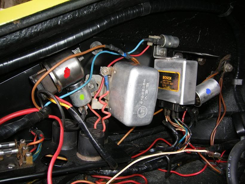

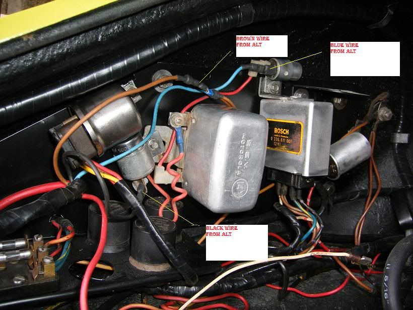

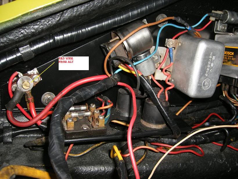

Thanks for the reply.
I've taken a couple of pictures. Excuse the wiring as I haven't tidied it until I get everything working correctly.
As a note I swapped out the Bosch regulator for the motorola regulator and capacitors.
What concerns me is in this post and in other posts I have read on this forum, is that I only have the blue wire coming from the alternator into the VR and no second blue going from the VR elsewhere. The 69 and 70-71 wiring diagrams show a second blue from the VR to the idiot light on the dash. I don't have this second wire and am having trouble understanding how the idiot light is illuminating.
Below are a couple of shots of the electrical console with the alternator wires marked.
There is no connector on the motorola VR for the brown D-. On the electrical console from the 70-71 car the engine came from the brown D- went to ground on the panel, so I have replicated this.
I have tied off and insulated the spare red wire (rear window defrost) and will ultimately connect it into the fuse box in order to tidy it.

Adam,
You actually have a fairly complete 1969 electrical console there, congratulations!
Complete with the one-year-only and no longer available "slow-acting relay," that's the black cylinder that says "nicht werfen" on the other side. Don't throw it.
OK, this problem just got simpler. In order for the charging circuit to work you MUST have a connection between the bulb holder in the dash and the D+/61 terminal on the voltage regulator that then runs over to the D+/61 on the alternator.
Search my name for "blue wire" for more info, but basically what happens is this
You turn the ignition on, current flows to bulb holder
current flows through bulb and out other terminal of bulb holder to blue wire
current flows back to VR
With the alternator not turning, no current is present on D+/61, so the bulb illuminates, telling you the alternator is not charging. The VR senses this and sends +12V through the DF (dynamo field) black wire, which energizes the field.
You start the engine, field begins to turn, inducing a current in the stator, which is rectified by the single output diode in your motorola and gets fed BACK to the VR D+/61 terminal.
With +12V coming FROM the alternator and +12V coming FROM the battery, the voltage is equal more or less on both sides of the bulb in the dash, and no more current flows
The light then goes out.
With the alternator charging, the "idiot light" does not illuminate.
So where is your blue wire circuit? Gotta get up behind the dash and find out. If it doesn't terminate in the engine compartment, it terminates somewhere! You can even rig a long jumper between the bulb holder's blue wire and the D+/61 on the VR for testing purposes if you want.
Good progress! When this is done we'll set about cleaning up the '69 electrical console so it looks right.

I had read you other posts re the blue wire and they made perfect sense to me, which is why my lack of a second blue is all the more puzzling
Ok here's what I did.
Pulled the blue wire from the idiot light (note the other terminal on the idiot light has a blue/yellow wire as per the 69 wiring diagram).
Connected a piece of wire to said blue wire and ran it to the back of the car. Set my ohm meter to 200 and tested between my extended blue and the terminal on the capacitor that the blue wire connects to. I got a reading of 82 ohms. Naturally when I test the blue wire running back to the alternator I get no continuity, as to be expected.
Now when i test between my extended blue wire (from idiot light) and ground in the engine bay I get a reading of 28 ohms. Now electrics aren't my strong point (as you may have noticed), but that suggests to me my blue wire from my idiot light is grounding somewhere.
Since writing the above I have now found the end of the blue wire in the engine bay, it was plugged into a weco connector that had a yellow wire on the other side that disappears into the loom down by the console. I'm assuming this in incorrect.
So, should I now take found blue wire and piggyback it onto the connector on the capacitor that then goes to the D+/61 on the VR and reconnect the other end at the idiot light?
What do you think?

Old 08-07-2010, 11:24 AM
Join Date: Apr 2007
Location: B.C Canada
Posts: 310
Ok piggybacked the 2 blue wires tigether and connected to the VR and voila....light goes out and I have 14.76 v at the alternator.
Now to find out what should be plugged into the yellow wire that the blue wire was mistakenly plugged into.

Old 08-07-2010, 12:36 PM
Moderator
304065's Avatar
Join Date: Dec 2001
Posts: 9,569
Adam,
When in doubt you can eliminate all the capacitors from the circuit- those are noise filters intended to meet the German VDE RF emissions tests- they are electolytics. The odds of them still working are pretty slim, 41 years is a long time. You should be able to go straight to the VR.
Anyway glad you have it working. 14.76 volts is pretty high, you really should charge your battery for a couple days. The alternator was not designed to bring the battery back from 25% charge, and it will try, but will get VERY hot and those alternators aren't known for their reliability. This is also why you shouldn't jump-start the car unless it's a genuine emergency-- it's likely to kill the alternator.
Once you charge the battery the charging voltage should settle down, if it doesn't, then look into a replacement VR-- 14.76 is just about "full-field" voltage, i.e. the voltage regulator is powering the field pretty much all the time, as opposed to periodically which would reduce the charging voltage.
When I hear about yellow wire, I think "Starter 50 terminal." But I would have to look at the 69-only diagram to be sure, and the link to the 69-only diagram seems to be down.

I'll take your suggestion about charging the battery. My charger has a light comes on when it's charged. I wonder if it continues to charge once the light comes on.
There are 2 yellow wires from the starter according to the diagram. They originate at the same pole (starter 50). One goes to the ignition switch and one goes to a terminal, splits and goes to the time limit switch and the temerature switch (start). I'm not sure what those are, but I suspect it's something to do with the MFi which is no longer on this car.

Great thanks. In fact you can see the yellow wire I was reffering to in the very first picture on that thread. It's sat right under the console below the red with white stripped wire. I shall cut the connector off, heat shrink it and tuck it way. I'll also do away with the capacitors too. As you said they're probably not working anyway.

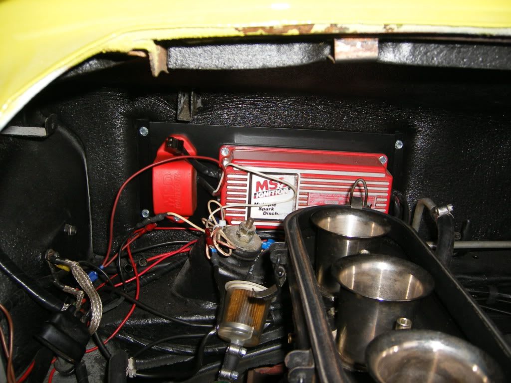

I have checked the wiring on the MSD unit and the tach adaptor. It appears to be correct and yet it still behaves the same. Won't move above 2000RPM and only seems to reflect true RPM at idle.
I read on the MSD site that there are 2 tach adaptors 8910 (white wire trigger) and 8920 (magnetic trigger).
I took my tach adaptor off and there are no markings on it whatsoever, so it;s hard to tell if I have the correct one or not. I guess maybe this is a question for MSD. I'll see what they say.

Have my tach converted, buy another and have it converted or buy a post 71 tach?
I'm unable to read what's on some of the cans on the console. I've colour coded them below and I believe you to be talking of the "blue" one, but I want to be sure, as I can't rely on the colour of some of the wiring, as I've come across a few anomolys.
