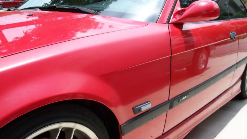

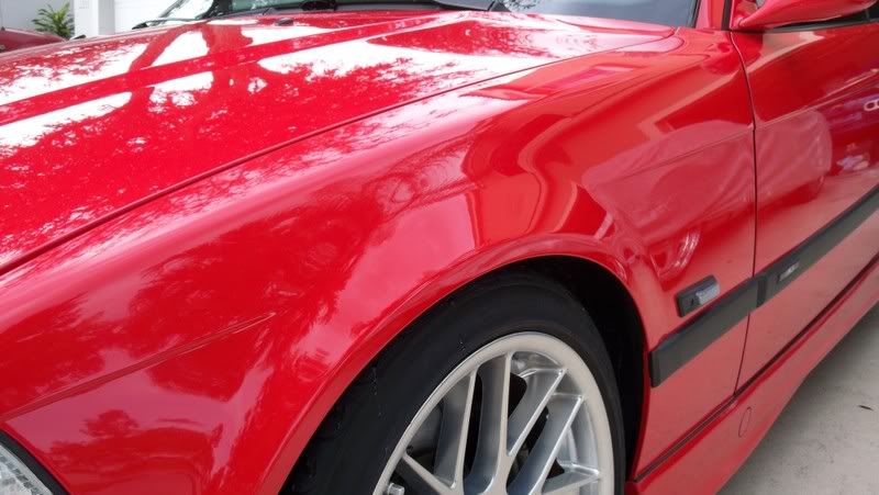

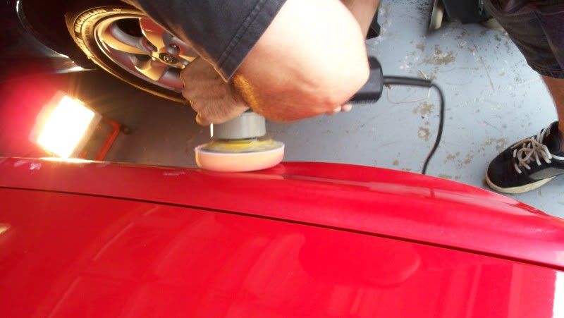

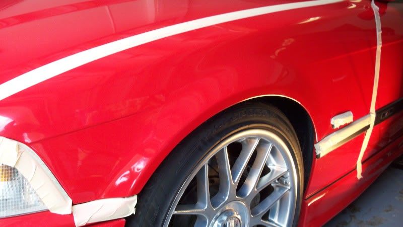

If that don't work you may have to get into the Porter Cable territory with foam pads
If your paint looks like this then for sure Porter Cable will be needed
