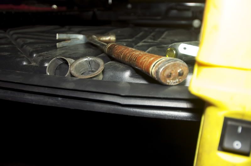

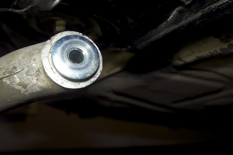

Removing the trailing arm bushings.
As Will mentioned there is a hole in the arm under the bushings. This is where you want to cut because it reduces the risk of going too deep and cutting into the arm.
Jumping ahead so you can see the hole. This is after the bushing was removed.
I used a dremel type tool but because of the size I could not cut a straight line But had to cut a curve over the hole. Cut slowly and carefully. You really don't want to get so deep that you hit the aluminum of the arm underneath.
Then place a screwdriver or punch on the inner lip and give it a few taps. And out it comes. Just like that.

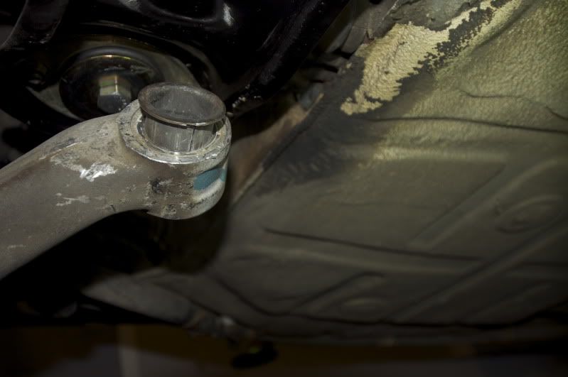

Join Date: Dec 2004
Location: Pittsburgh
Posts: 2,415
Rear suspension parts back from the East Liberty Electroplating.
So the next big question is, do I lube or glue the Neatrix bushings?

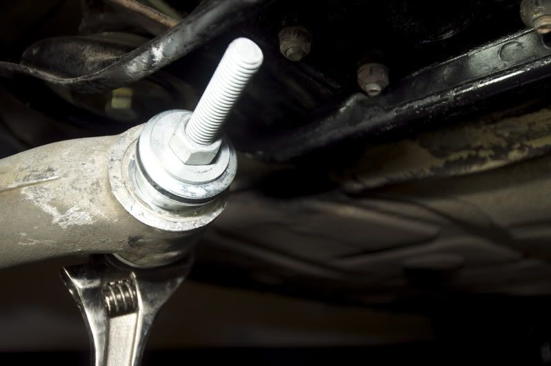

Old 10-19-2011, 03:30 PM
redridge's Avatar
Posts: 844
ER rubber bushings use glue....
as for the trail arm... I used a hack saw just to relieve the pressure, then pry right off.
use bolts to squeeze in the new bushings...
