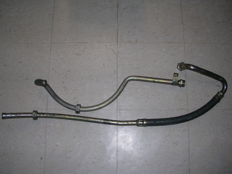

I'm getting ready to install a set of SSI heat exchangers on my otherwise unmodified '79 911SC, and I want to know what gaskets and oil lines to use. I've read a few threads about people using various types of gaskets, and from what I can tell the consensus has been to use the 1974 and earlier original style gaskets. Is that right? Also, to complete the build off nicely, I am looking for a sport muffler, any thoughts on which one to get?

gbman,
You would need these oil lines for your SSI conversion. Plus the muffler of your choice.
Tony

There is a ton of muffler choices, mostly depends on how much you want to spend. It goes from a few hundred to 1500! My choice would be the M&K or the Dansk sport, 2-in-1 out for the most noise reduction. Flowmax and other "car" mufflers require a 3rd party to weld something up but the sound is great and there cheap. See the thread for sound bites of peoples exhaust. Oil hoses are available from our host and so are the gaskets. Just get the ones that fit your car and the other end that fits the muffler

How bout if I start the list...
- crossover hard line
- oil tank rubber line
- barrel nut removal tool
- header washers (6)
- barrel nuts (6 to replace old ones)
- 13mm nuts (6)
- muffler gaskets (2) because mufflers do not come with them
- 13mm nut removal tool (optional)

I sourced some copper exhaust nuts from a local P-car mechanic's shop, but they were 12mm (standard for most European cars I think) versus the factory 13mm nuts. I may have this back-wards, but I just checked my SSI tool and it's a 12mm.
On the oil lines, I also used propane heat and aerokroil and a few light hammer taps on the line wrench to break them loose. Clean the t-stat threads before installation. Make sure you get the inside T-stat line really nice and tight before installing the outside line. I had a slight leak at the t-stat housing upon the start up check, and it's a PITA to access once the outside line is installed! Soak everything you want to remove (nuts, oil lines, etc..) with your favorite penetrant overnight before you start the job.
If you order parts, I'd pick up a few exhaust studs for that "just in case" scenario and to possibly save on another shipping cost (plus they don't cost much). You might have a few studs that are just too deteriorated to reuse as well. I even considered trying to replace all of them, but that's foolish if they're still serviceable - given the time/effort involved (you'll see). I'd certainly do a pre-inspection of the HE's/exhaust to make a preliminary assessment. I also broke my 02 sensor plug in the engine compartment (forgot to unplug it), but you don't have to worry about that on the older SC's.
