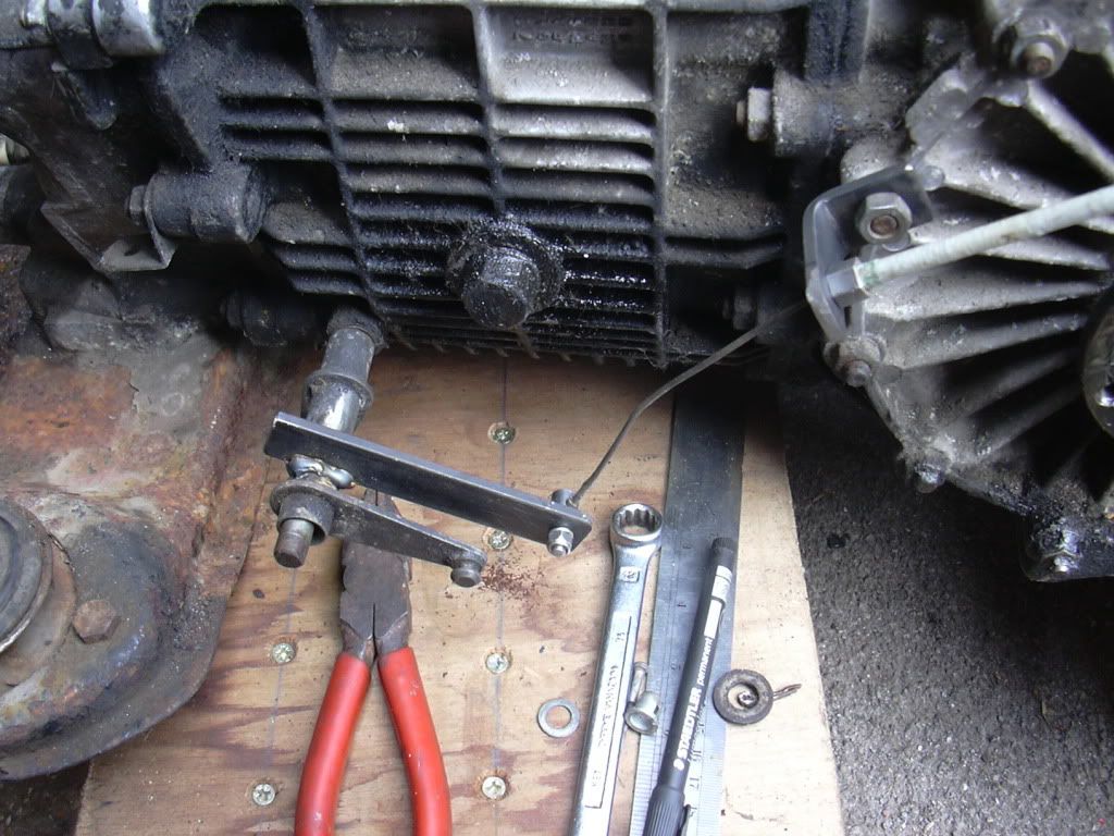

The engine is very smooth, sounds spot on, but I get a lot of shunting from the transmission on light throttle loads.
It clears of you go up or down a gear, clears if you plant the throttle, but you cant just trickle along at under 2k rpm as the car get really jerky, shunting back and forth, I guess here in the UK we'd call it Kangeroo'ing.
I've got the Patrick Mo'sports flywheel and an aluminium Sachs clutch, is this lightened assembly part of the cause? Would a MDE remap sort this out?

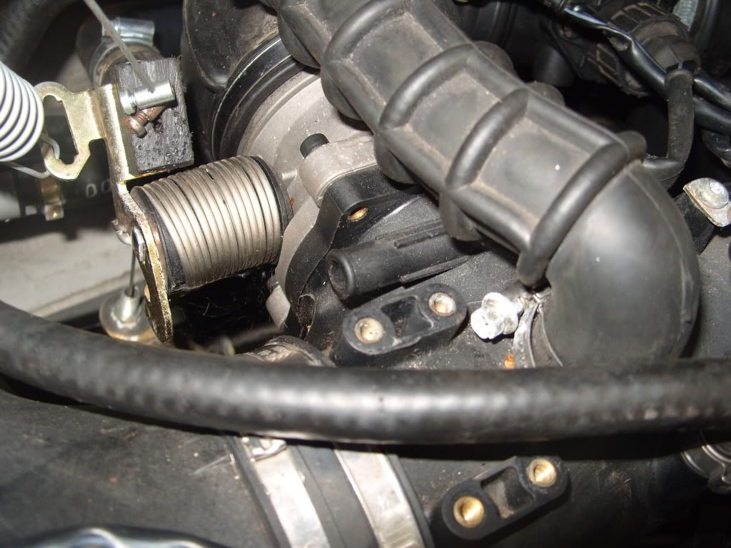

The throttle does not fully close, the only spring in from the pedal to the throttle body is the one on the throttle body itself, I had a helper spring but it was hooked onto the throttle lever on the body one end and the car body on the other, I suspected engine movement might be causing the jerkyness, but I removed the extra spring and its still there.
Its almost as if I need to add some damping to the throttle, but of course I need it to snap shut quick when I left off.
I added and inch to the throttle linkage bell crank on the transmission and made up a cable.
First pic, top left shows the helper spring that I have now removed.
Second pic shows the bell crank mod I did.
Any advice?

Thats somewhat typical for these conversions due to the light flywheel.
Remapping the DME will help, but not eliminate the issue.

Thanks, I wondered about that. I'd try to add some damping to the cable but I dont see how to do that without making the throttle slow to shut which wouldnt be any good.

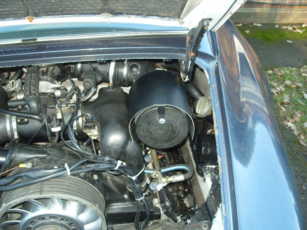

I had a break down, car had been out in the rain all day, I think the aftermarket airfilter got soaking wet. Chronic misfire to the point I came to a stop with it popping and banging but not enough power to drive.
On the motorway. In the dark. Pouring rain. Rush hour. Joy.
AA brought me home.
I found quite a big fuel leak from the top of number 1 injector, so fitted a new o ring.
Made a rain cover for the air filter.
Now runs perfectly, the chronic low speed shunting has gone, can now trickle along at just over idle no bother.
And its mucho rapido!
A successful 993 motor in a SC conversion completed.
Running a 95 993 motor in an SC....
