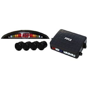

So I slapped one of these on the car:
And I lowered the car so now the bottom edge of the front bumper is just shy of 4" off the floor. A friend of mine did the same with his 1st gen RX-7 and promptly hit a curb in the 1st week cracking it in half or so. I would like to avoid said embarrassing act!!
So I thought about curb feelers...
Amazon.com: Superior 26-6441 Adjust-O-Matic Curb Feeler, 10" Long: Automotive
But my friends laughed at me and called me ghetto
So I ordered this instead:
Amazon.com: SOUND AROUND/PYLE INDUSTRIES PLPSE4 Reverse Parking Curb Sensor System: Electronics
~$35 all in. I'll give it a shot and see if I can mount it on the bumper in such a way as to detect parking berms and curbs. I opened the box and it seems to be of reasonable quality. I can mount the box in the front boot, out of the way and virtually unseen. It has a visual and audible notification. Not sure if or where I will mount the visual part. Certainly not on the dash as recommended in the installation manual! I may mount it at the top of the a pilar at the roof line. We'll see.
I may yet return to the curb feelers and mount them under the front bumper sticking forward. They would be pretty hidden at that point. Maybe paint them black.
How have you guys/gals solved this possible issue outside of just being extra careful?

I think the key is proper placement of the sensors. Have you tried to find data sheets on the sensors they are using? You could certainly mount two on either side of the cooler opening and two sort of facing out to sense curbs. You will need to find the best hight from the ground to mount them so they can actually "see" the curb and not false on the ground. I would suggest making a test rig out of wood that you can adjust up and down to find the best mount points. You could even take it to work and test it against the parking stops and curbs around town.
I still think my original idea (discussed in one of my emails) of using a backup camera would be best. You could mount it just under the bumper part facing down at an angle giving you a slight forward view and still keep the lower part of the spoiler in view. You could creep right up to the stop. The camera would be hidden.
