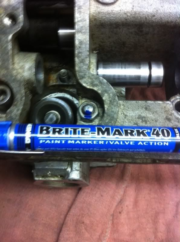

I just installed new CV joints/bolts and would like to mark the bolt-heads to determine their status. Do you use one of those paint-marker pens that engine builders use or is there something different available

Found these today at Fastenal for $4.50...works great.

DYKEM Brand paint marker works great for me. That was the blue one in the photo above.
