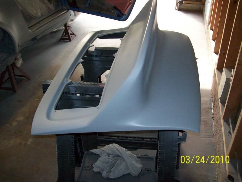

The one I have came from Rennspeed. It was purchased from a fellow Pelican who never installed it on his car for $200 as I recall.
These are usually less expensive than the Getty/MA Shaw ones but it fit very well right out of the box and needed very little final finishing work. However, after running it for a few years it developed a crack in the fiberglass at the lower rear edge. It was an easy30 minute repair when I repainted the car last year and is holding up fine.
Here's a pic in primer after the minor repair.
I believe Jack Olsen's Black Beauty also runs a Rennspeed ducktail. The Getty and Shaw ones are probably better but the Rennspeed ones are great "bang for the buck" if you are on a budget. It has the correct side profile, unlike some of the el cheapo ones on the market.
The Stratton ducktail that uses a OEM steel frame is the way to go if you have the funds. Last time I checked they were around $800+ shipping.
