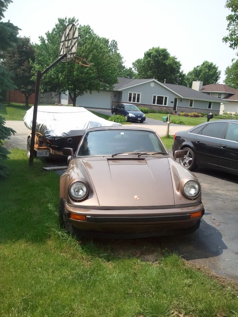

1. The paint is a bit rough but the car has no rust underneath or inside, there is paint bubbling in certain spots, missing clearcoat spots by the fenders etc, because of this I want to repaint the whole car. The question is should I repaint it the original brown color or any other color I desire (guards red?) will repainting a different color kill the cars value?

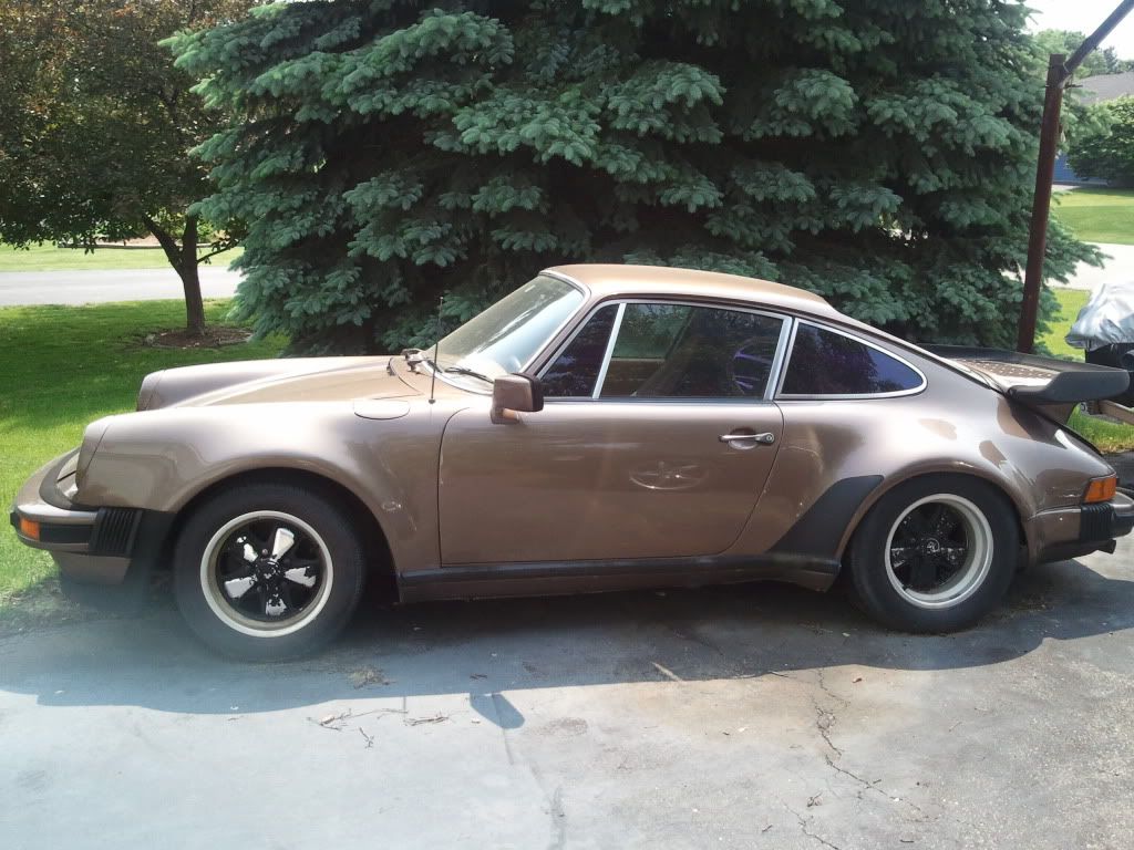

2. This car seems to have been converted to a wide body, he says it was originally imported from germany.... Is there a way to see the original factory specs for this model by the vin number (its a short vin and the decoder doesnt show anything).

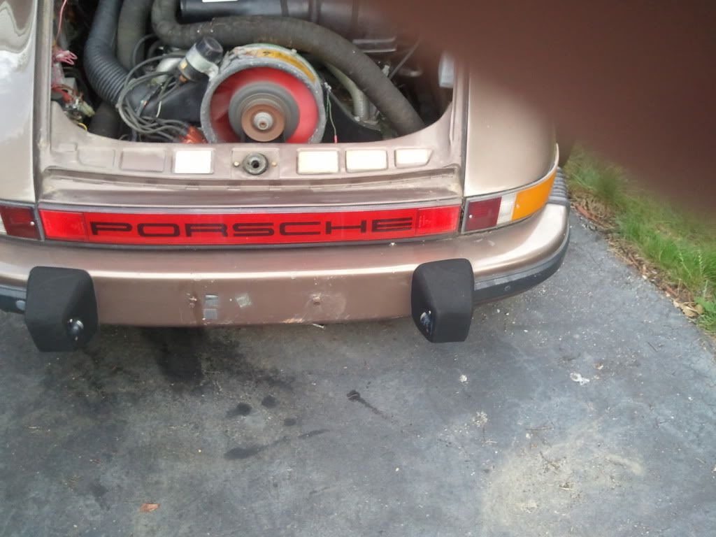

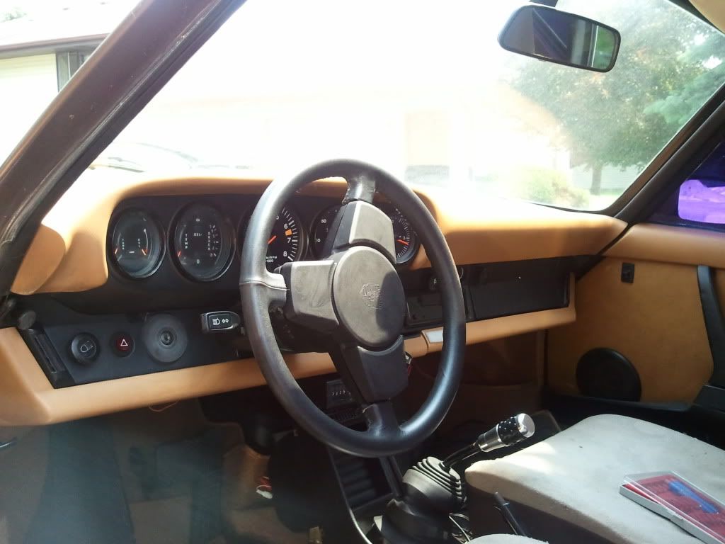

Here are some pictures for reference the day I picked it up any help or info would be greatly appreciated!

Welcome. That is the same shift knob I have. Was on sale at Pep Boys for $2.00 or something like that awhile back. The Sportomatic is rare, but not sure about desirable (I wouldn't want one, because it would be a nightmare to fix if it broke because parts and people who have experience working on them are rare). The car has the turbo flared fenders (which could be fiberglass aftermarket or steel factory parts) and the orange Euro rear lights. I think long hoses on the engine indicate it may have had an engine swap (I don't think that electric blower fan and those hoses were added until later). Non-sunroof is rare and a little lighter/stiff than sunroof car.

opinions: The bubbles might not be good news. I'd say any color you wanted (to match interior unless you change that too). You should change the oil too - read up on how to do that here. Add ignition lines, rotor, cap, air filter to you list. Check the condition of your tires. The suspension is going to need some attention, she looks a little low in the rear. Good luck, and keep us informed.

previous owner said he replaced the ignition lines, rotor and cap , and the intake is a k&n... he also said he paid almost 2k to have the vaccum clutch (something like that) replaced.
Those duct hoses are not supposed to be there?

Most of the time, bubbling paint is "the tip of the iceberg" when it comes to rust. Before even thinking about paint, you need to start probing the areas that are bubbling to see how deep and wide the rust goes. You have to get ALL of it or else, like cancer, it will simply come back and ruin your new paint. And the fact that the car was in Hawaii, in the humid climate, is a red flag. You should start by removing the paint in the bubbling areas to see what's going on, and then using an ice pick or awl to poke around and see how deep the rust problems go. You should also look in some of the areas that are known to be rust problems -- behind the rocker panel covers, the jack receiver, the suspension pan, etc. etc. If you search for the terms "rust" or "rust repair" you'll find lots of threads on this. There's also the paint and body forum, where experts can help you.

I'd lose the "Turbo" badge. It does have a turbo T-tray spoiler. Clean and repaint the black centers of the wheels and that will freshen it up a lot. If this is to be a daily driver, I think you will be ok. Just go over the various systems to be sure your are safe. It is a mid-year and with the sporto not the most desireable. Around here, the rub is that they are all $20k cars. Either you pay $20k and get a decent rust free example, or you spend at least that much getting there. You have to pick your level of pain. I think the car looks fairly good and you might be able to match the paint in spray cans and fix the little areas for a more presentable look at a minimal expense.
Those look correct to me. My '76 had them also.

I have a 76 with the paint bubbling up. This was the first year in the US that galvanized body panels were used throughout. I don't know about the Euro models. Someone here does. Anyway, the paint is peeling off the galvanized panels with bright clean metal underneath, apparently a feature of the 1976 galvanizing before Porsche painters figured out how to paint zinc. You may be in the same boat: no rust, just paint peeling off the zinc. A quick fingernail will tell you.

My bad. I was thinking they were added in '78.
