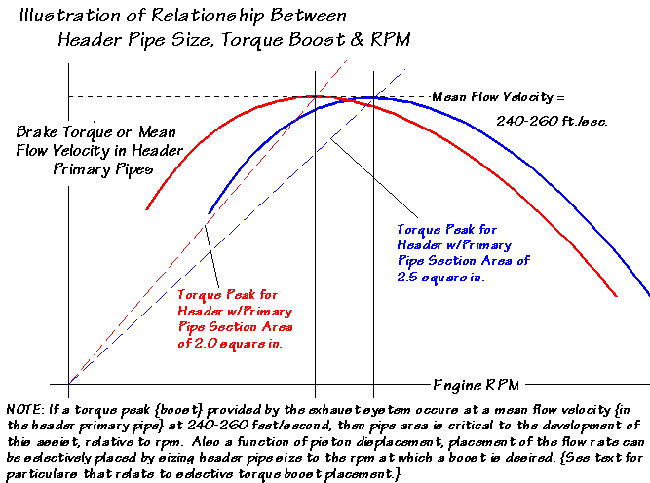

Originally Posted by r_towle View Post
torque is going to be created by the backpressure of your friends stock exhaust.
Rich
nonsense, engines are tuned for a particular set of circumstances, changing the circumstances will require alternate tuning is all.
The best exhaust as long as an engine is tuned for it is an open free flowing exhaust.
The design of the exhaust dies influence the rpm where best torque is obtained, larger diameter pipes will generally have best torque at a higher rpm than smaller diameter pipes
here is an example of what is typically going on
this assumes of course that the system is in the ball park of being correctly sized
as to the original ?, the geometry of the transition is as important as the change in sizes
you want to avoid steps w/ the exception that an extended in let is good, do use transition pieces where possible
Extended inlet & transition piece on the out let
