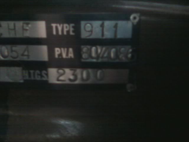

Need help identifying this number
I have a data plate in the front boot of my RoW '80 SC that is not covered in any of the books I have on the 911. Most the numbers appear to be regarding weight, but I was curious as to what the P.V.A 80/4086 was. Does anybody recognize what this is? Import tag? Original country of origin? Thanks in advance.

Something to do with entry into Belgium.
PVA = Procès Verbal d'Agrégation
My-Mc Discussion Forum: Earlier Honda Pan 1100: What would you say is PVA?
Article 10. Procès-verbal d'agréation
I think I am getting close to finding the code converter.

Excerpt:
What about the certificate of conformity?
Most cars offered by Liberty Oldtimers come from the USA. Many of these have never been sold new in Europe and have no European certificate of conformity. In order to register these cars in Belgium on "O-plates" this is no problem, since this kind of registration does not require a certificate of conformity. If you desire to register the car in Belgium on regular plates and use it on a daily basis then Liberty Oldtimers can arrange an application for a Belgian certificate of conformity, the so-called PVA or "Procès Verbal d'Agréation". This is a complex administrative procedure which Liberty Oldtimers perfectly masters.
From this website
Liberty Oldtimers -- De beste Cadillacs en Lincolns voor de kieskeurige verzamelaar
I think the converter is in here if it exists
Home - GOCA
