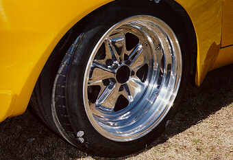

I'm putting together a set of custom-made 17-inch Fuchs (in 8.5- and 10-inch widths), and I've got a choice. The safe way to go is with three-piece wheels with 20 (or more) bolts holding the sections together. Mike Marshall has a set of these, and they look great and (so far) have held up well.
A less ideal option is to have two-piece welded wheels made with the same Fuchs centers. It's a direction I'm considering because I can't get 3-piece wheels made in time for the Open Track Challenge next month. The two piece wheels are made by heating an outer rim up so that it expands enough to slip a Fuchs center in, and then letting it cool and welding the center in place. Lindsey Racing has been using a set on a track car that's heavier than mine without incident for five years.
Here's what they look like:
I know nothing's quite as good as a one-piece Fuchs wheel, but I'm interested in other guys' thoughts about this 17-inch version.

"I can't get 3-piece wheels made in time for the Open Track Challenge next month."
I think your own statement gives you the best way to go.
I am sure that both wheels are very good. I would think that down the line any damage to a three piece wheel could be more easily repaired.
It also looks like the "weld-in" version will require you to chrome the wheel for a shinny finish. You know as well as anyone that the forging will weaken the center portion of the wheels, and will eventually peel off the surface (at least the centerportion.)

Those look chromed in the picture, but they're polished. On mine, the insets will be painted black, and the spokes and rims will be polished.

From a strength and repairability perspective, I like the three piece solution.
Two piece might be just fine, but I wonder what happens to the center when it is welded. Does it get harder and more brittle? And do they heat treat these to anneal? May not be necessary, just questions I'd be asking.
I've seen Marshall's wheels and from an appearance perspective - they KICK ASS. They keep the classic look but update it very nicely with 17 inch. I think the bolt circle helps to visually fill out the space to the rim.
If your taking a vote, put me down for 3 piece.

I saw a three piece recently that cracked in the rim right below where the fuchs center bolted to it. The fuchs center was fine though. But I think this only makes a good argument for the quality of the fuchs forge and a bad one for the rim manufacturer.

Is the welded wheel really much weaker than the bolted wheels? The welded wheel has heat weakening of the rim, the bolted wheel has localized stress concentrations around each bolt. Neither is going to be as strong as an original Fuchs, but both seem to work. maybe you could get a welded wheel heat-treated to bring it back?
