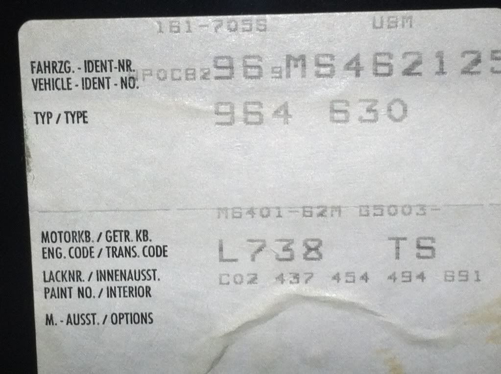

I've decoded the VIN, as well as CO2 437 454 494 691, and have came up with
VIN:
Options Code:
Code Option Description
437 Comfort seat left
454 Automatic speed control
494 2 speakers on back shelf
494 Amplifier system
691 CD-Player "CD-1" with Radio
C02 Equipped with catalytic converter
But, I still don't have what I'm after. I'm looking for the number that represents the paint code, and if possible, the interior code. There is my options sticker. Any help is appreciated.

I would think it is paint L738 (possibly Black Pearl) and trim of LS??

L738 exterior with TS interior from memory I think that was Black metallic with Linen interior but I'm not 100% sure.

Well that car is metallic black, or pearl black, which ever it's called. I just wanted to know if there is any other information I'm missing I can learn from this sticker.

The following is from Adrian Streather's 993 book but I suspect it applies to the 964.
630 is the code for cabriolet, also noted in the VIN, 4th position. The book notes TS as a calculated code based on all the interior color codes.
M6401 is engine type.
62M is engine code - 3rd character should match the 10th character of the VIN.
G5003 is transmission code.
