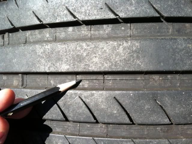

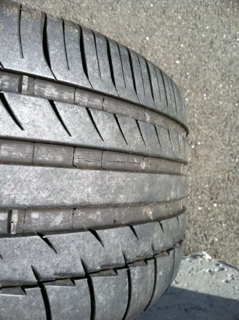

Are my tires splitting?
Today, I removed my Winter tires and reinstalled my Summer tires. When I was putting the fronts on, I spotted what appears to be the start of a split around the circumference of the tire. I'm not absolutely sure, because in the grooves of the tire, there also appear to be three lines of molding flash from when the tires were made. What looks like a split is right along these lines.
They are Michelin Pilots with less than 15k miles on them.
What do you think?

yep startin to dry out. how old are they?

How old are they? Were they stored in bags in a warm place? Could just be the pictures/lighting but the rubber looks hard/old to me.

Looks like they've seen some track time? The extra heat cycles from that can do that to deep tread street rubber.

About 5 years old, no track time, not stored in bags in a warm place.

They are definitely dried out ... it's a shame because they still have a lot of tread left !

Check the date code on the sidewalls. They might be older than you think.

It's called Dry Rot...

Had the same on a pair of pirreli's on the front of my 3.2, except they had gone on the sidewall where it meets the tread, quite bad, when i checked the dates they were from 1997, so well past their best, needless to say i changed them and the car drove a lot better due to the rubber on the new ones being a lot softer than those that had obviously dried out and gone hard.
Good job you spotted it.

Date code is 0806, which should be Feb 2006.

Michelins, while good tires, seem to dry out faster than most that i've seen. My wife's car had Michelin MXXM4 tires on it from new and when they were done, they were DONE. The cracking on them was quite bad.
The rubber on yours doesn't look too bad. But the lines you see can be from lateral stressing. Here's a picture of a Hankook R compound (old Z211 competition tire) that overheated due to lack of shaving & camber.

over 5 years old, so they're hard and done. hard means less traction, more likely to skid.

If you store your tires in a clean, cool dark location away from heat and gas and under a cover, they are still going to be too hard after 6 years.
Even if you stored them in a pure nitrogen atmosphere. Rubber contains sulfide bonds which will continue to cross-link (self-vulcanize) over time.
See what the Michelin man will do, but expect to grind them up into floor mats.
