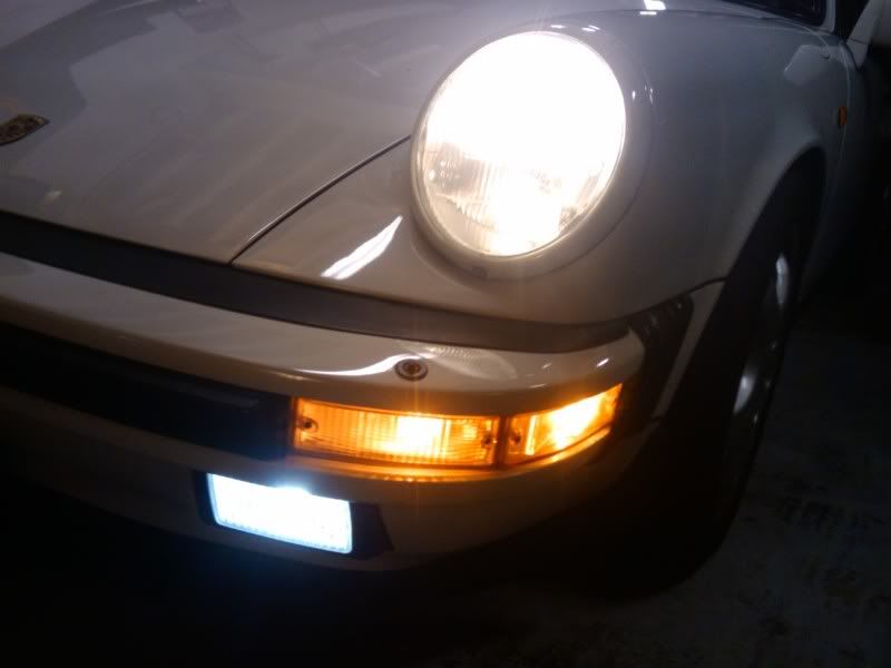

Well, When I was fuchen around, I placed LEDs in my 3.2 OEM fog lights that I set up as my DRL's. it looked pretty cool updated but did nothing for night driving. So I swapped back to 35 watt motor cycle halogens H3's , the OEM 55watt is just too hot and tend to melt the plastic Bosch housing.
http://img.photobucket.com/albums/v5...310_193911.jpg
LED fogs
80-911SC 04-13-2012 11:59 PM
that one we will let slide DRACO ... that's just a bulb swap ... i don't even mind the blue light (even though it may not help) .. I was commenting on the led around the bottom ... just looks fuched up ... plus your trying to save the housing he was trying to"update" for the look ....
