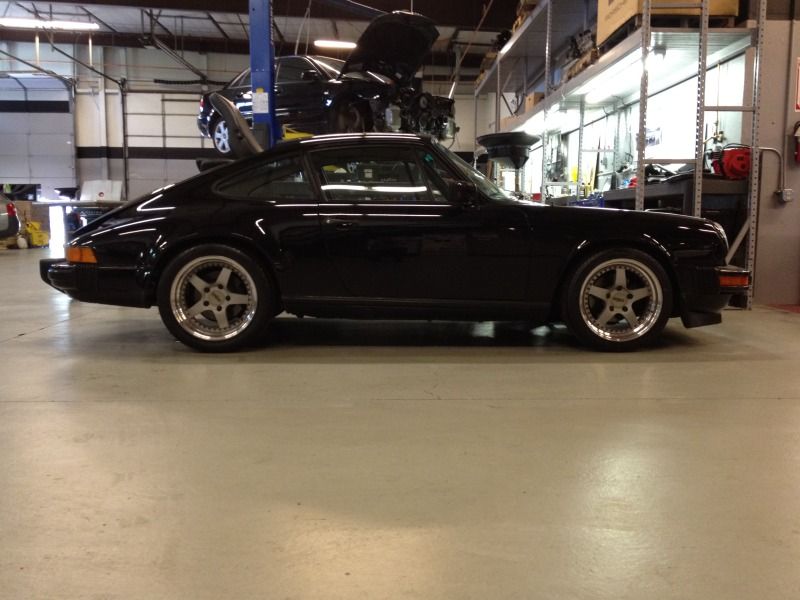

cdill 05-11-2012 08:09 AM
http://i3.photobucket.com/albums/y94...36swap2002.jpg
Engine installed, but I am waiting on one oil line before we can start it up maybe Monday or Tuesday next week.
In the mean time it finally has a normal stance again!
http://i3.photobucket.com/albums/y94...911/36swap.jpg

So almost all is well, I finally got the new oil line in and the car ready to start today, but there has been a slight problem with the wiring harness I got from Patrick Motorsports. I called Patrick but they haven't been able to help other than tell me to check the wiring (NO *****!) anyway there are two plugs on the engine harness one is a 10 pin plug the other is a
14 pin plug. the 10 pin plug goes to the engine harness for the dme.
the 14 pin plug goes to the 83 harness that was already there. when I pull the
14 pin plug the fuel pump stops running. I searched and read that I might have to move
pins in the 14 pin plug so everything will talk correctly however I have not
been able to find EXACT info on what pins to move. The fuel pump always runs as soon as I connect the battery. the only time it I can get it to stop is if I unplug the 14 pin plug at the motor. Even if i pull the fuse and wires from the fuse panel. ???????????????
Has anyone else done this swap and run into this issue? If so do you remember which pins to move?
THANKS!!!

Thank you!!! We finally got everything sorted with the wiring and I was able to drive it around the block today before it started to rain. Back into the shop to button up a couple of items and do a final check.
