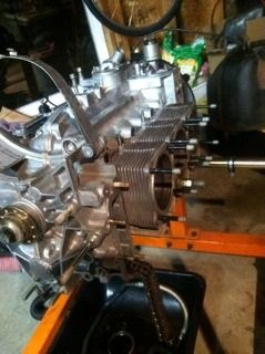

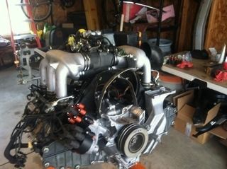

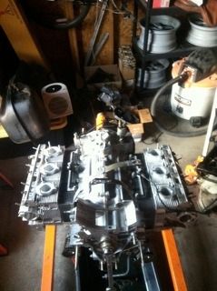

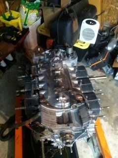

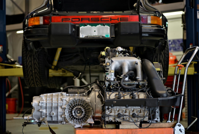

It’s been some time since I have been active on Pelican and in the Porsche community since the sale of my beloved 993 this time last year. The 993’s sale did make room for a more family friendly vehicle for my new daughter and help fund some home upgrades. This did however create the problem of our garage being an awfully boring place to visit!
After owning an 83 SC with a 3.6 swap built by a previous owner prior to my 993 I decided that this was the car I’ve missed owning more than any car previous and It was something that I had to have back!

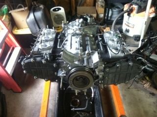

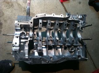

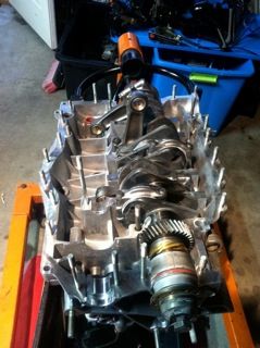

Over the winter I have been gathering parts so that when the “right” car came my way it would be a pretty easy task to get another SC or Carrera with a 3.6. I was able to source a 3.6 from a totaled 1990 cab that came in to a friend’s body shop. I have been gathering parts from Pelican, local vendors, and the custom 3.6 bits from Patrick Motorsports.
I have also been very fortunate to have a local Porsche tuning shop help with the build of the motor and share in the excitement of putting another 3.6 in a 80’s 911. The guys over at 3zero3 motorsports have done a great job getting the motor freshened up and ready for its new home!
Luckily I was also able to find and purchase a 1983 SC sunroof coupe at a local auction where a friend of mine works as my motor was nearing completion.
The SC will be on its way over to 3zero3 Motorsports tomorrow afternoon for my 3.6 to meet its new home. I will do my best to document the process for those interested and if you are in the Denver area and would like to drop by to check it out Max has said that anyone is welcome to and take a look at this or any of the other projects they have going on.
Here are some of the pictures of what has been done to the motor so far

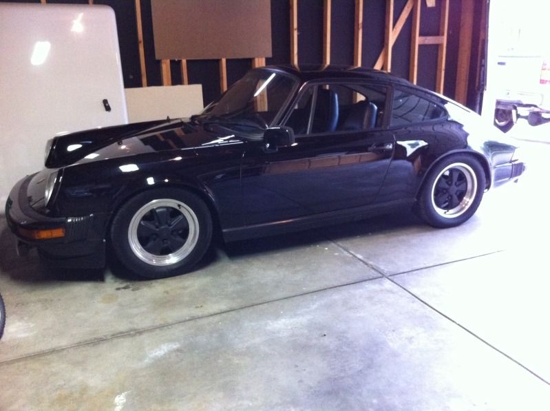

Of course here is the car

Sub'ed. Looking good. These old cars with a 3.6 are really obnoxious-I love it!! Any mods to the 3.6 internals?

Oh no! Another one eludes pleco!
That car is going to be a blast. Keep the thread updated.

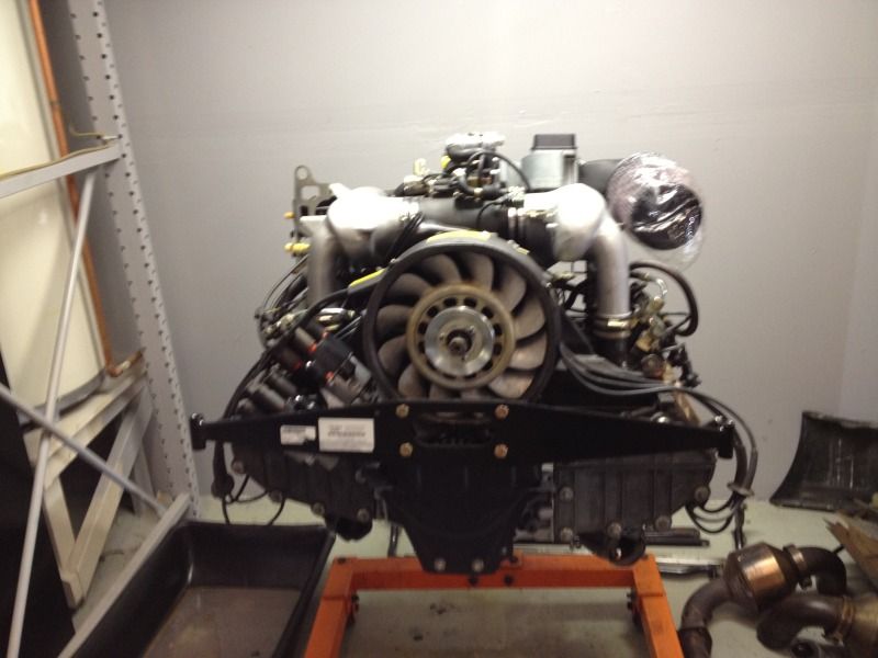

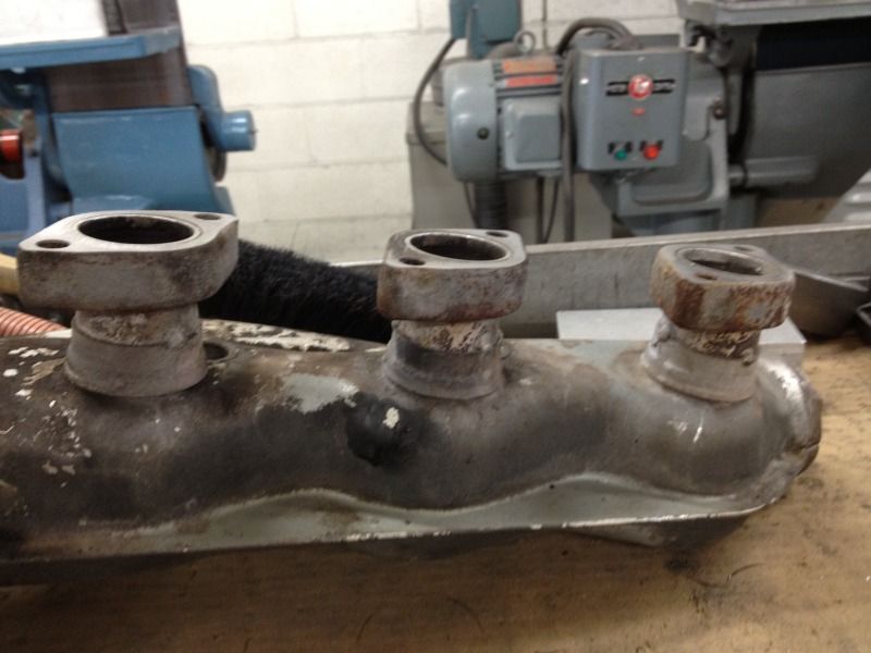

What are your plans for an exhaust system?
I need for the car to pass emissions and would like heat. I am using a slightly modified 3.2 system with a M&K catbypass that I will swap out with a factory cat when I take it in for testing. You can see in the picture where the heat exchanger section mounts has been ground down so that it will mate with the 3.6 heads. I did need to use a little longer stud, but they fit perfectly. I will get some better pictures of it when it is in the car

Originally Posted by cdill View Post
I need for the car to pass emissions and would like heat. I am using a slightly modified 3.2 system with a M&K catbypass that I will swap out with a factory cat when I take it in for testing. You can see in the picture where the heat exchanger mounts section has been ground down so that it will mate with the 3.6 heads. It did need to use a little longer stud, but they fit perfectly. I will get some better pictures of it when it is in the car
A local Pelican buddy of mine rothaus ran that same setup last year. I even considered it for my own car but lucked into a 993 HE setup instead. Honestly I think it's a pretty good system. Affordable and easy to install too!

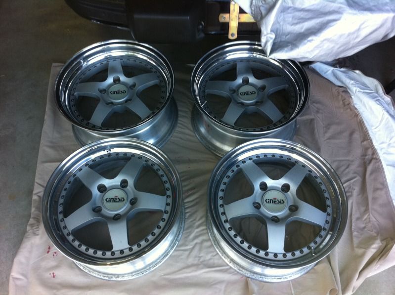

I also scored a set of Kinesis K58's?? for the car from a guy on rennlist 17x7 & 17X8 for now I am going to run them in this configuration, but this fall I plan on getting a new set of barrels and making the rear 17x9's

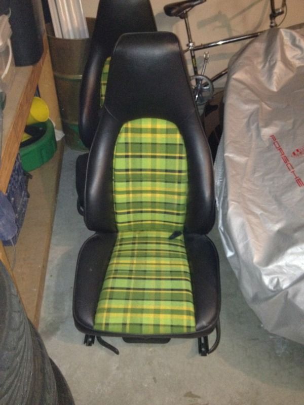

Found a set of sport seats with green plaid insets!! the entire interior is in excellent condition and black so I think these may look pretty cool. I am undecided at this time because they are power and not sure about adding weight to this car.
Old 05-04-2012, 07:09 AM
Banned
Join Date: Aug 2011
Location: The Wet Side
Posts: 5,675
Those seats are so cool that the weight penalty is worth it.

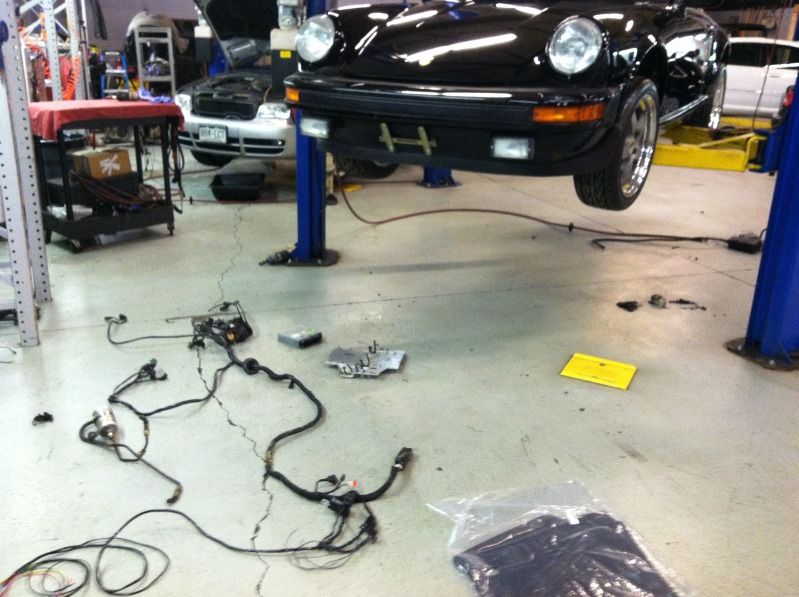

Old wiring harness out, new harness in, and the 915 meets the 3.6 today
