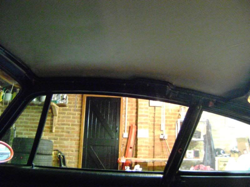

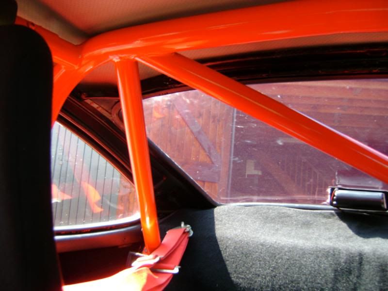

Its not quite what you are after, but I will explain why. I had the sunfoof removed and a panel welded in, so I didn't think it was neat enough to leave in paint. So I used 5mm foam spray glued in and then glued light grey perforated vinyl to that. Metal work was sprayed matt black just to be unobtrusive.
This is before cage
And another view with the cage
