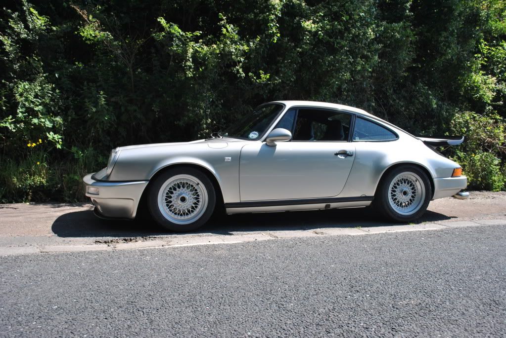

Originally Posted by Doug&Julie (Post 6914328)
Do you have a profile shot of the whole car?
Certainly, this one is of the car on its track BBS RS split rims.

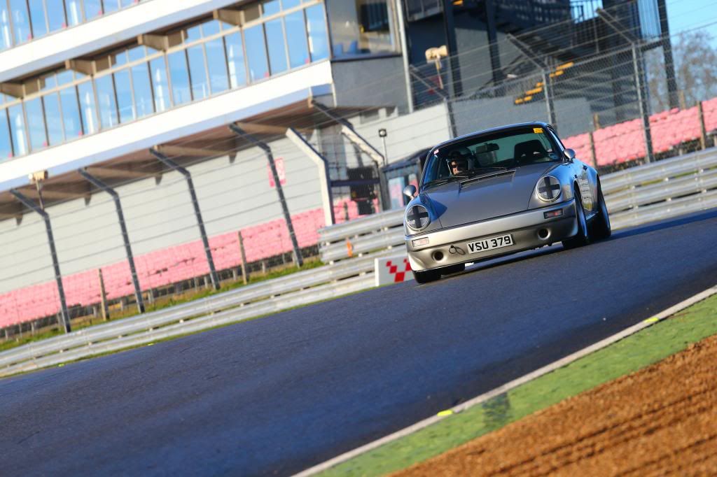

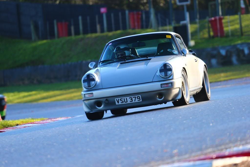

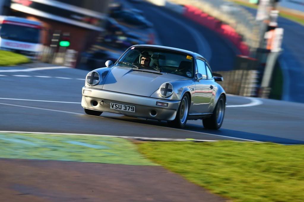

Here are a few track picks from a couple of weeks back (Dec 20 2013), that show the bumper is holding up fine.
http://i226.photobucket.com/albums/d...ps1123a984.jpg
http://i226.photobucket.com/albums/d...ps9260a50b.jpg
http://i226.photobucket.com/albums/d...ps2c6371b3.jpg
There is an issue with extensive stone chipping, which is a function of the shape and ride height, which you have to live with if you drive it!
I have had to replace the "splitter" on the lower edge a couple of times, but I always regarded it a "sacrificial".
