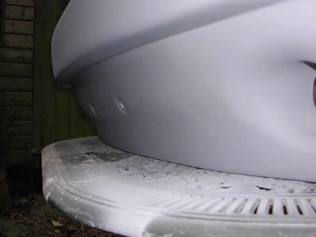

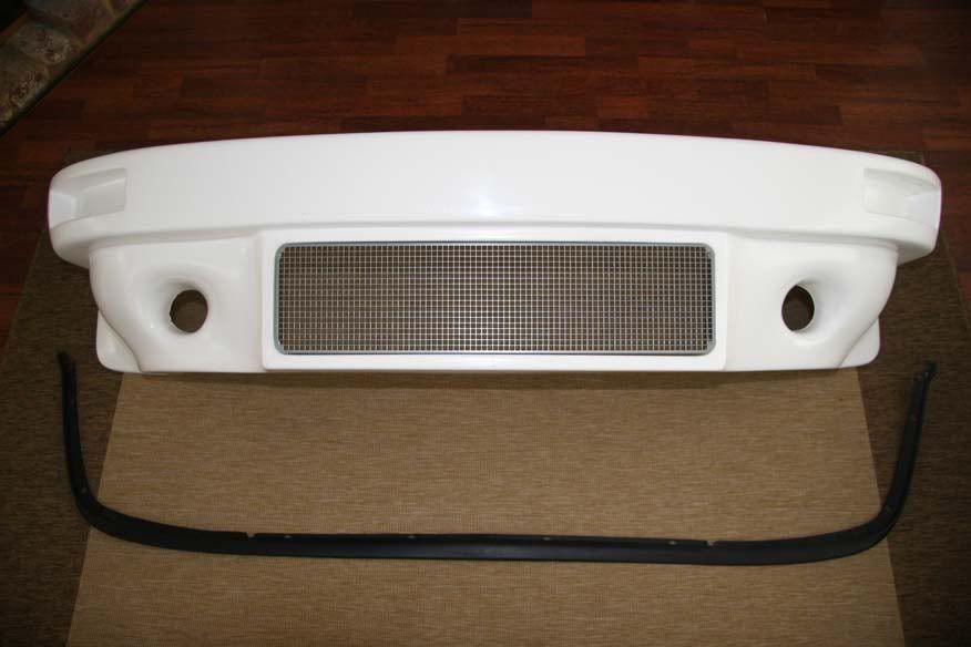

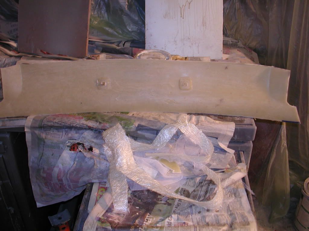

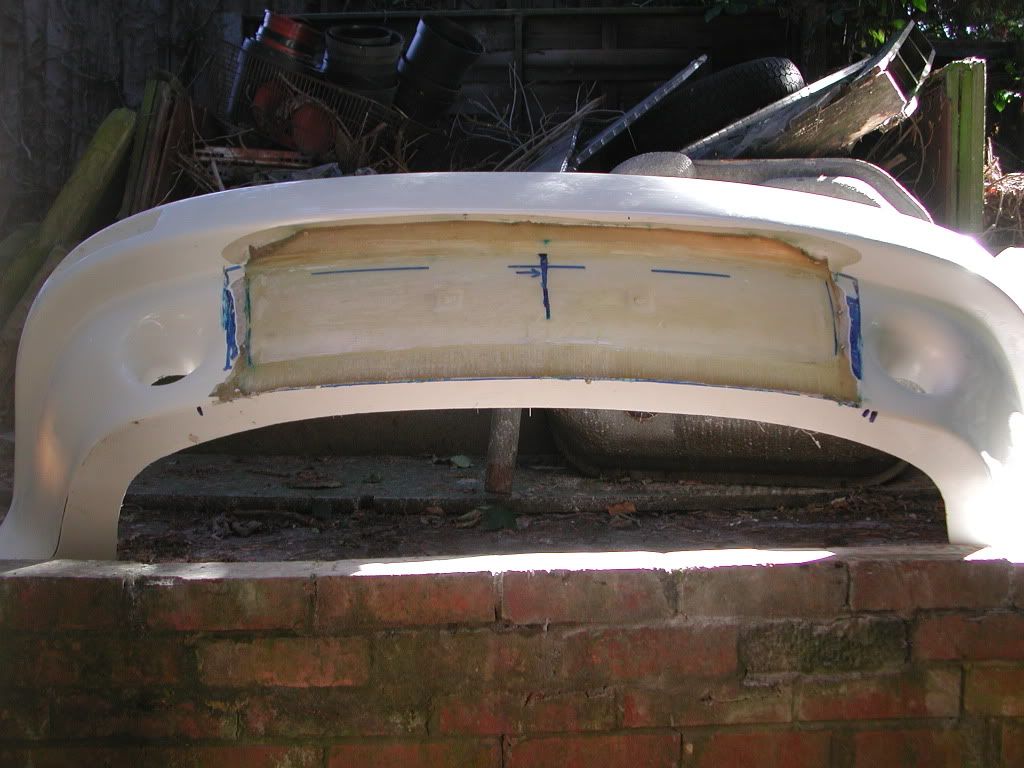

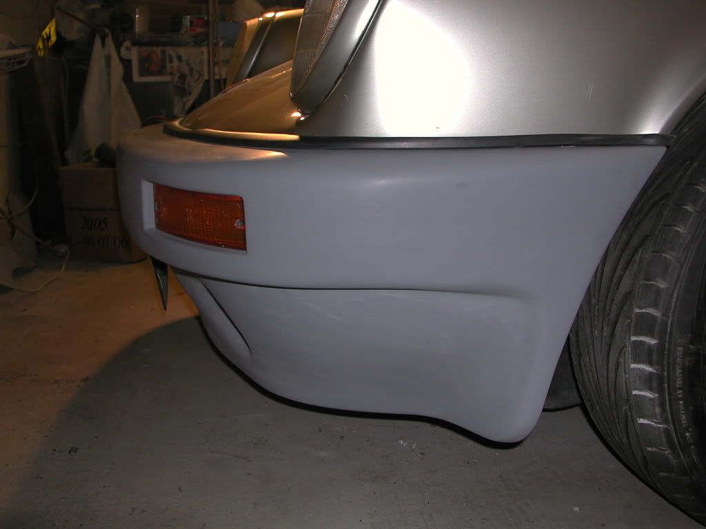

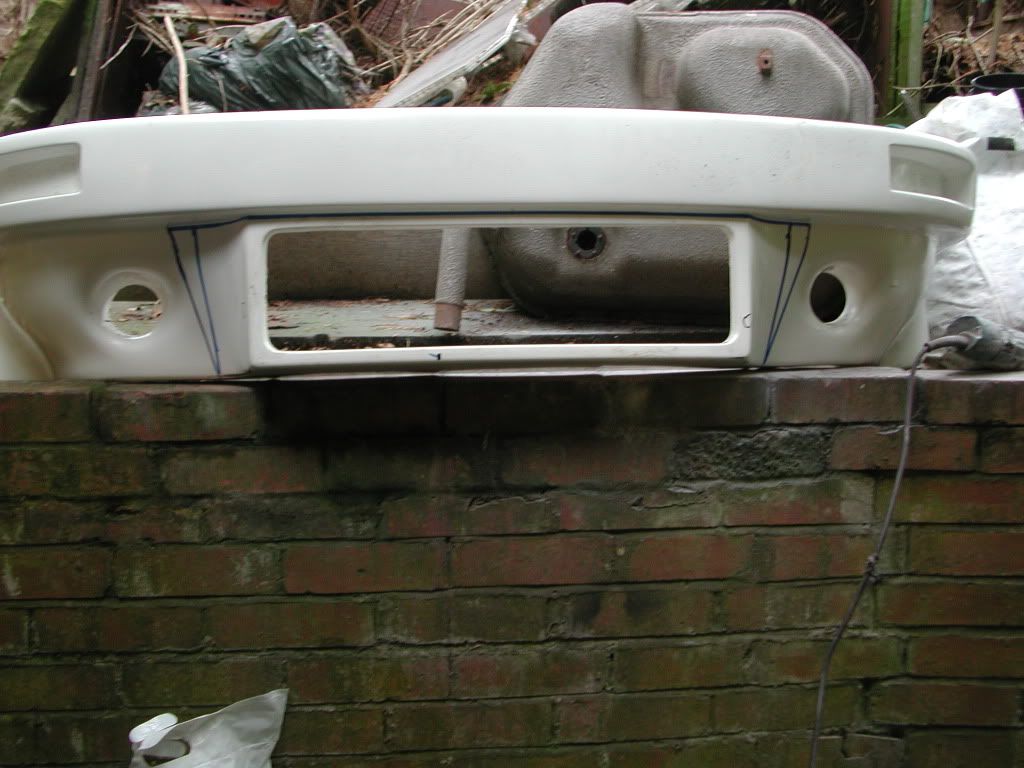

I wanted to lose some weight by fitting fibreglass bumpers and I had a new narrow body IROC style bumper sitting in my garage. However, I wanted a different look and so I set about modifying it
Starting point

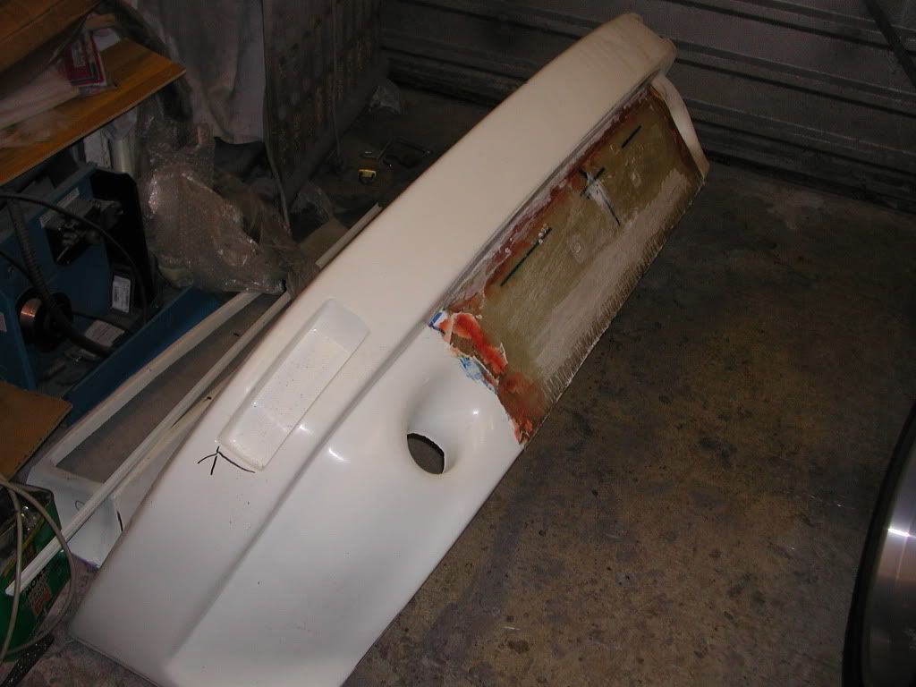

Marking up

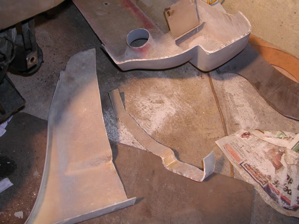

No going back now
Making a mould of the centre section of a spare front valence.
The filler piece made from the mould

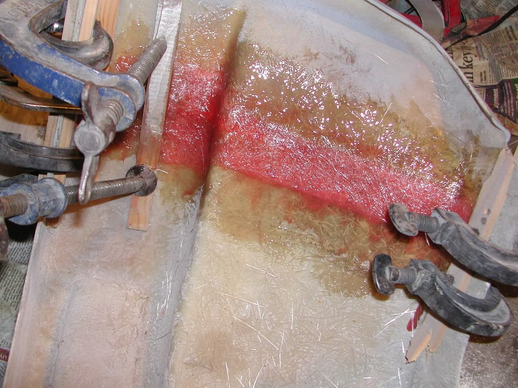

Bonding the filler piece in place
Filling the gaps and shaping thing up
Getting there

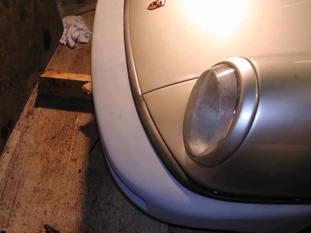

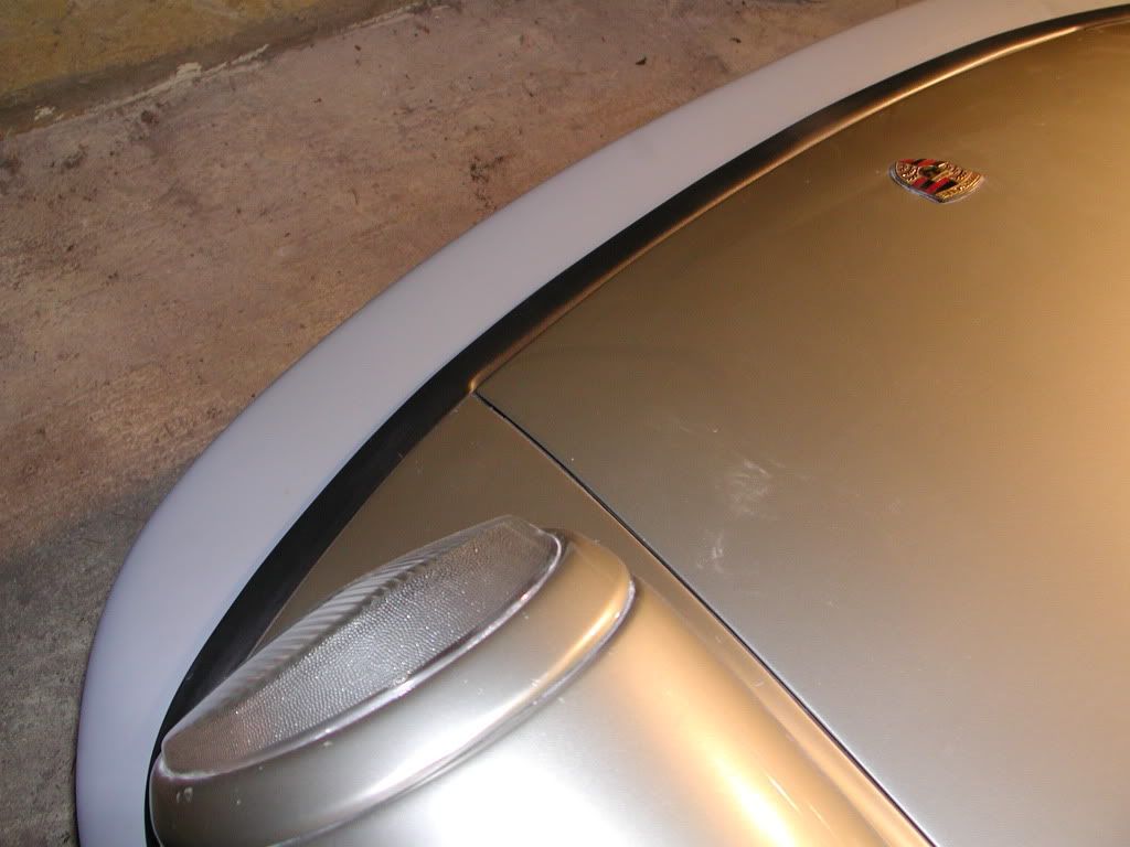

With some some primer filler
Trial fit.
Looks OK, but looks better if it did not extends forward so much

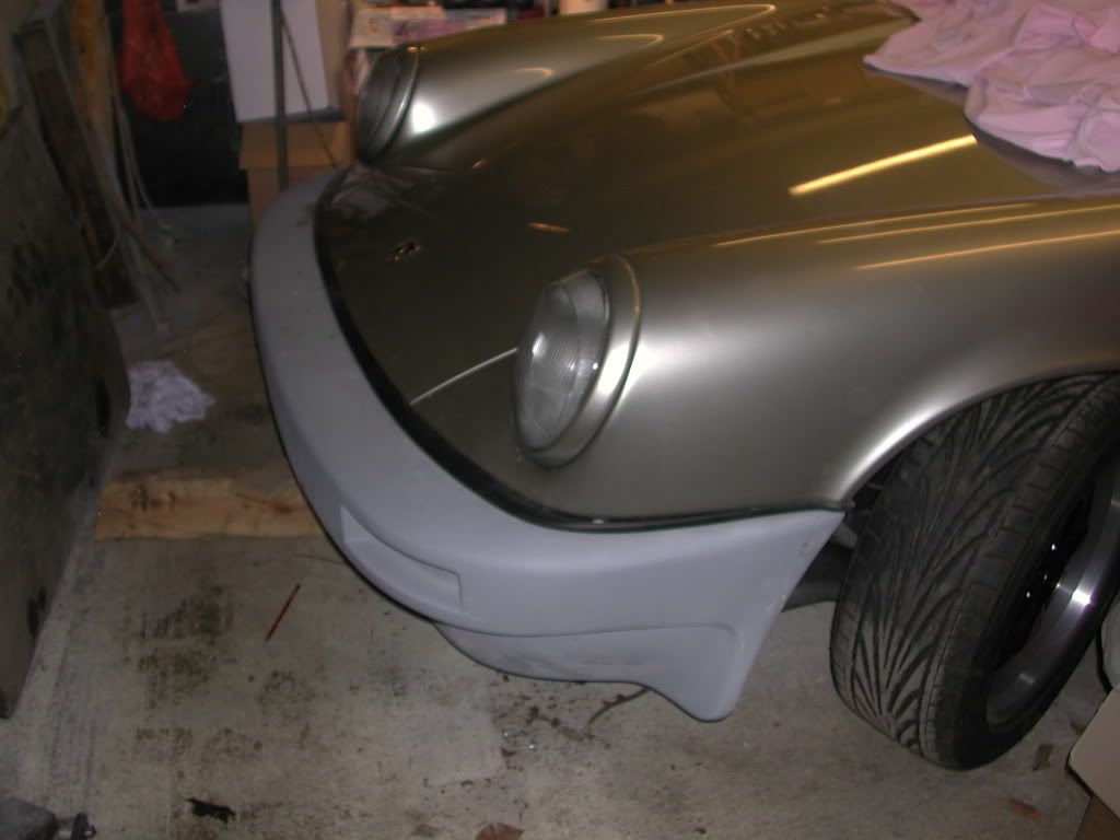

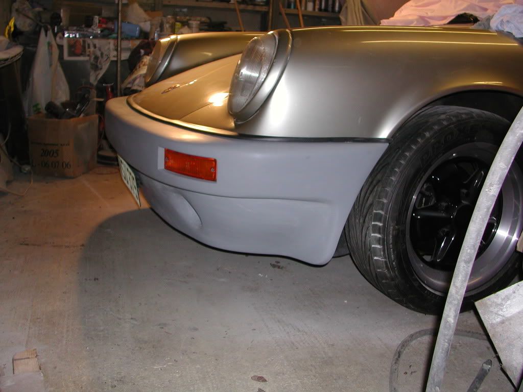

So...
Smoothing and shaping.
Old 06-12-2012, 01:02 PM
SilverWT's Avatar
Location: SE London UK
Posts: 130
With some primer, again!

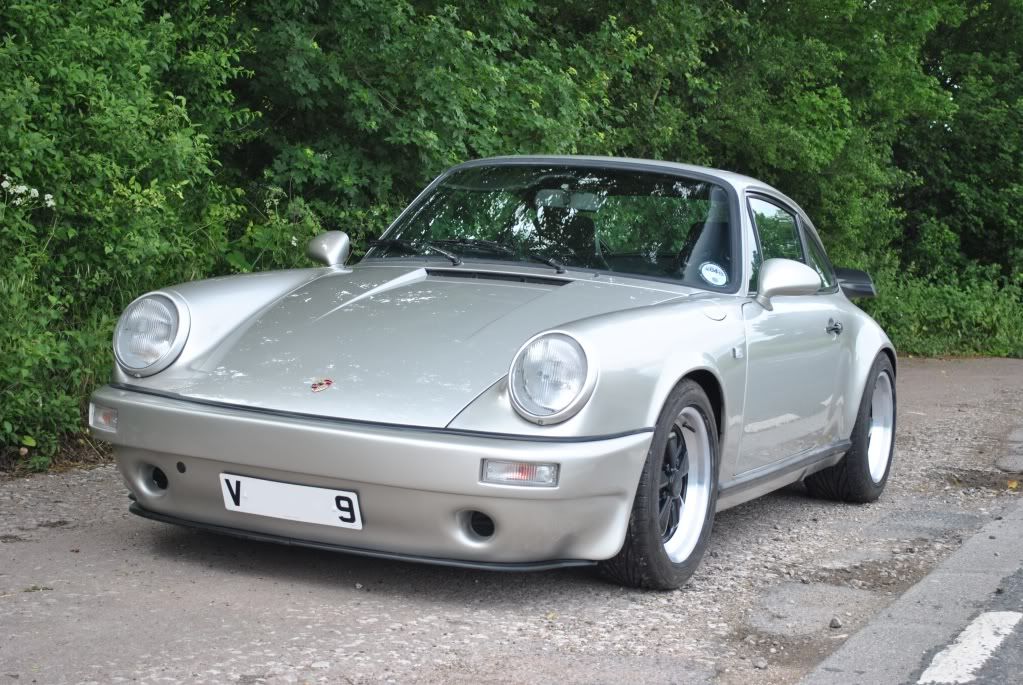

Also made a small splitter to finish it off. Made the plug in wood, took a mould and laid up the splitter in fibreglass cloth.
After running them in primer for a year, eventually painted.
And back on the car

Nice work, certainly is different, looks 964-ish with brake holes. So I suppose you don't have an oil cooler up front. Is that a 964 smile?

I think it would also look good without the brake duct holes. They are useless unless you have ducts connected directly.

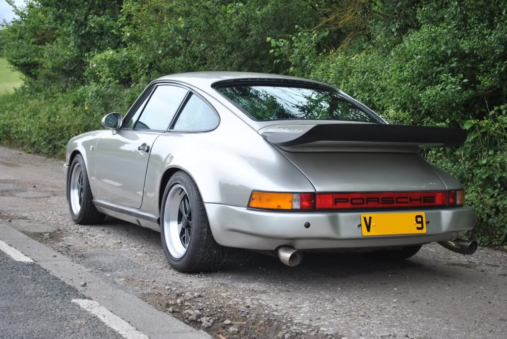

Very nice! Did you install a rear bumper to match?
Thanks for the positive commets..
Standard Carrera 3.2 oil cooler in the fender, a second one on the the side to follow.
Yes, 964 smile
Old 06-12-2012, 03:38 PM
SilverWT's Avatar
Posts: 130
Yes, which also had to extensively modified to get it to fit just right.
The rear tail is also lightweight fibreglass as is the engine lid.

Originally Posted by Flat Six View Post
Nicely done! I'm curious about how you made the mould from your original valence. Would you mind offering a brief description or a couple of links to point me in the right direction?
Thanks much
Stripped the old paint off (as it was not in good shape)
Waxed the metal
Painted on a layer of resin
Added several layers of fibreglass matting and resin
Prised it off when set
