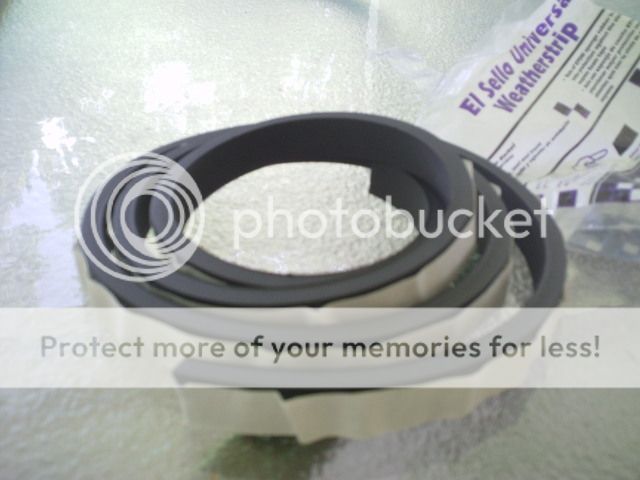

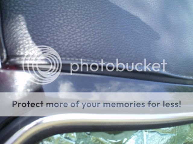

I use some 5/16 x 3/4 weather stripping to basically do the same thing to stop my top from leaking. I guess the old seal was pretty much collapsed after all these years.
The stripping seems to be working, no more water pouring in from the front. I also used some on the back seal along the Targa bar, much better than it was. I was pouring in before.
Got the weather stripping at Autozone.
