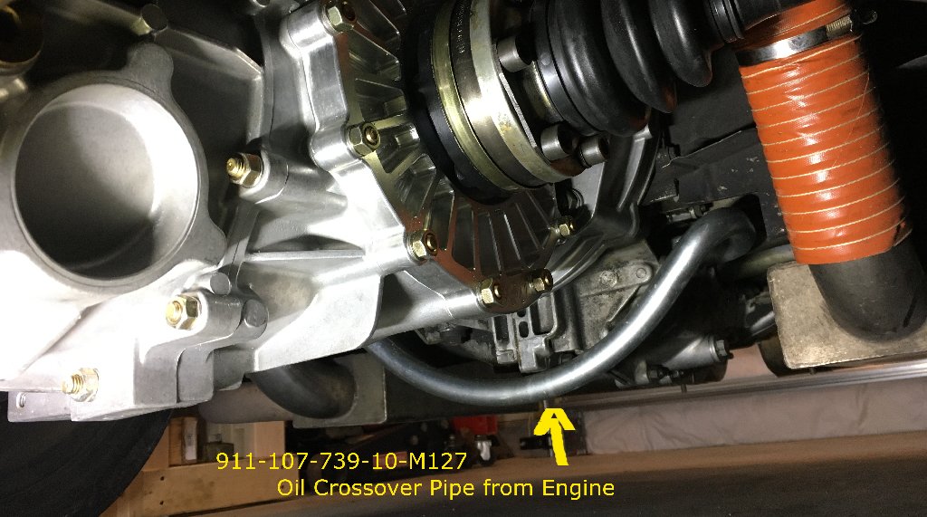

ADDvanced 05-23-2020 09:45 AM
Does anyone know if this is the line in these photos is the same as the one used on mid year 2.7s? I am going to be installing B&Bs and I was unaware there is any sort of compatibility issue with this oil line; some posts say that I need to upgrade to the elephant racing universal oil line, that goes OVER the transmission. (https://www.elephantracing.com/911/oil-cooling-for-911/oil-lines-hoses-fittings/oil-lines-hoses/universal-oil-crossover-pipe/)
But these photos suggest otherwise.
Which is it? Stock oil line (under the trans) works or not?
KTL 05-23-2020 12:58 PM
I don’t believe the 2.7 has a line similar to the one pictured on “my” 3.6 up there. So I believe you’ll need to change the oil line. I do know the typical SC or Carrera style line does not fit with the B&B headers. Their header kit includes a flexible braided stainless hose that replaces the original steel line (actually two lines). These are the lines that runs under the engine, around the back and connect to the thermostat in the forward area of the passenger wheel well

ADDvanced 05-24-2020 07:13 AM
My oil line looks like that one.
From my reading, any oil line that goes UNDER the trans won't work, and you need to get the elephant racing line that goes ABOVE the trans.
Yet these photos suggest otherwise.
Are you saying there are multiple kinds of oil lines that go under the trans?
KTL 05-24-2020 10:34 AM
If your oil line looks like that one, it should work. That picture shows it does. The underside of a 3.6 is no different than a 2.7 in terms of the engine structure and the oil exit location
No I’m not saying there are multiple oil lines that go under the trans. There are multiple different oil lines that go around and under the rear of the engine. SC is a bit different than Carrera and both of them are drastically different than the 964 3.6.
You won’t find much better pictures than I provided. The pictures clearly show the half moon under-trans line clears the B&B long tube headers for their own muffler
I believe the typical half moon under-trans line will work for you. Or the over-trans Elephant line will work too

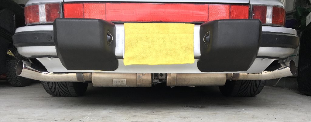

cliyde 05-26-2020 12:19 PM
Not a fan of the muffler weight and 2K drone using B&B, but overall performance, looks, and sound is sexy! My setup is very similar to the pics above. I'm using a Dual out B&B muffler/header combo mated with a 3.6L. These OEM lines worked just fine for OIL plumbing and allow for decent clearance away from heat exchangers.
911-107-739-10-M127 Oil Crossover Pipe from Engine
930-107-729-10-M127 Oil Line - Oil Crossover Pipe to External Thermostat
