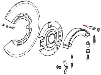

OK, I finally had a chance to take this apart and have a look. The shoes, or actually just one of them, is quite worn. I couldn't see anything obvious that would cause the brake to drag. When I put the rotor back on and gave it a turn, it still dragged. I adjusted the brake so it would be as loose as possible (not against the drum) and it still was dragging. WTF?
I pulled the rotor again, and checked everything a bit more closely but nothing jumped out at me that it might not be correct, other than the worn pad. But then after a closer examination of that pad, I got to thinking. Why is just one pad worn? I did some wiggling and compressing and pulling of springs and came to the realization that for some reason the brake assembly doesn't want to stay centred in the drum.
What I suspect is happening is that when the brake is released it doesn't centre itself. When it was making noise after being parked and I just gave is a bit of a goose with the brake handle, it would jump off the turning drum. After some time driving down the highway, gravity and time would allow the pad to rest on the bottom of the drum. The pad assembly is fairly easy to move by hand up or down and it will more or less stay where I leave it.
The question I have now is what keeps the brake shoe assembly in the middle of the drum? Is there a spring that I can't see? Is it a matter of having corroded parts that just don't want to easily return to their resting position? Suggestions?
Should I just replace all the springs in there when I do the shoes with the expectation that that'll fix it all up? I mean, really, it's not a complex assembly. There isn't all that much to go wrong...

You are correct, it is not a complicated system. I just went through mine a couple of months ago and replaced everything in my 83 SC.
The only thing that holds the shoes to the back plate is the Conical springs and pins. They are very visible. You should see them on the center of each shoe.

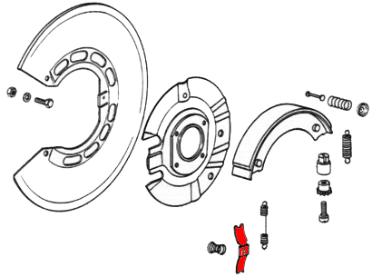

One thing you should check is the Expander. There is actually 2 on each side. The back one is not that easy to see. If that came off it would mess up the alignment.

Now that you have the rotor off, we get to start taking the brake apart. The first thing to go is the star adjuster. Take a screw driver and slide it under the brake pad and pry it up gently. This will open the gap enough between the two pads to allow the adjuster to be removed. You might have to work it a bit to get it to come free. If you didn't adjust it down, it will be difficult to get the pads apart enough to remove it.
The adjuster. It's three pieces the star wheel which is threaded onto one end piece. The other end piece will just slide off. Careful not to lose it if it comes off unexpectedly.
After the adjuster is out, it's time to remove the return spring. That's the one right next to the adjuster. It's a real pain to get out. I don't recall exactly how I did it on the other brake, but on this one, I just cut it. I have new ones, and a used spare from the other side, so why suffer trying to remove it if I don't need to?
Next up, we need to remove the conical retaining spring. There are two, one on the top side and another underneath. If you're using jack stands, you're gonna have to get down there on your back for the lower one. Anyway, these aren't a big deal to remove. The washer on the end is what holds them on. There's just a rectangular pin in the centre that fits through a hole the same size and shape in the washer. Just hold the pin with some needle nose pliers, hold the outside edge of the washer with some vice grips or regular pliers. Compress the spring to allow the pin to protrude more and turn the washer until the pin will slide through the hole. Easy eh? Not really. These springs aren't that high of tension, so I found it easier to do it by hand with no tools. You almost need three hands to do this with tools.
Anyway, I just put a finger through one of the holes in the dust shield to put pressure on the back side of that pin. Then I compressed the spring with my two thumbs and turned it at the same time until it lined up. If you can get it a little way and the rectangular pin is out of its well it sits in, you're out of the woods. Take a little rest so your fingers can recover and do it again to get it out the rest of the way. Here's one of the places your newly invented words come in to play.
I didn't get any good pics of this next step but this one shows the double coil spring and the expanders. With the conical springs off you can push the pads to the side to relieve pressure on the double coil return spring that sits at the front of the brake kind of behind the expander. It should be pretty easy at this point to remove that spring by doing some gymnastics with the pads to get it to unhook from the pad. Take a moment to look at the spring and remember which way the coils are wound. I don't know if it matters, but if the spring is inverted, the coil direction is different.
I didn't replace the expanders on my brakes because I didn't want to mess with the brake cable. I have a set in case my brake issue isn't rectified, but I just didn't want to deal with it right now.

Once that's complete, you're almost home free. Ensure that the pivots for the expanders are properly engaged in their slots on both pads (all four pivots). If not, you can pry them open a little bit to get them in there.

The only thing I notice while doing mine (as you notice) is that the star adjuster will work either way but by putting one side reverse of the other one is the direction (going backward with the screw driver) will tight them up as per the adjustment right up in the Porsche manual.
2 of my expenders (1 per side) were broken, no wonder I had no E brake.

Yeah, my expanders appear to be doing what they're supposed to (I think). I suppose it's conceivable that all four are messed up. Anyway, I have new expanders and springs in the event that things decline quickly back to the way it was. Otherwise, it's all good, now.
