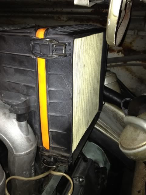

The first thing I did was add all hardware for the air box,
Seems I was missing a nylon nut inside of the box Doh!
Then installed the air box cover that was previously modified to Cup Spec
http://i60.photobucket.com/albums/h3...C/8a744f79.jpg
The upgrade part about this box was that It makes it easier to bolt on and access that annoying lower clip

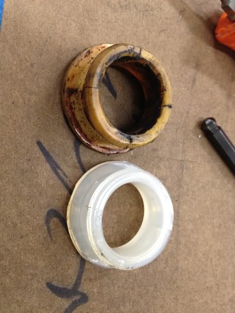

Then came the Cup for the shifter ball
You can clearly see the difference between the two
It didn't look bad until I compared it to the new one, The old one had also turned rock over time...White grease was my friend once again
http://i60.photobucket.com/albums/h3...C/cf87fe99.jpg

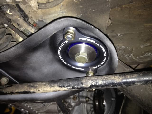

Another nice shot of the Rebel Racing Transmission mount
http://i60.photobucket.com/albums/h3...C/49de9bbd.jpg

The REBEL RACING ENGINE/TRANS MOUNTS
Gave the car a perfect ride, The transmission we rebuilt was smooth like butter.
