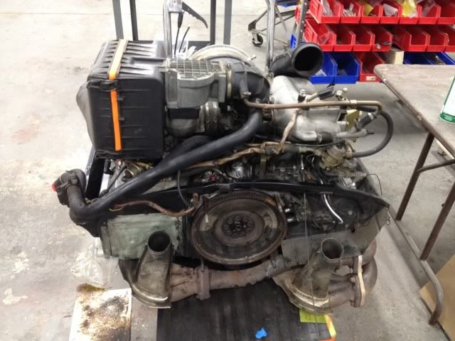

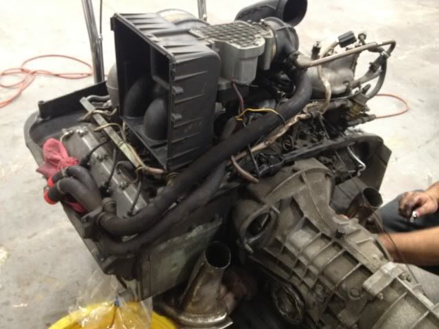

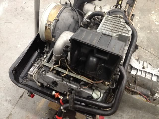

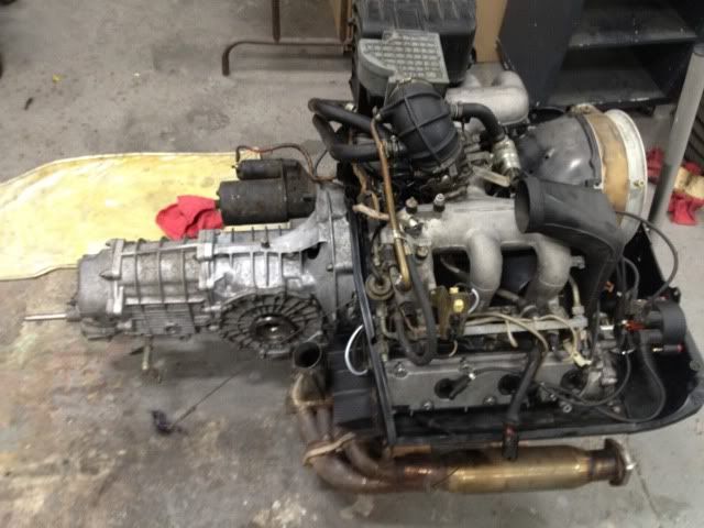

So today I decided to remove my ROW 3.2 Engine and transmission from my SC,
After developing some problems with my transmission
Where my 1st gear would no longer engage I knew there was trouble in paradise.
I contemplated switching to a 923 (7:31 ring pinion transmission)
but quickly abandoned the idea
As posted on this thread---->
Who has done a 923 Transmission (912E 7:31) Conversion ? I'm about to
Now its back to the 915 transmission
I Always forget how much fun it is to remove Older 3.2 engines !
I spent 3 days studying the 101 Porsche Projects book our host wrote (such and awesome book and highly recommended, I have 3 copies for different rooms)
----> Pelican Parts - Product Information: BK-131569AP
So after paging the book for a few days (in the bathroom, during breaks, during lunch and at night in bed )
I pretty much had it all fresh in my memory.
Every single item came out with out a hitch
(other than a rusty exhaust clamp)
I found some ugly stuff while digging around
Ugly drop links
bad sway bar bushing
Question able motor mounts
Questionable rear shocks
Various lines to replaces
the list goes on

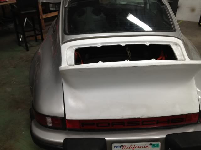

To make life easier the Turbo style decklid was removed and most likely not returning to the Chassis ! A Duck tail will take it's place

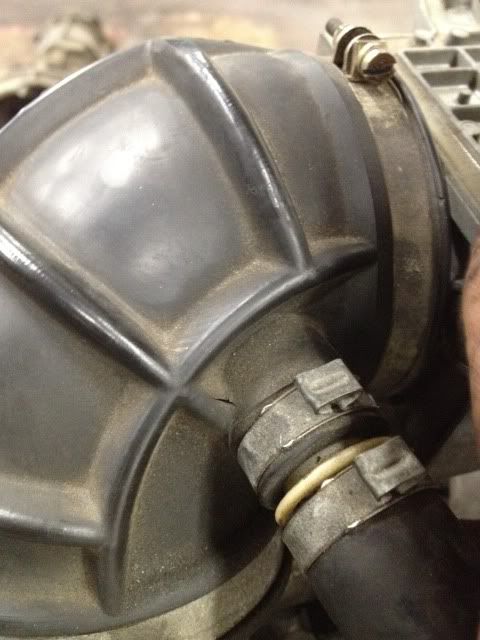

Something very disturbing I found was a ruptured intake boot!
It has two holes in different spots! yikes not good
If someone has one let me now... Other wise I may have to go bug my old boss at LA Porsche
Engine was a little dusty.... Ok ALOT of dusty!!!!
I will have to clean (pressure wash it! before it goes back in)
Engine only has 85k miles on it !

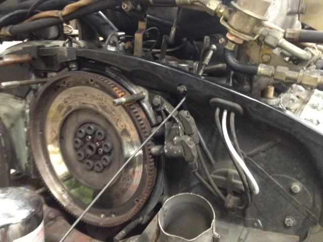

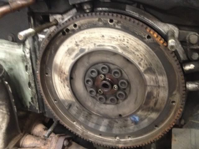

One thing that did not make me too happy was the flywheel it self!
It looked glazed and felt wavy like an old brake rotor!.... time to replace???

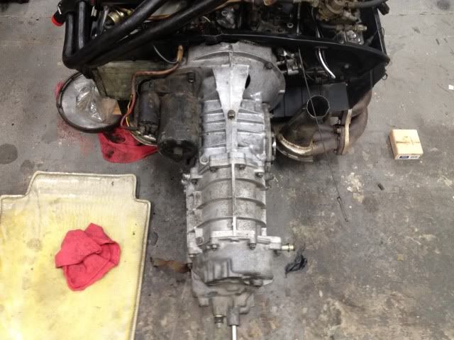

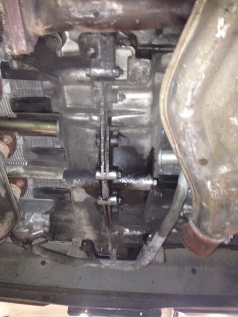

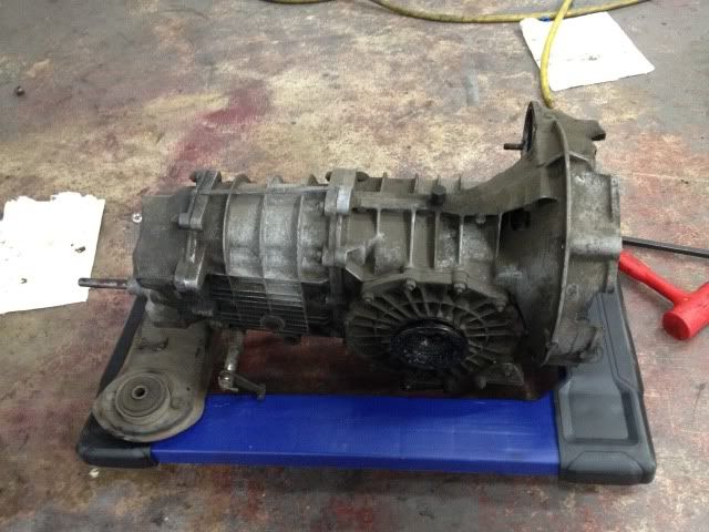

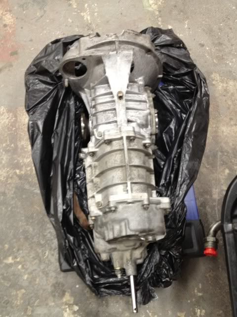

The 915 Transmission looked pretty nice from the outside
(other than being dusty) No Oil leaks on the Engine or transmission that was a big plus

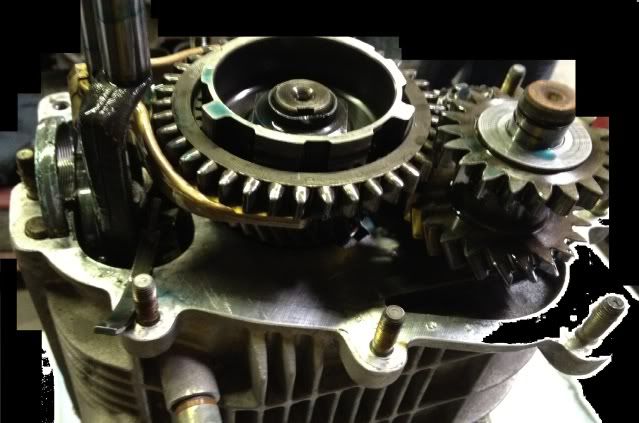

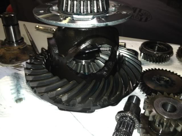

looks like this guy will come apart tomorrow
Going to rebuild the Axles
purchased gasket/seal kit

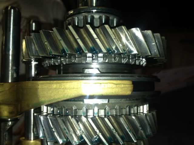

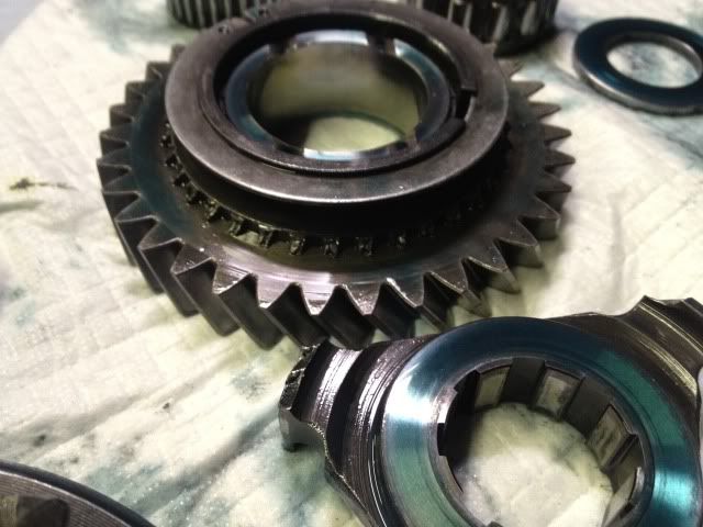

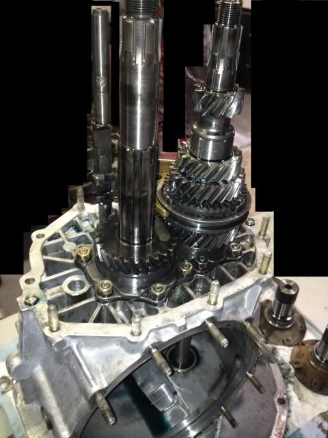

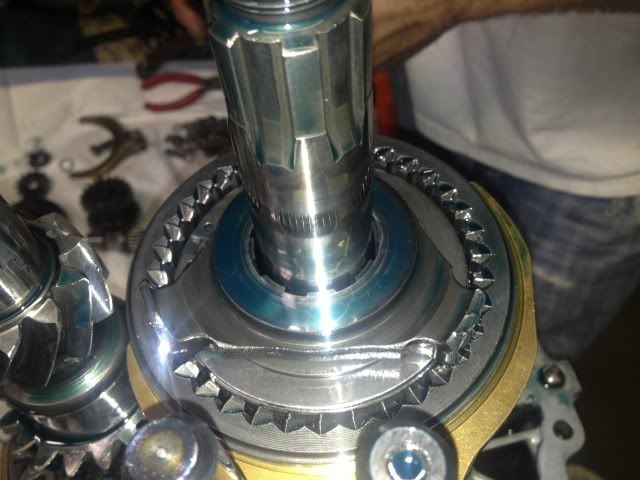

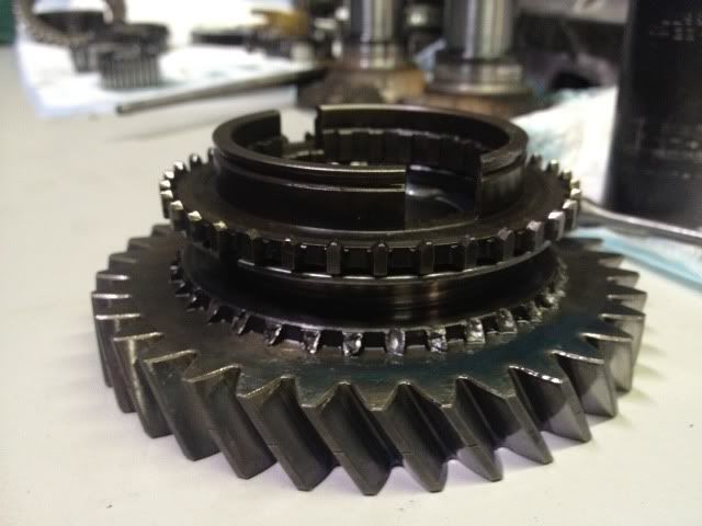

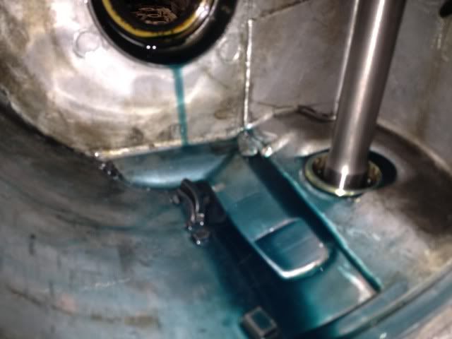

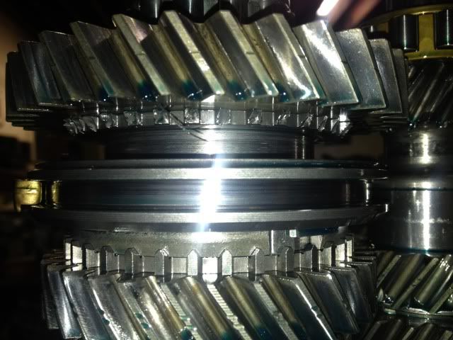

I found 5 very small teeth in the blue Swepco oil
I used a painters paint filter to find any traces of shrapnel in the oil...
luckily everything was fine and only found evidence of carnage in the magnetic drain plug.

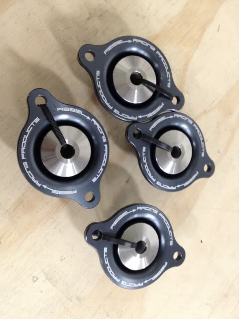

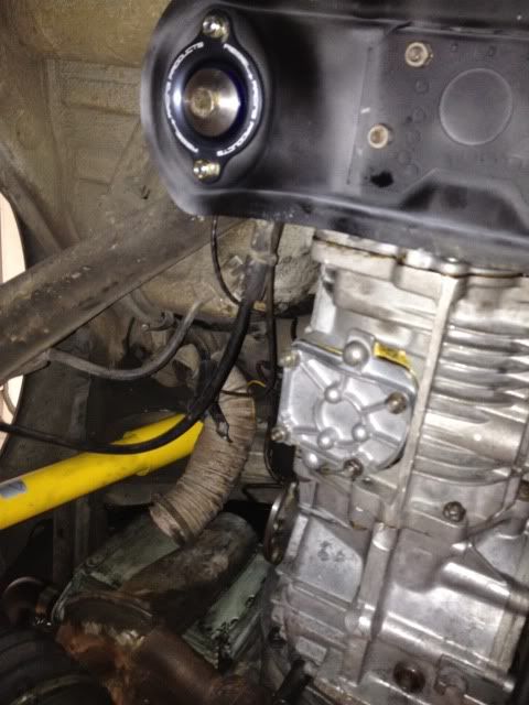

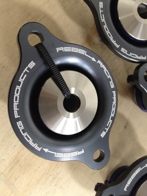

The engine and transmission mounts look ok but I made a quick call over to Clint Rebel Racing Products Link----> Home to order his Engine/transmission mounts ! As usual He was very helpful and quick with the order.
I'm very exited to install these on to my car I think they will make a huge difference in feel. I also picked up some Bilstein Sport rear shocks to go with the Bilstein front Sport inserts I got from Rebel Racing previously.

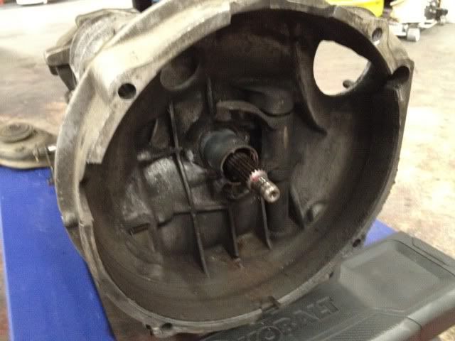

This Throw out bearing below has some serious play!!!!
Is this normal ? moves quarter of an inch in either direction (up/down)
purchased new a few hundred miles ago
the transmission would make noise when I would not press the clutch in
Like a chatter very very annoying
the clutch plate had even wear through out
so I don't think anything was warped

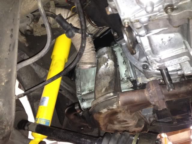

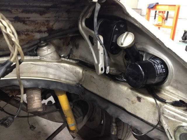

The underbelly of the engine bay!!!
Looks like I need new heater tubes
and a Serious steam clean

Looks like big fun! On a few of your questions -
The flywheel can be turned like a brake rotor, and sounds like it should be, as long as it's within tolerance.
If I recall correctly a little lateral play in the throwout bearing is normal. Your chattering might have more to do with the condition of the flywheel, or possibly cable adjustment issues.
I think I have one of those intake boots in good shape. What's the part number? PM me for details.

I'm hoping the flywheel can still be turned
I've never done it, might have to take it to a shop or something... ?
The cheapest new flywheel I could find (84-86) was close to $400
The cable for the clutch looked fairly new ...maybe clutch adjustment!
the part number for the intake boot is 930.110.356.02
I figured If I couldn't find one easily I would just glue it and JP weld it ???

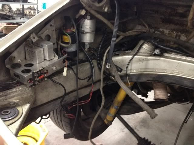

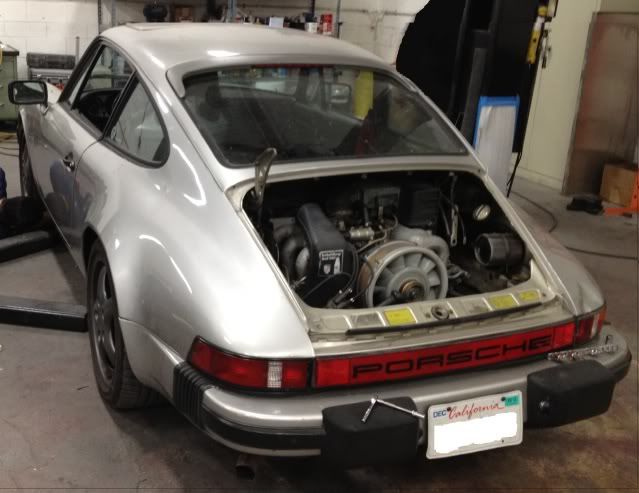

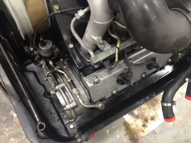

The engine compartment is FILTHY
I spayed the engine with PB Blaster Citrus degreaser and Yep aerosol
It was really cleaning up nice I was very surprised how clean it was under the muck.
I plan to Steam clean the engine compartment for the most part is cleaning up well!
I'm trying to close my eyes about "while I'm there" parts to buy since I'm extremely low on cash...
This Is the Engine compartment after cleaning it with a Rag and some Zep Spray... I think the steam cleaner will really make this look nice and fresh
Planning to take apart the fuse panel and make it nice and legit.
New Fuel Filter
New hood shocks
Clean up some wire
This car needs new Heater box accordions

What really has to go is the Cabriolet Engine support mount with shock
any one want to trade for a solid ??? Or want to buy it so I can get a Solid one
(before cleaning)

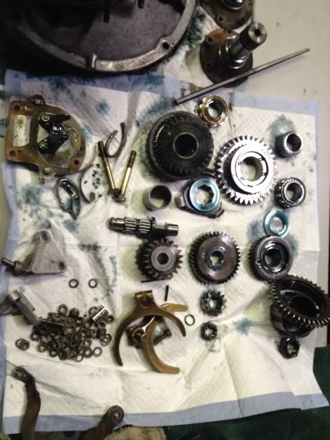

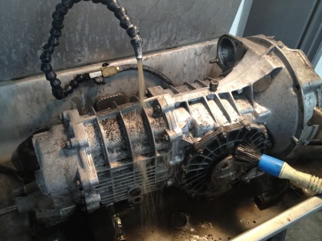

Got the Ultrasonic cleaner out.... added some degreaser in the mix and the parts are coming out super clean
n

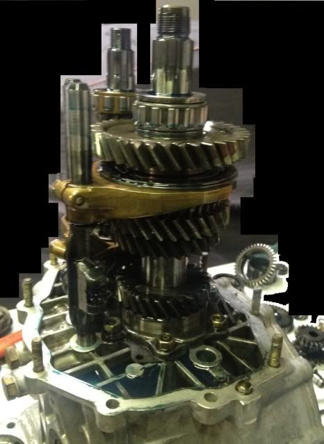

This is the 915 Taking a bath ... It cleaned out pretty nice
I barely washed it and scrubbed it. Thank goodness I have a parts cleaner
I'm hoping it looks like new after I get it all rebuilt

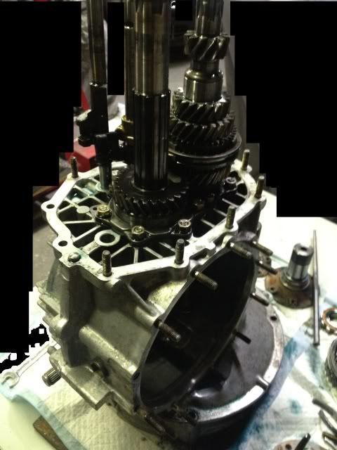

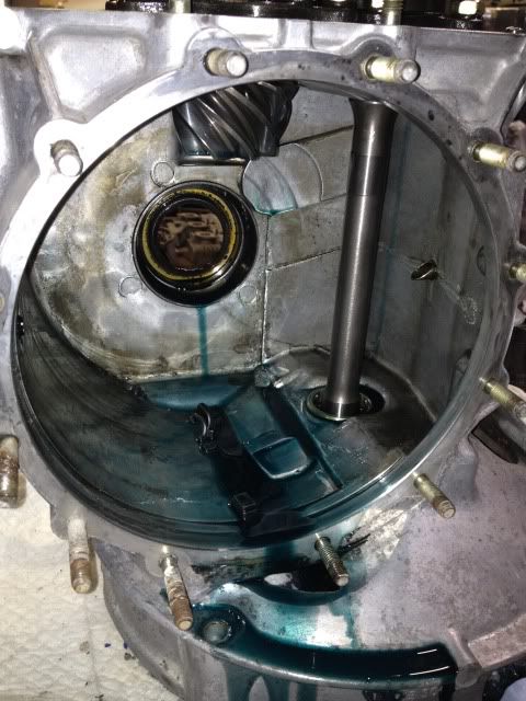

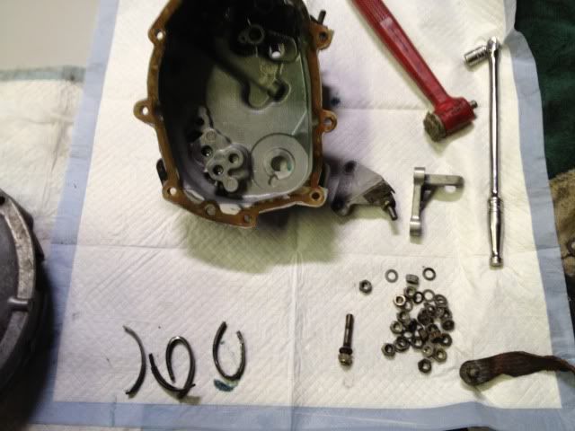

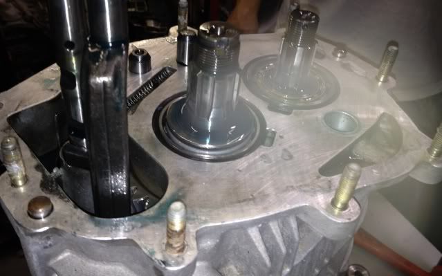

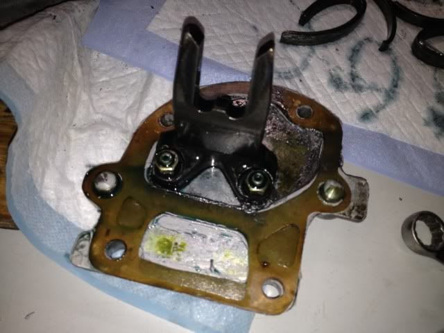

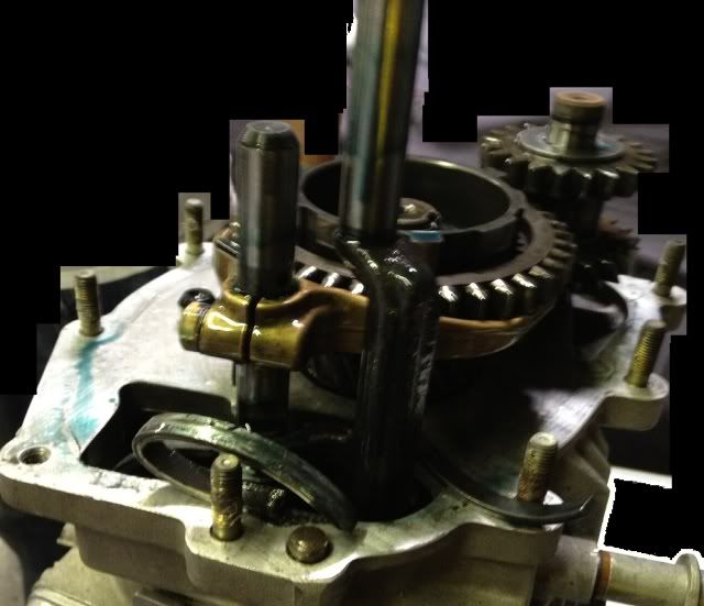

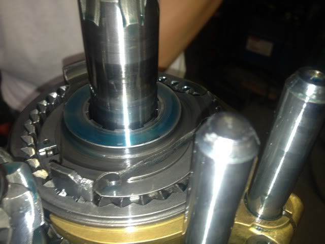

SO HERE IS A BAD SIGN!!!!
It seems the nose cone has been removed already !
I found some non factory sealant and the bolts upfront looked like they had been removed
Maybe this is why it was shifting funny....bad job ?
Total bummer, I will post what I find
Any suggestions would be awesome

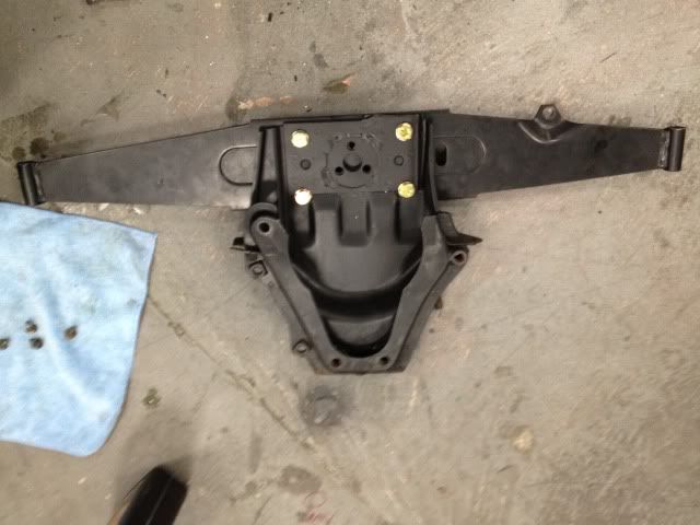

Old 08-10-2012, 10:35 PM
Blackbyrd's Avatar
Join Date: Dec 2009
Location: Los Angeles
Posts: 7,073

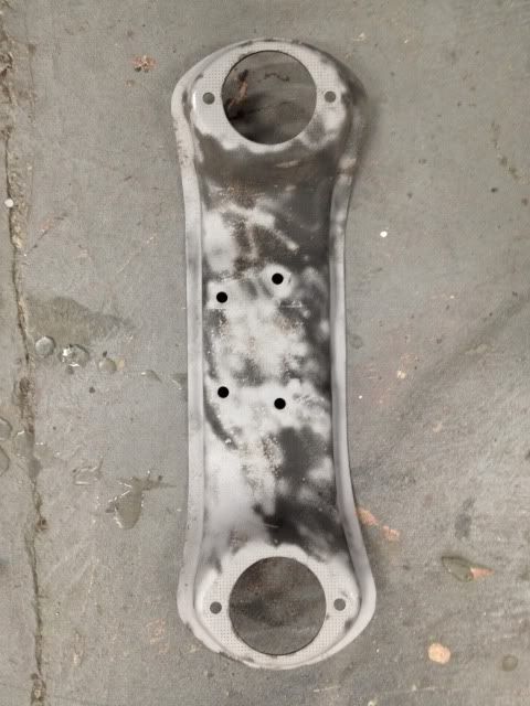

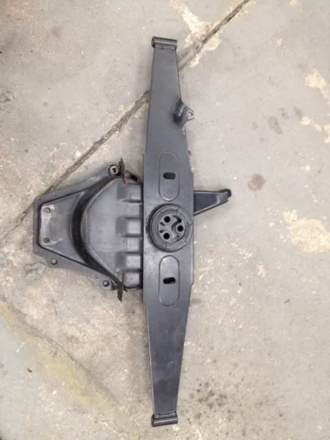

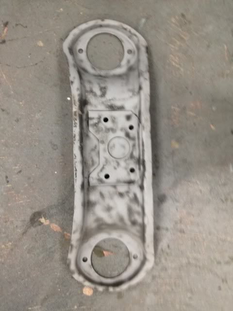

Oh yeah this is the transmission mount
I'm gonna sand blast it shortly then a quick spray paint

The boot I have is 930.110.358.05. Not sure if it makes a difference or not. You can do a little research to see, and let me know.

mcaterino seems like that is for an SC
I need one for a Carrera I think I will fit mine ..super glue and JB weld.

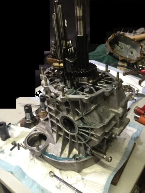

The Story of my Engine drop/ Trans rebuild continues
Sunday was the day I was finally able to get into my transmission and start the rebuild process.
It was a very hot steamy California summer day, I had woken up at 4am so I could make it over to the world famous
Pomona VW/Porsche Swapmeet.Arrived at 5am, I didn't score too many items so the day was already kinda dry. I left by 8:30am with a Ducktail, Tail lights, Some minor parts, emblems and 70 pounds of Legos!

Pulled the ultra clean tranny that I had shrinked wrapped out of my friends borrowed car....
FINALLY ITS TRANSMISSION REBUILD TIME
The tranny came apart fairly easy
We cleaned a table added some diaper absorbent rags
Got the 13mm tools out and worked my way in...
This is the first thing we saw!!!!!
HORROR
NOT FOR THE WEAK OF HEART
I though I only saw Freddy Kruger in nightmares
AAHHHHHHH
That's right the Synchro Ring was demolished and stuck in the case!
(I guess that's why it wouldn't shift to first)
Below is another angle of it
This is what I ended up pulling out of the front box
YIKES!!! this is very scary
A little peak below and what did I see
Rocky Balboa himself couldn't knock this many teeth out
a little more removal (sorry about the pic)
As this point I has towels and was picking up all the particles of metal.
Notice the teeth hanging on the case
The little cover (window) was also covered in metal bits
Doing my best to keep items organized

Then we dug into the next part of the Case!
More damage!
The Slider was beyond useable ...totally munched out...gone!
side by side with another one of my Transmissions villians
Some cleaning and further inspecting
Next was the Differential side cover where I knew I would find more teeth
but not only did I find teeth
Found gear brakes and various more pieces shrapnel
ahhhhhhh (sorry about the photo)
The Differential looks ok but will need to be cleaned very thoroughly

digging deeper
The Parts spread
Before and after
The Verdict:
I GOT VERY VERY LUCKY
My Transmission really only needed 4 major items
1st gear Synchro ring
1st Gear teeth brake gear
a slider
Reserve gear
Gasket kit
all other gears and items looks great! and very useable
No crazy damage or bent items I was out of the critical condition room!!!!!

parts wash the internals of the case

I sourced some other items for my Trans
My biggest Score Today (Monday) came when Dave at TRE provided me with a
Excellent condition used 84-86 Flywheel (very specific)
I took my flywheel for him to look at while we made deal on other items
I was wondering if it could be resurfaced.
He said: "NO way that thing is long gone"
At this point my heart dropped knowing I would have to spend $400 (that I don't have) for a new flywheel. He Then told me to wait a moment and off eh went into his parts room he emerged a few minutes later a excellent good used spare flywheel that he just happen to have. (these flywheels aren't easy to come by)
I was glad I took a drive over to his place, for other items not expecting to do anything about my flywheel. He has came through time and time again definitely on my
"Best people/shop list"
I will post a picture tomorrow of the flywheels side by side

Sandblasting the Transmission mount
gonna paint them shortly
and a BIG surprise
Clint at Rebel Racing Sent over a set of
Bilstein Rear Sport shocks
And some of his Newest Engine Transmission mounts
Check out the eye candy
these will go nicely with the engine install

Oh yeah a Duck tail! I got this from a Fellow Pelican member who said he purchased it from TRE The quality looks really good but it's a bit heavy compare to my other Duck tails
Its not bolted on just hanging

I did remove the intake manifold boot
It looked like it had holes but actually didn't
I will be replacing it in the near future I found it new for $65
While I removed the manifold boot I cleaned the inside of the AFM as well as the manifold butterfly it self.

Repaint transmission mount

The drive train is about to go in!
Tonight would have been the night it went in, but due to other projects that didn't happen.
I manage to:
1. install new Spark plugs (old ones didn't look too bad)
2. Modify Cabriolet engine mount
3. Clean, Sand/Grind Flywheel and Pressure plate
4. Install new through out bearing kit
5. Bolt on transmission to Engine
Cabrio Engine mount before
Cabrio engine mount after
This is the T/O bearing being removed...
Turns out the previous mechanic who I paid to do the work while I was off doing something else installed the bearing wrong ...pretty much destroying the bearing after 1000 miles or less
The new one went in Great!
This was like the Scene where Pacman meets Miss Pacman
the starter was test fitted but will be replaced with a newer one
More Cleaning will soon follow as well as further inspections
I will be replacing more Lines and questionable items
I wish I could have just take apart the complete intake and cleaned it to look brand spankin new....but not enough time this round
So further inspection let me to this Spark plug car!!!
I had just replaced this cap 1000 miles or so
It was brand new with a rotor, I couldn't believe it
Obviously trash now

I swapped out my factory engine mounts for
Rebel Racing engine mounts... A few longer bolts made all the difference
Lil Cad platting doesn't hurt either

I managed to remove the rear passenger side Bilstein Sport Shock
and installed the new Shocks that were Supplied from Rebel Racing...
This was pretty easy
Allen tool to hold it 17mm ratchet wrench to remove and a 22mm break bar/ ratchet. I will do the other side shortly
Photos of the shocks installed are coming

I finished installing the new rear Bilstein Sport shocks,
I was told my old shocks looked like and felt like they were still good.
Previous owner told me he had just replaced them...should have believed him !
Replaced the Fuel Filter
Replaced the Oil filter
both Mahle
Added fluid to the transmission
did not go with Swepco (even though I had an extra bottle)
instead I used Coastal 75/90 it came highly recommended by my mechanic friend who helped me with the transmission rebuild he has won many races with it and swears by it. He said he would kick my ass if he found swepco in my trans again.
Installed the pretty Rebel Racing transmission mounts to the freshly painted
Transmission metal cross member mount
Once again I had some trouble installing the Rebel Racing trans mounts
They really require bigger bolts other wise they will not thread all the way.
This is something pretty obvious when looking at OEM mounts.
A few quick bolts solved that problem.
Trans mounts installed
Check out the fresh bilsteins
I cleaned the engine bits as best as I could.
Axles still need to be rebuilt before I can really bolt them on... they look a little dirty to me.
The bottom of the engine got a little oily from cleaning.. I think I need to wipe it down. Luckily my engine has not once dripped oil on the drive way...hope it stays that way.

DONE Install Bosch Distributor cap
DONEBosch Distributor Rotor
(still waiting) Install Distributor dust shield
DONE Clean Distributor
DONE Install Cup style modified Airbox cover
DONE connect Fuel lines, Oil lines
DONE connect electrical cables
DONE I can NOT find the wire for the reverse light!
It must have gotten stuck somewhere ughhh!!!!
