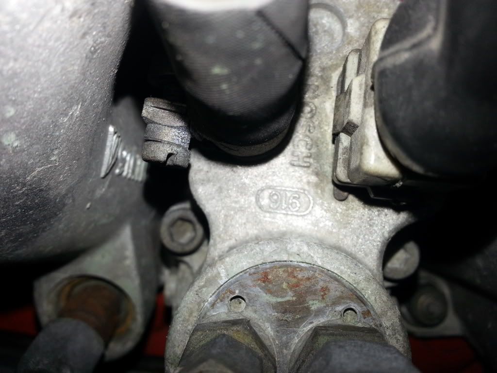

Michel, you mention the WUR has me thinking, it use to idle realy low like 750od the whole car would shake like my drag car.
So I adjusted the idle once warm still a little low 800-900 but on cold start will sit on about 2000rpm.
Will check if it’s a 089 tonight.
The miss is in the entire rev range (double check tonight) and only seams to do it when warm (WUR off?)

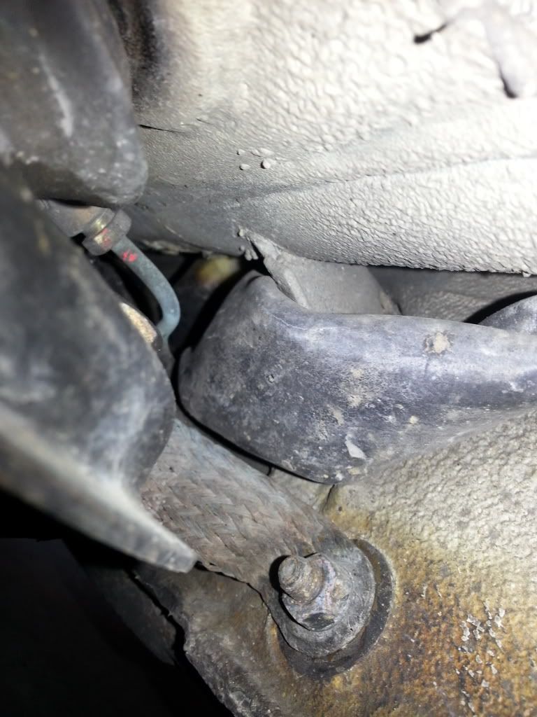

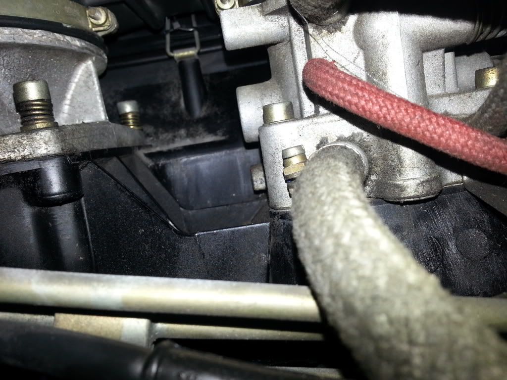

I put new vacuum lines on it last night and will go for a test today, one had a dodgy joiner the other a crack at the end.
Is it possible that it just needs a tune with the blocked cat and sitting for 3 years and only doing 6000 miles in 9 years . Could do with a birthday?
Thanks again pelicans
Edit 916 ?
After fitting the new 3mm silicone vacuum lines the problem has all but gone, with out taking on the highway to see 100%.
Now it just runs like an old car, have got new plugs and some intake gaskets on order.
Wasn't aware that you could adjust the WUR maybe I can drop it down a bit and put another 100 in the idle adjuster.
The WUR is vacuum assisted 089.

Check if you have a 089. It can also be a O90.
You had low revs before adjusting your WUR. Next you adjusted. How did you adjust?
I had low revs once at cold start, this turned out to be too low cold control pressures. This flooded the engine. I have now increased it to almost 2 bar at 15 degrees celcius. Low revs are gone.
2000 rpm at start up is a little excessive but nothing too worry about if they gradually come down to 1.000 over the next 5 to 10 minutes. It makes you look a bit like a fool dough at traffic lights

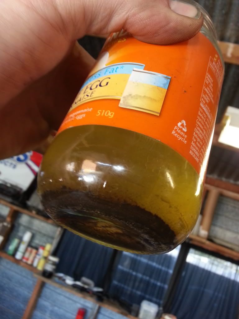

Changed the plugs last night, Number 3 and 5 were wet with fuel also two other HT leads had a green build up.
Cleaned them all up and they are all drawing? the same current now.
Are the injectors or the k jet system serviceable, the injectors seam very loose in the intake.
Have looked into parts and there a 2 orings available per injector are there any more parts that I will need.
Thanks again.
