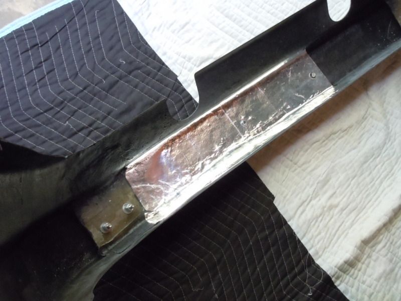

This should probably go in the Paint & Bodywork forum, but there just isn't much activity over there, so I'm posting here.
The car is a '87 Carrera coupe that my brother and I widebodied back in 2009-10. He owned it at the time and I repurchased it not too long after the conversion was done due to a change in his priorities.
During the very first post-conversion drive, the fiberglass RS rear bumper sustained an ugly heat bulge shown here:
After working on the car for 7+ months, I wasn't really in the mood to fix this at the time. But after more than 2 years had passed, I had decided that it was time to get "around to it" because as time passed, the ugly bulge bugged me more and more. So, a few weeks ago I got going on this mini-project:

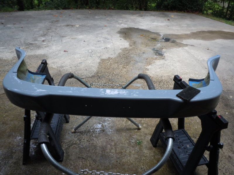

Then the fun (not really...) began. Those of you who have worked with fiberglass know what I mean. More pictures:
Ready for primer. The repaired area (underside) is about 50% thicker than it was and the final glassing was done with cloth, which is stronger than mat. I also installed heat shielding material which is shown in a later pic.

Primer, sealer, color and clearcoat. The ducktail needed some minor repair after a fluorescent light tube fell on it and exploded a few weeks back and I had enough materials to refinish it as well.
Block sanding the primer on the bumper. Also blocked the ducktail but forgot to take a pic.
Installed DEI Engineering 2000 degree heat shielding...

And...all done!

Thanks, guys, I appreciate the kind words. I still have to install a rubber seal between the bumper and rear body/tail lights to fill the gap.
The next 'round tuit' will be to replace the too-large 275/40's that are currently on the rear with a pair of 255/40's (in transit now), then a M&K pre-muffler to replace the too-loud cat bypass, then....
