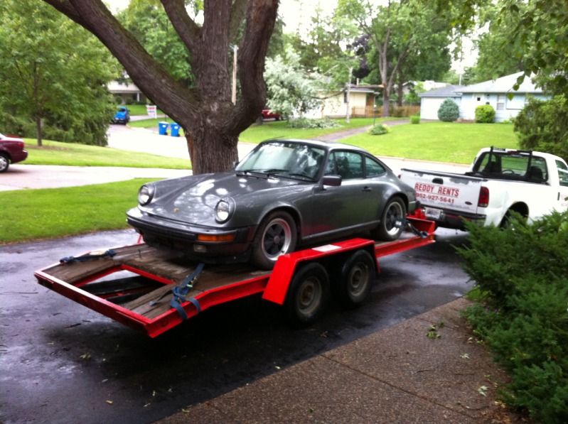

Okay, it's official. After building a couple dozen muscle, sports, and classic cars, I've caught the Porsche bug bad!
My wife is at her high school reunion and left her shopping money in the safe. I got bored and found this sweet little 1984 carrera for sale. When she finds out, I'm blaming you guys.
Two owner 111,000 miles. Runs great, but nothing has been done to it. No valve adjustment, no new clutch, no new paint, just regular oil changes and preventive maintenance. However, its' never seen rain (until today) or snow, the paint is excellent (one tiny door dink with slight dent). Suspension squeaks, but is solid and it handles great. Engine starts right up, but often sticks at about 1500 rpm. No biggy and I got it cheap. Almost too cheap to cut it up, but it needs some TLC.
I have a 50,000 mile 1995 3.6L engine and lots of other thoughts, but what would you do? Here are some pics:
Here's her sister:

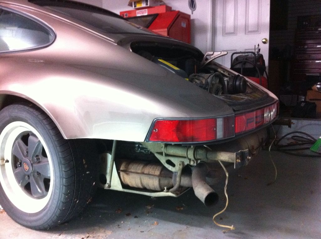

She'll never accept this as needing any additional investment:
However, after a few hours work (I got to get a better camera):
Definitely looks like it needs a home and some attention. This way, when all the boxes start showing up next week while I'm at work,she'll know they are going towards a good cause.
