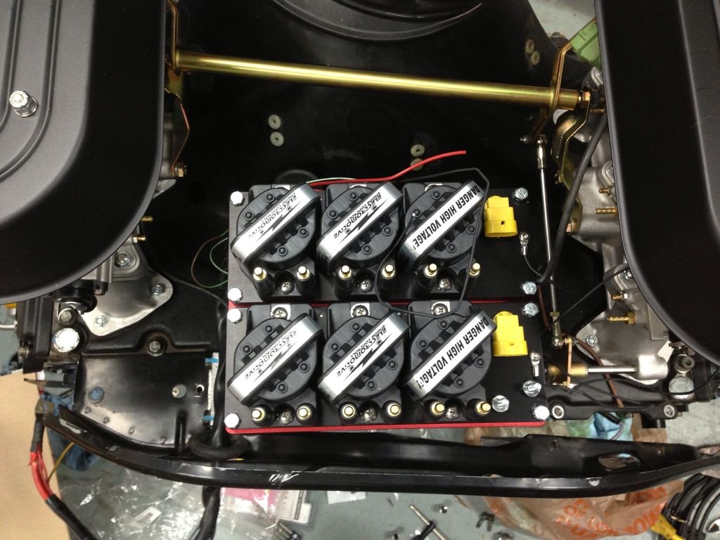

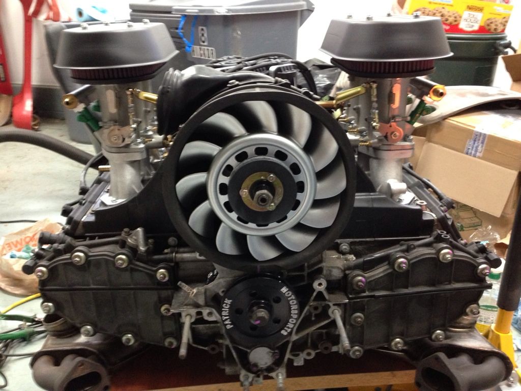

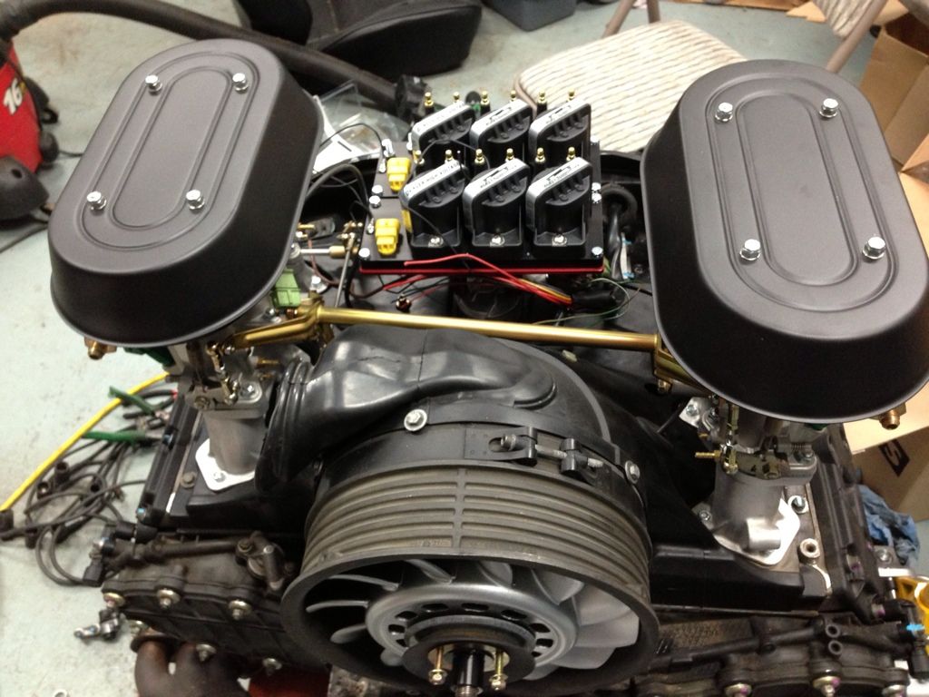

I installed the coil pack today and would have run the wires, but I spent way too much time calculating where 90 degrees before TDC (Z1) is so I could drill the cam and add the cam shaft position sensor.
I also finally finished the fan. I need to get a belt so I can set up the fan pulley. It is starting to look like a real bad ass!

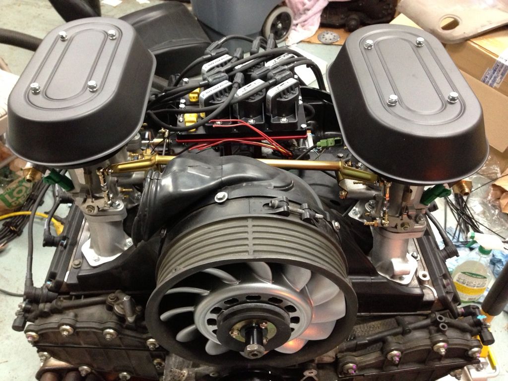

How is it that I feel like I worked on the engine most of the day today and got little accomplished?
I finished installing the cam sensor, trimmed the sheet metal so it would fit, installed the RSR modified fan, and installed the spark plug wires. Where did the time go??? Here are some pics:
And my favorite shot of the day. How it will look in the car (well, without all the crap and empty boxes strewn all around):

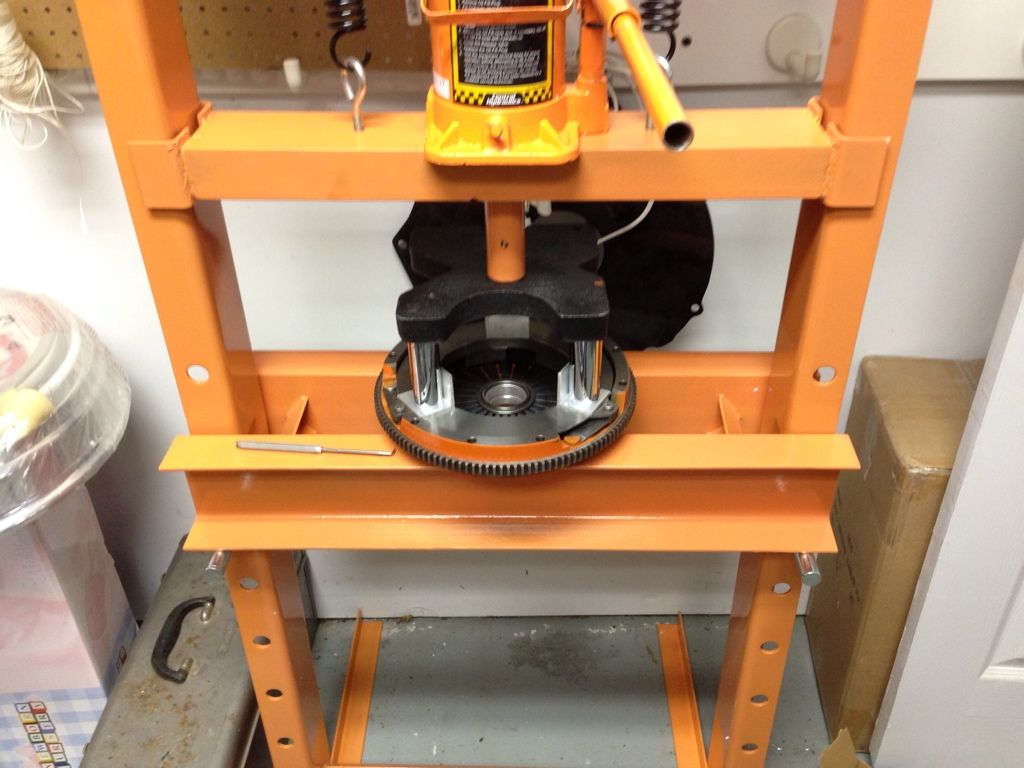

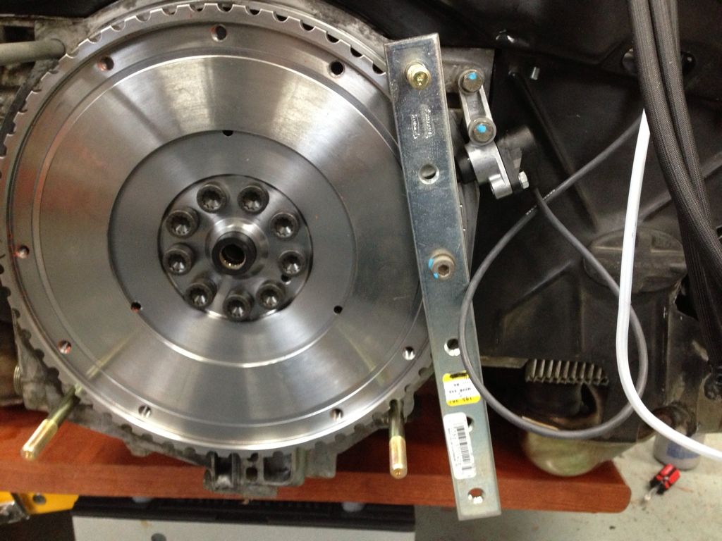

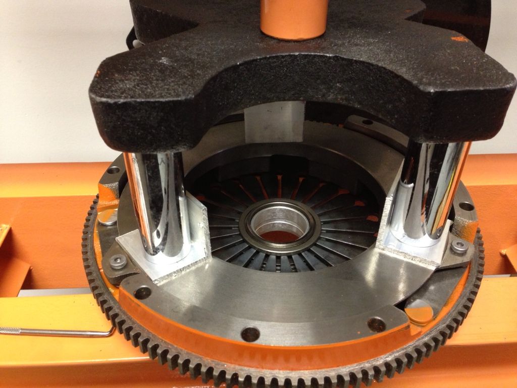

Installed the pilot bearing in the flywheel and then bolted the flywheel onto the engine with a little drop of red loctite. Here's my cheapo Porsche tool to hold the crank ($6 Stanley gate strap with the top hole drilled out to fit over the stud).
There aren't many Harbor Freight tools that I will use, but this 20 ton press for under $200 is one I will use. If you own a Porsche, you will need it for a whole variety of tasks.
In order to install the throwout bearing, you have to compress the pressure plate. It doesn't take much (just more than you could ever do manually). I used three equal length deep sockets with a small piece of aluminum angle underneath to protect the pp surface. Once the pp is compressed, you can slide the t/o bearing in from underneath, slide the thrust ring over the top, and snap the lock ring into place. The trick is to use all three of your hands. Don't have three? Well, you're kind of screwed. Actually, while you hold the t/o bearing in place from underneath you can catch the end of the lock ring in the groove and press as much of it into place as possible. I then used my angled pick (bottom left corner) to press it fully into the groove. It makes a nice satisfying click when it drops into place.
Next I installed the clutch. I slipped a wrench over the crank pulley bolt and braced it against one of the studs to keep the engine from turning. The torque on the pp bolts is only 18 ft/lbs, but that is enough to turn the crank. This is a universal clutch alignment tool. It has interchangable tips to fit a wide range of pilot bearings. Some people don't like them, but I've never had a problem using it. It holds the clutch disk in place.
I threaded the top bolt into place loosely just to hold the pp in place temporarily. Then each bolt got a drop of blue loctite and was hand threaded until snug. I held the clutch tool tightly in place while I gave the center bolt of each of the three sections a full turn. This locks the disk in place (hopefully, the correct place!). Because you are compressing the pp as you tighten the bolts, I criss-cross back and forth snugging each bolt no more than a turn or so at a time. Once they are all snug and the pp completely compressed. Each bolt gets 18 ft/lbs with the torque wrench.
