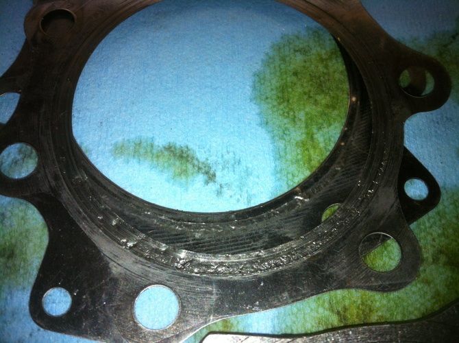

Gear lash noise under load + gear lever in 2nd moving backward under load pointed me to output shaft walking. Well, I was right......

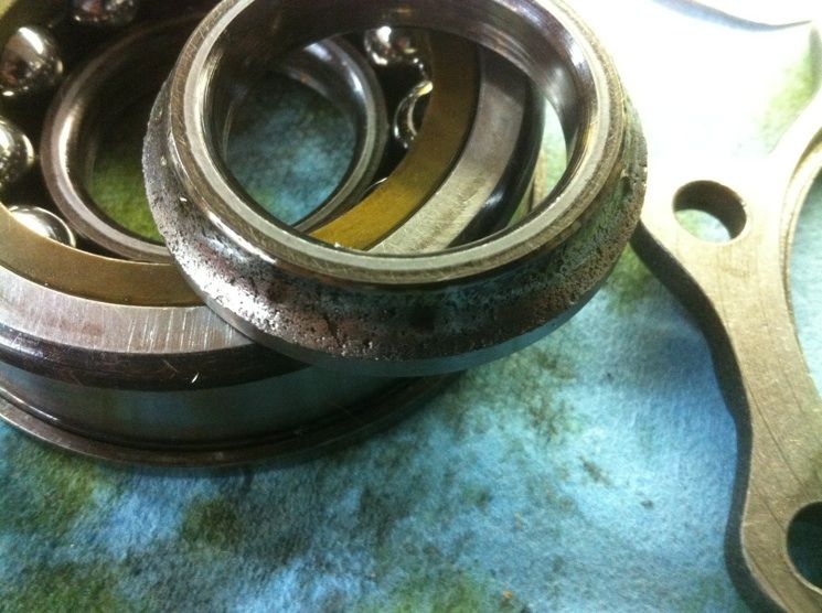

Pulled motor/trans and first pulled side cover and diff. I caught it right in time as the R&P are still in perfect shape, but there was about 2 MM of for/aft axial play on output shaft. Further dissassembly showed why.
4 point bearing had axial play as well a trashed inner race (on the pinion side). The bearing retainer and pinion shims were beat to hell, and the roller bearing race was spun in the case.
The good news was that the rest of the trans was in great shape! All teeth present and accounted for! Plenty of friction material on synchro bands.

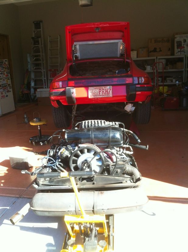

Out she comes! First time drop. Did it in just under 4 hrs by myself!
4 point bearing race
Shims beat to hell
Beat up retainier
This surface should be flat. Look at the trough that had been beat into the retainer by the bearing

A lot of times the bearing race is loose in the case. I *think* that bearing is supposed to be a slight press fit. They seem to pound out the case and get loose. Could you spin the bearing race easily in the case with your fingers?
Yes, I mentioned that in my original post. I dimpled the raceway and used Permatex bearing mount to hold the race in place. I know not everyone on Pelican recommends doing this, but this was suggested by a well respected Porsche independent shop owner in Tempe, AZ who has performed this fix many times with good results. There was no side to side play between the case and the race, it had just become a slip fit.

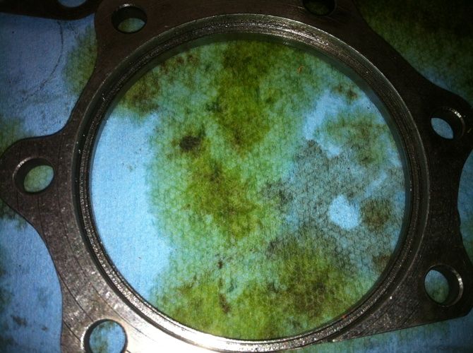

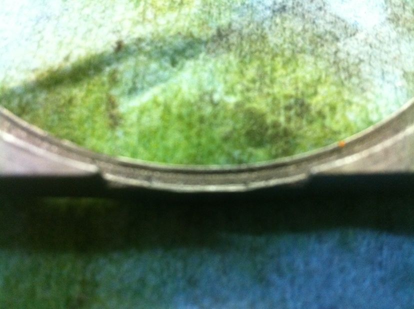

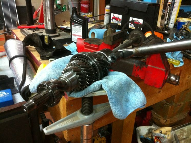

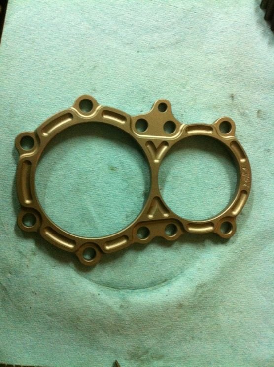

So once the new 4 point bearing arrived I did a test fit into the used replacement bearing retainerr and the fit was recessed rather than flush or proud of the retainer. I went ahead and did a test mount of the bearing with the retainer and shims on the cases without the shaft in place and it was not good. Way too much slop in both radial and axial planes. Not going to work!
So I took the advice of JW and Joe Bob and went with the single bearing retainer from CMS. It's a very nice piece of hardware!

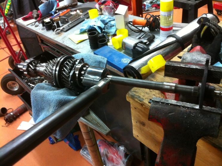

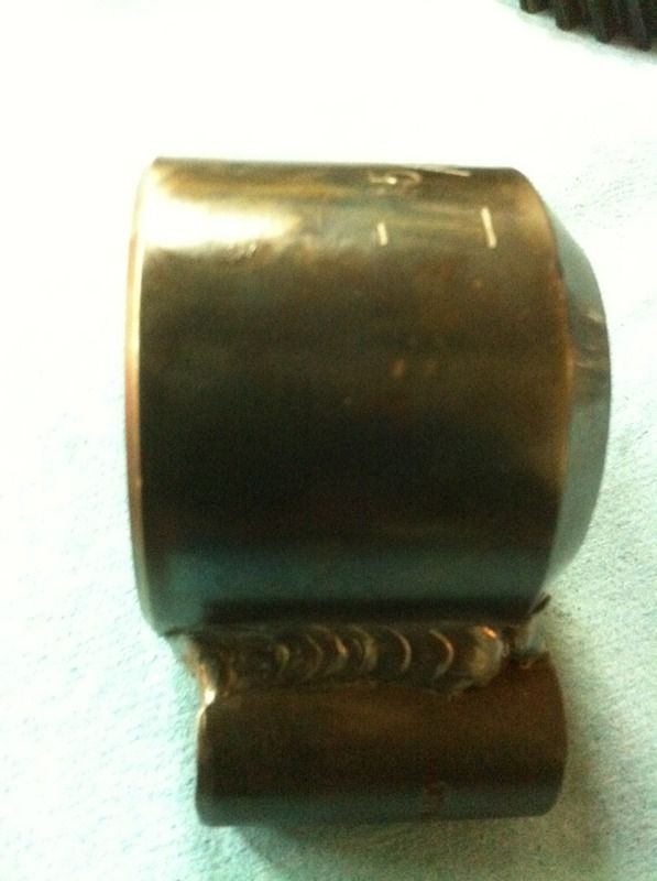

So now that the mainshaft has to come apart, some tool fabrication was in order. I took a page from Jim Sims book and welded the smallest 1/2" drive socket I had as a spare and welded it onto a 1 5/8" socket. I had to cut down the 1" drive 1 /5/8" and bored out the center with a torch to slip over the shaft. Gutted the old clutch disc to hold the the mainshaft at the splines which fits perfectly in the jaws of the vice. Supported everything with a pipe fitters tripod. It all worked great!

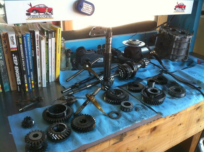

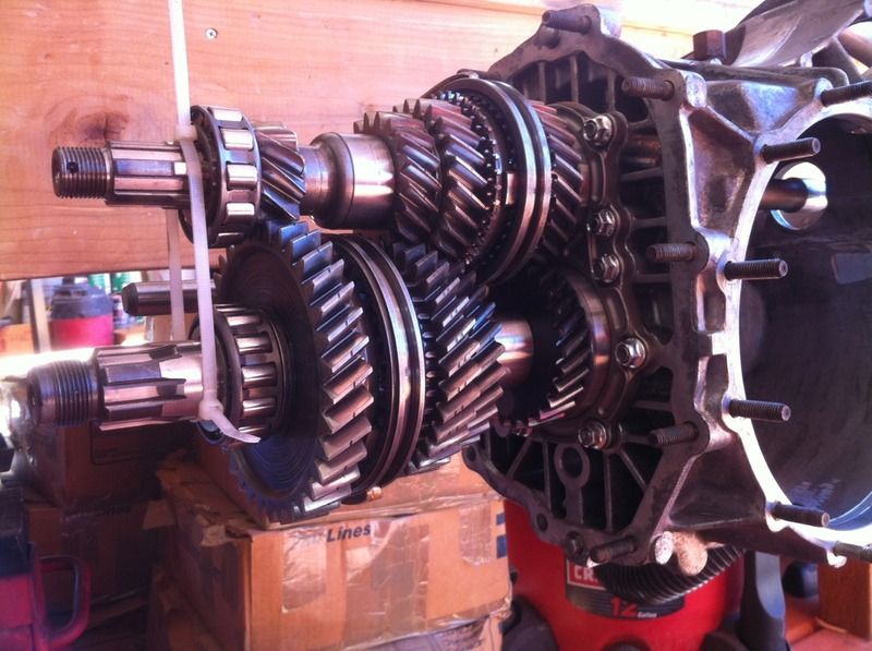

I got the gear stacks reassembled with the one piece retainer in place. I found it easier to do the pinion shaft first, then ziptie the two gear cluster togeher in two places (didn't take a picture), then press on the mainshaft 4 point and roller bearing. I couldn't find any threads on how others had done this with the single piece retainer, but this method worked for me. I then mounted the shafts and gear clusters into the case with the replacement shims.
This is as far as I've gotten with the tranny while awaiting the shift fork jig, which is taking painfully long to get shipped.

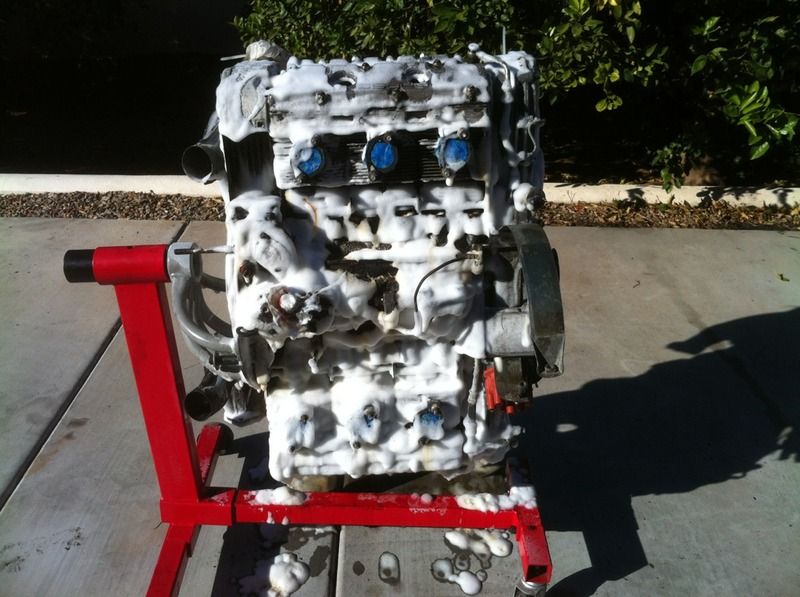

In the meantime, I've spent a majority of the time cleaning the engine and all the other parts. Sodium hydroxide works great for this!
After some spit and polish, paint, and a bunch of new seals and gaskets for the engine and CIS, the engine is anxious to return to duty! Still awaiting the new plug wires and clutch alignment tool to finish.
