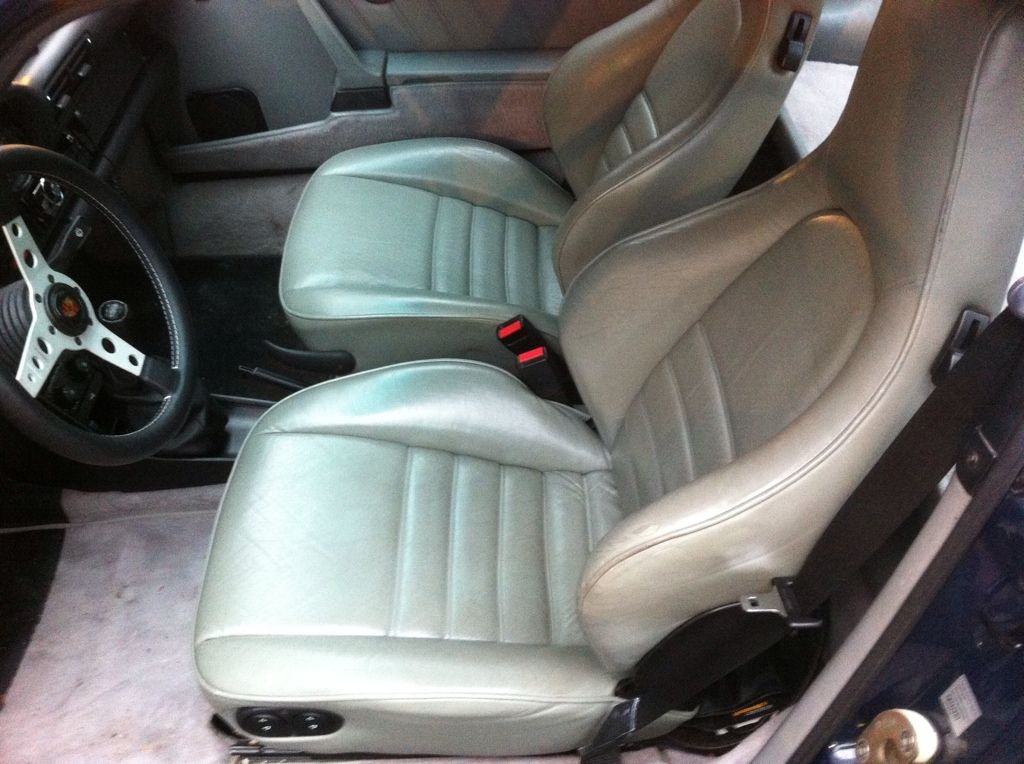

My first 911 was delivered today - and I dont fit in it!! I sat in several cars before making the purchase and thought I had plenty of room. I sat in both sunroof and non-sunroof cars, car with power seats and those without - but never a car with both power seats and a sunroof.
My "new" car is a 1977 911S. It was updated several years ago using just about every single part from a 3.2 carrera (it's really neat). I am 6'2", but I am tall in the torso (31" inseam)
The interior is using the stock leather four-way power seats (two "up and down" buttons - see pic).
However, only the front switch does anything. This is the same with the passenger seat. The main computer for the 3.2 in located under the driver seat (very clean install - looks factory.
I have two questions:
1. what should the reaward control button do on the seat? Right now the front button tilts the entire seat from the front.
2. Can the bottom cushion be shaved by an upohlstery shop to drop me in the seat? I had a "short" cushion made for my 914-6 and gained a ton of room.
I cant believe I have this beautiful machine sitting in the garage and cannot drive it (without huge recline - I can barely reach the wheel - pretty silly....)
Thanks in advance for any help/direction!!

The reason you are having an issue is those seats are from a much newer car and I think when you mount those in an older car they sit much higher. I think if you got factory seats you would not have a problem.

Those look like 993 seats to me (95-98), agree with Mike.

The rear button should raise and lower the rear of the seat and likely gain you the headroom you need. I"m 6'2" with a long torso and I fit (barely) with the seat in my '86 all the way down in the back. With the rear portion of the seat up, no way would I fit. Search hear for a fix on the switches. You should make sure the seat can't be lowered before doing anything drastic. Too me, the driver's seat looks higher than the passenger side. In my car it's the opposite. -J

What Mike said. Those look like they are from a 993. You either need to find non-powered seats or any powered seats from 1978-1989, except 1985 which I believe had higher seat rails.

pretty sure the buttons you have should only move the seat up and down (front and rear portions of seat bottom). you should have a latch under the seat to slide it back and forth. That seat looks a little forward to me and not all the way back. Not sure if the conversion to those new seats effected anything. I am 6' and do not have my seat all the way back and have plenty of room. (my seat is old and a little depressed so height is not an issue)

See if you can find some kind of wiring chart for those seats, or pull one and see if there is a plug/wires that are either cut or missing. Then maybe you can get the rear buttons to work. If this does not work then you can sell those seats and purchase ones that will work for your car. Heck, might even be able to trade. I'm not sure shaving that seat would work out for you.
Or, get real creative and shorten the rails.

yes they are 993 seats , what you need to do is take the seat out and the 2 wires to the motor for the front put to the back motor , then you can put the seat back down and see if you fit in it

Why not just run some temporary 12v to the seat motor and make sure it is all the way down. Drive it for a while and then make a permanent decision.

Although these are later model seats and not sure if they sit higher than stock even at the lowest setting, attempt to clean the switches with lots of contact cleaner. I was able to get my rear button to work temporarily to get the back of the seat down. Remember, electronic contact cleaner makes things ice cold and BRITTLE. I broke my switch, so take it slow. If you have power to the seat, you should be able to get it to work at least while you are spraying fluid in there.
