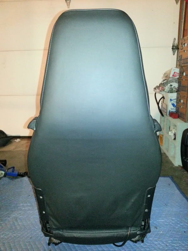

Originally Posted by McLovin View Post
post pretty much any interior pic you have up. I'll tell you if it's a full or partial leather car.
Okay here you go.... but don't say I didn't warn you about the pic...
thanks

If that is an '87, I would say it is Lipstick Red, full leather.
JR
It is an 87. That would be welcome news. What are the tells?

Well, for one, Lipstick Red was not available in vinyl...
