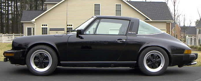

I have 15x6 with 205 60 15 all around...my car is lowered to european ride height. I do have tire rub during hard corners on the track...but no rubbing at all during normal street use.

Old 07-04-2002, 11:10 AM
drag racing the short bus
dd74's Avatar
Join Date: May 2002
Location: Location, Location...
Posts: 21,983
K9: never had rubbing on the street, either
I guess it's because of the greater load generated on the track that you'd have the rubbing. So, if my 15x7 rubs in the rear during street use, it'll probably saw like crazy on the track.
