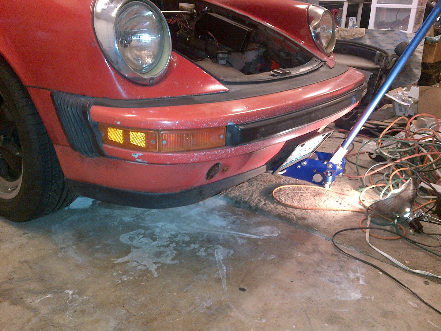

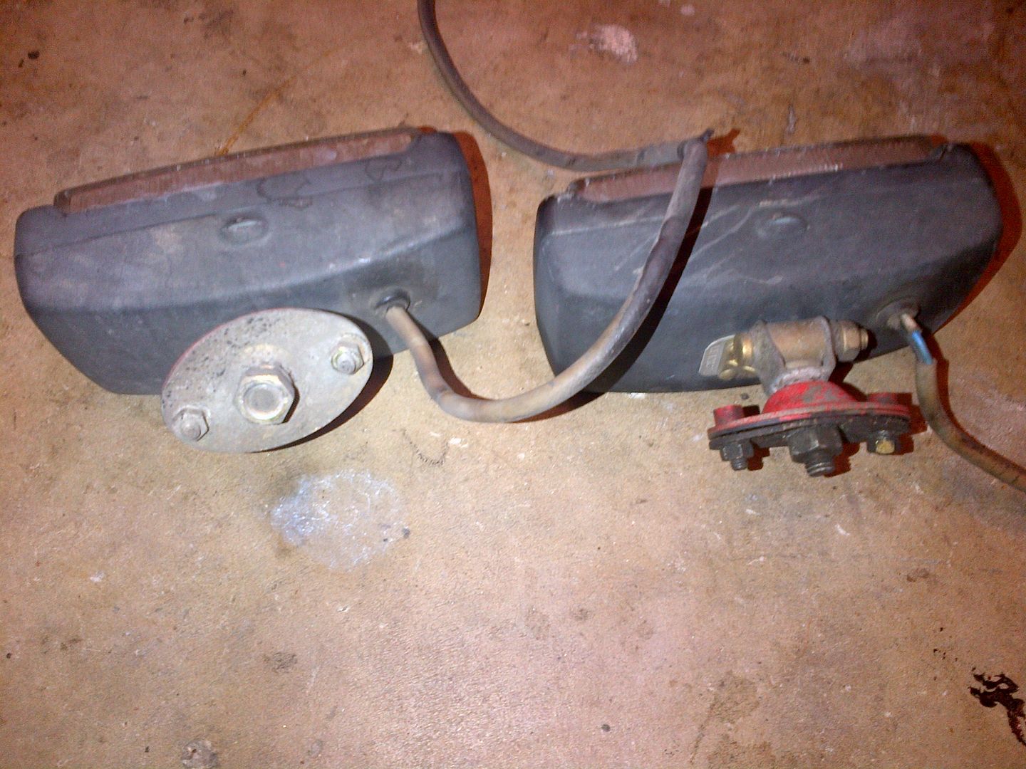

Hi guys - so I pulled the fog lights the PO put on the car and as expected they weren't actually connected to power in anyway. The wires we duct taped to the rear of from the front valance. Nice, eh?

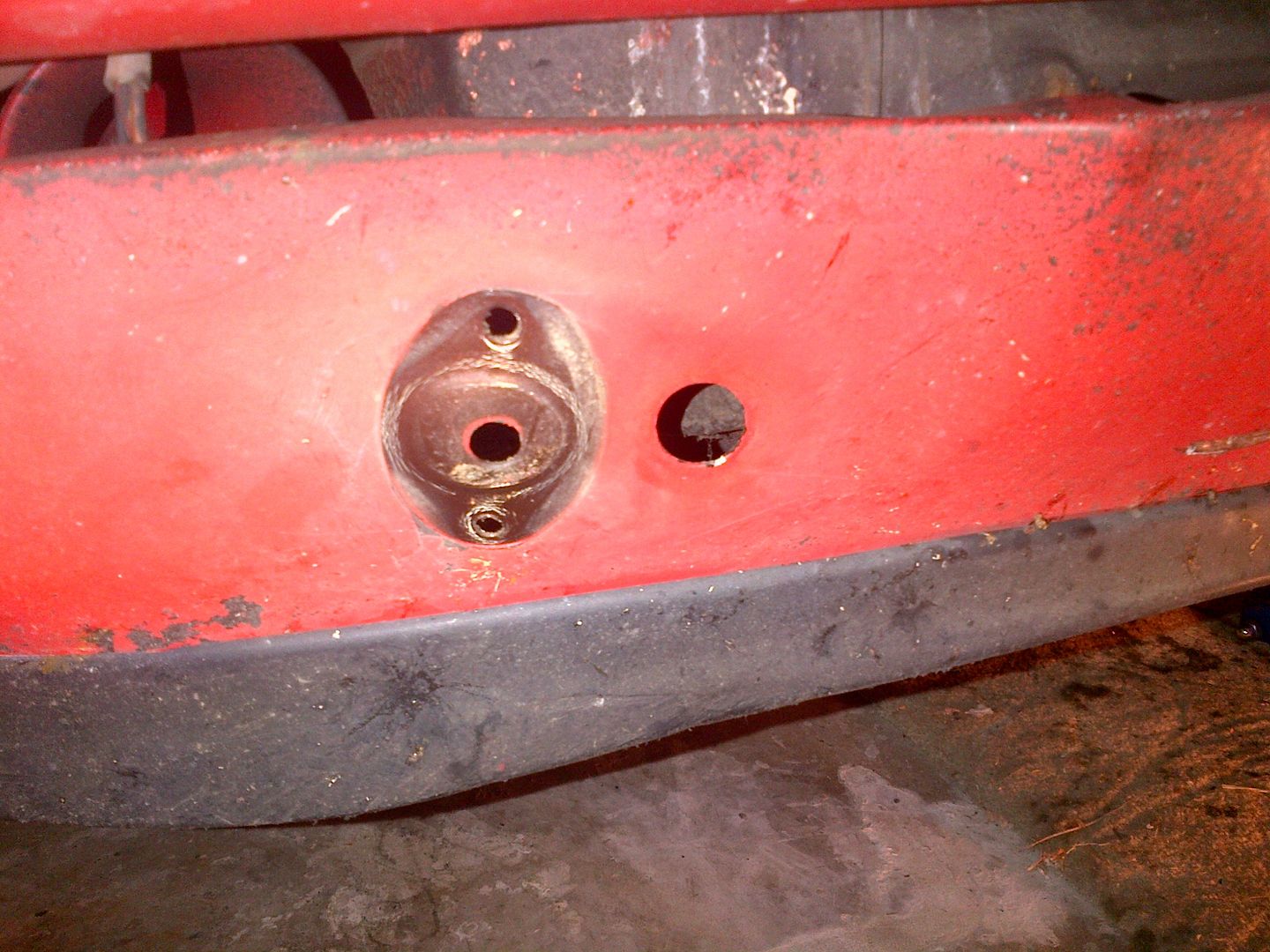

When I removed the fog light mounts I was a but surprised to see what looks like factory openings there. Is this normal? Does it suggest my car actually came with fog lights from the factory, or is it more likely the PO swapped out the front valance?
Removed - hard to imagine but she was FAR worse before, even though she an't pretty now.
Opening where they were mounted;

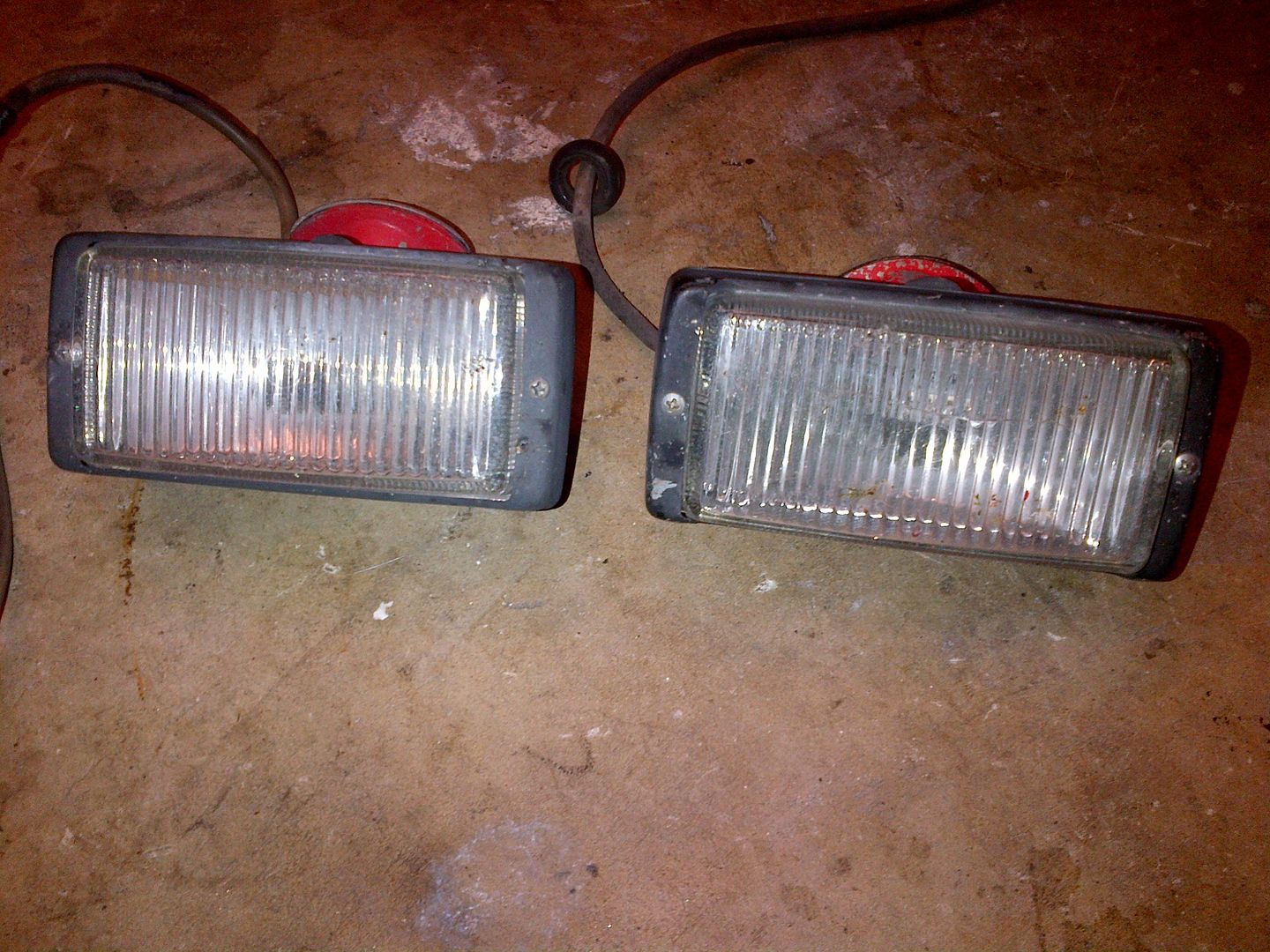

Lights

Hi guys - did some more poking around last night and it appears there are factory valances both with / without fog light openings.
Is going back to a non-fog light opening as simply as swapping out the valance? Short of a build sheet is there an easy way to tell what she would of come with?

You can swap out the valance or just weld the holes closed and repaint what you have. Fog lights were optional. They became pretty common in the later years, almost so much that nearly every car had them. In 1974, they were a little less common. I'd say if you have a fog light switch, the fog light relay and the factory harnesses for the fog lights, your car probably had them from new. Only way to know for sure is to get a COA from Porsche.

It bolts on. Two in the front wall of the trunk, one on each side to a bracket under the fenders. Also, look at the small metal piece aft of the bumper bellows.

Just take the valance to a body shop. Closing the holes won't take much time or money. The valance and bumper need to be painted anyway.
