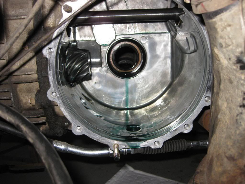

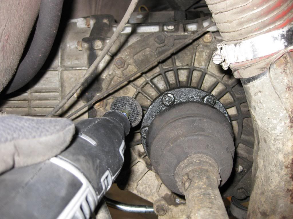

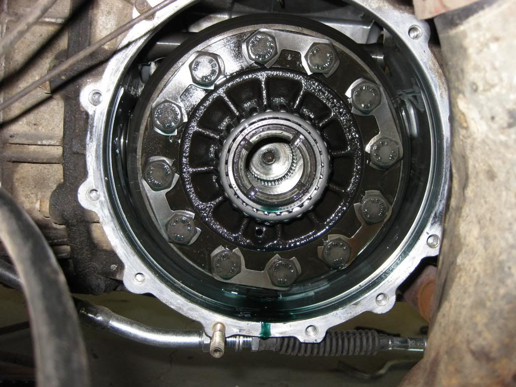

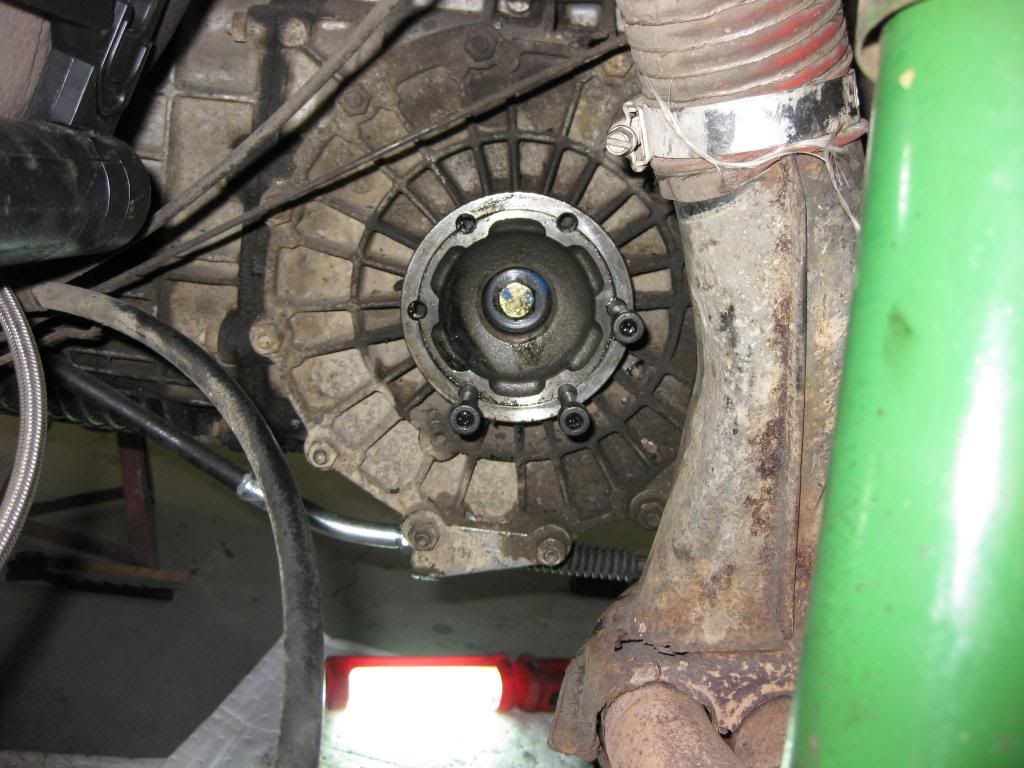

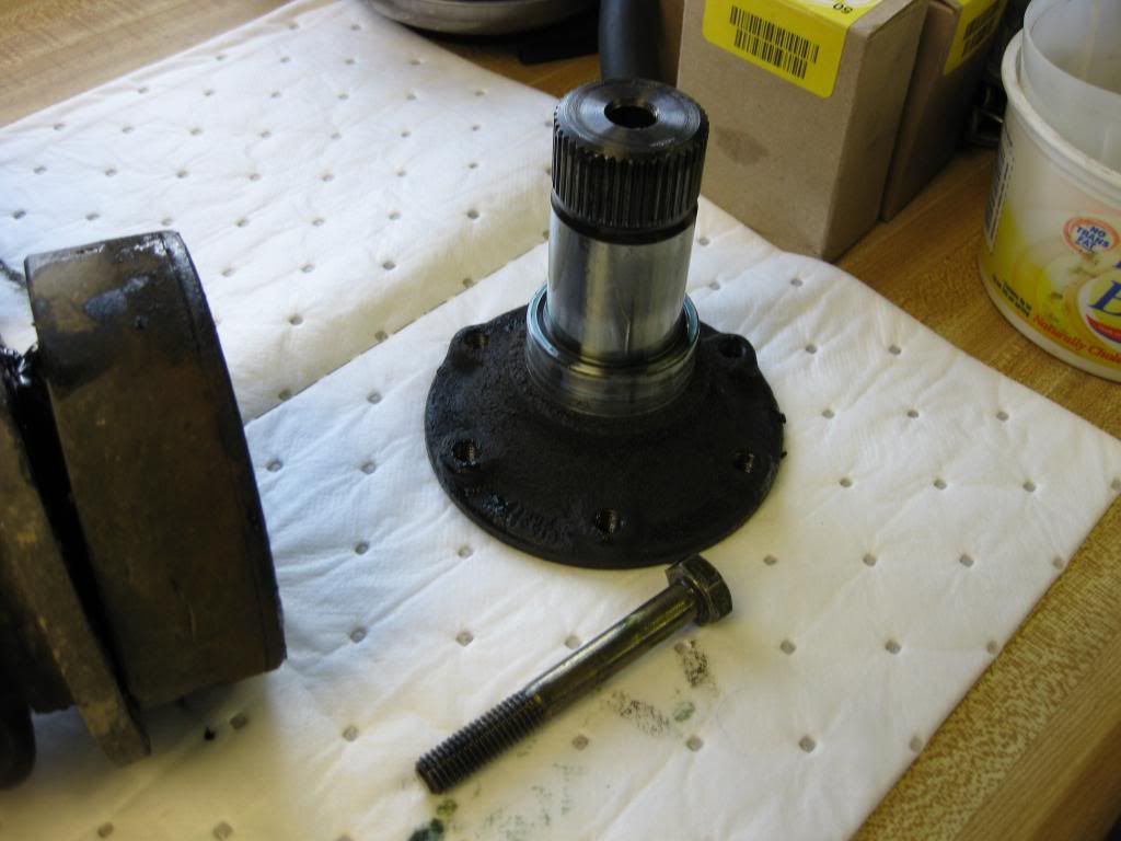

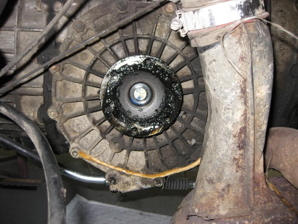

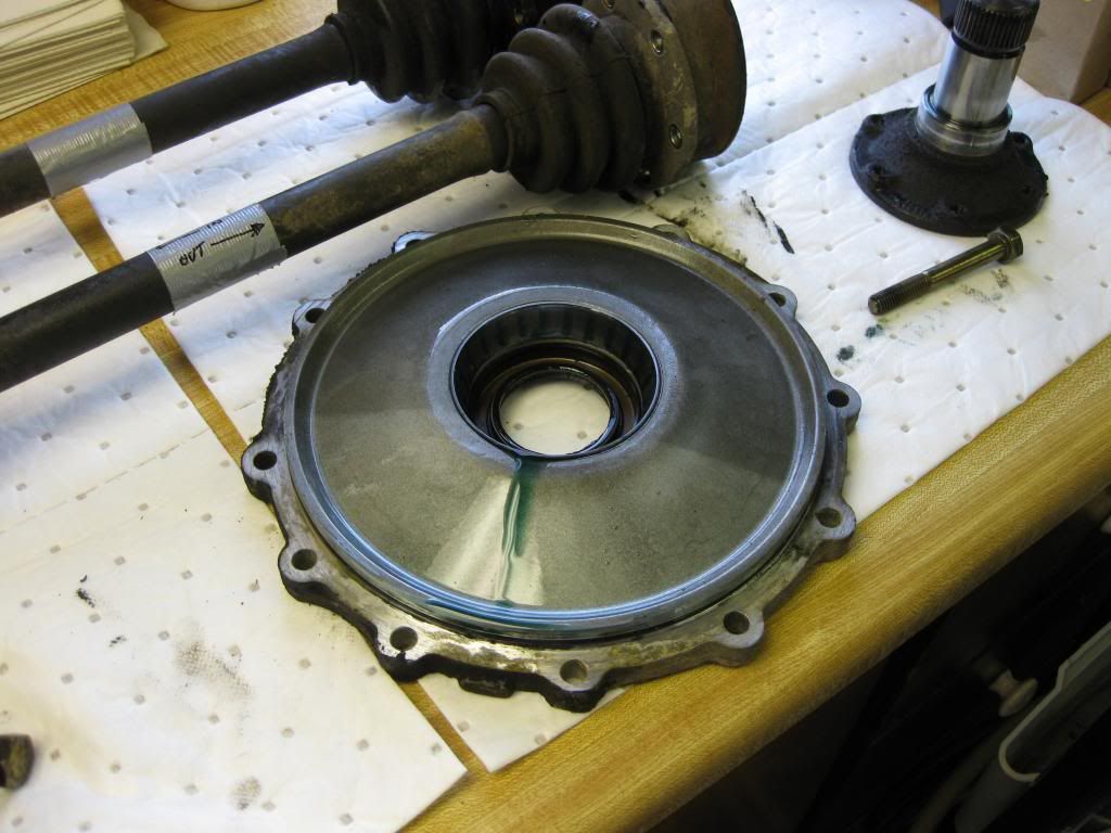

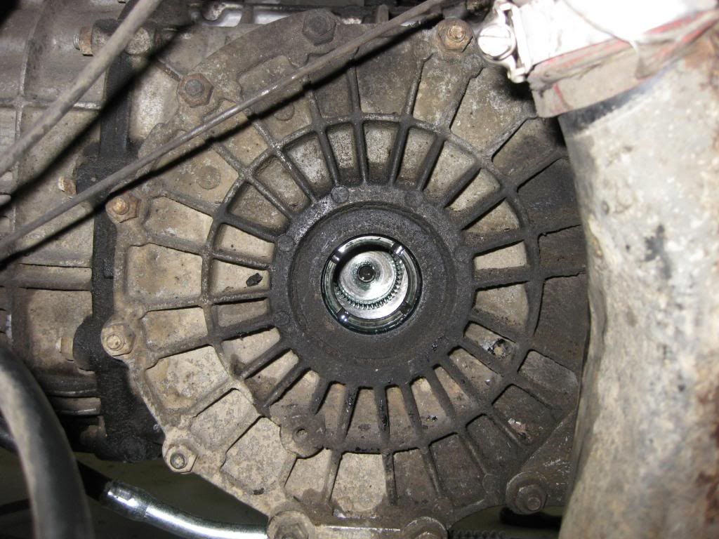

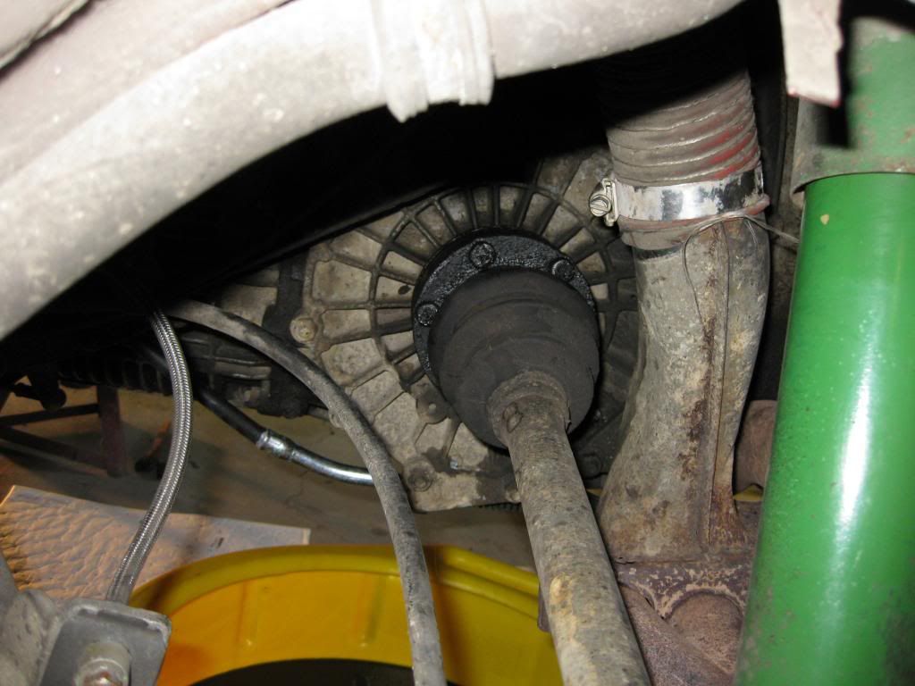

Andy911sc 03-24-2013 05:59 PM
photo update
http://i1180.photobucket.com/albums/...psb22f50ad.jpg
http://i1180.photobucket.com/albums/...ps89a4a5d8.jpg
had to only cut one
http://i1180.photobucket.com/albums/...ps6ec332b4.jpg
http://i1180.photobucket.com/albums/...pse61fbd78.jpg
http://i1180.photobucket.com/albums/...ps284b8f52.jpg
http://i1180.photobucket.com/albums/...psc383b074.jpg
http://i1180.photobucket.com/albums/...psc61f5c63.jpg
http://i1180.photobucket.com/albums/...ps5505281d.jpg
http://i1180.photobucket.com/albums/...psb35f95e2.jpg

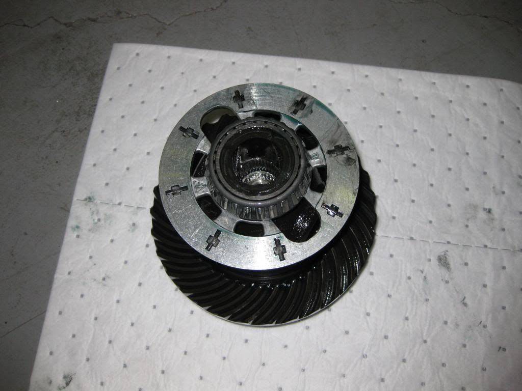

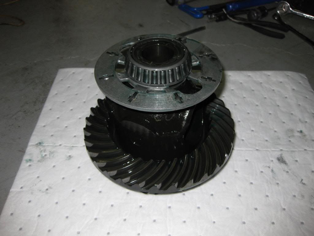

Andy911sc 03-24-2013 06:01 PM
http://i1180.photobucket.com/albums/...psce1f6fc6.jpg
http://i1180.photobucket.com/albums/...psd0a73eaf.jpg
http://i1180.photobucket.com/albums/...pse8aa6894.jpg
http://i1180.photobucket.com/albums/...pse0c91b10.jpg
http://i1180.photobucket.com/albums/...psa32b9f50.jpg
http://i1180.photobucket.com/albums/...psa07c5e74.jpg
cashman 03-24-2013 06:39 PM
So it looks like ther ARE 8 magnets after all. Keep us posted if you find out why you only get 4 continuity hits.
Andy911sc 03-24-2013 06:55 PM
Yeah, looks like I have more to figure out
James Brown 03-24-2013 07:06 PM
good training, are the magnets still strong? i bet they are. Nice and clean in there

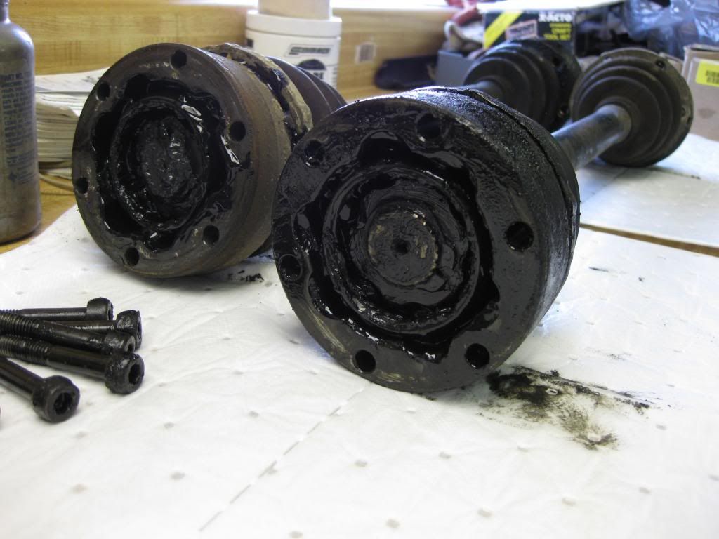

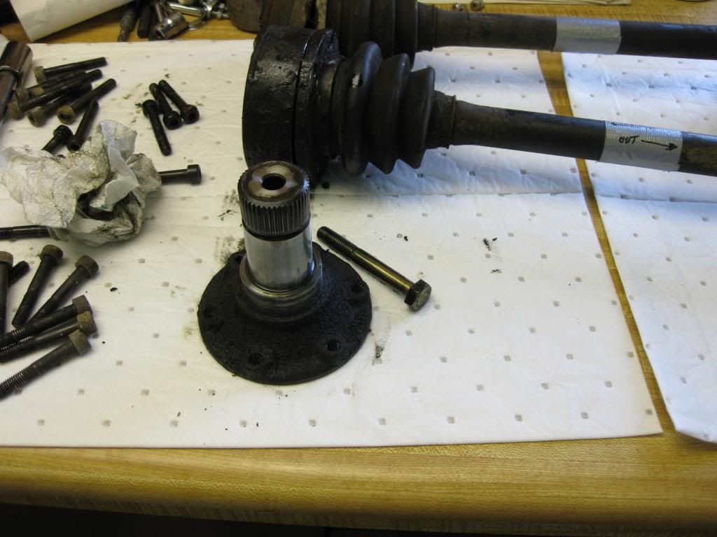

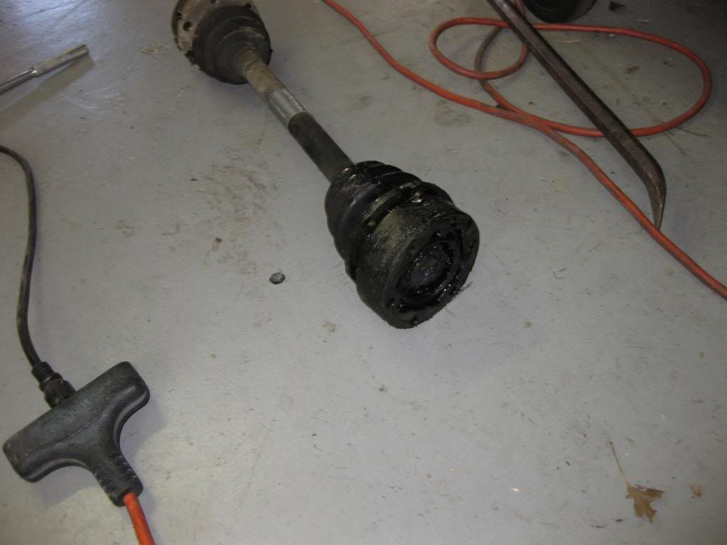

KTL 03-25-2013 06:44 AM
Looks like you could use a new axle flange seal on the side cover.
Also, no better time than the present to inspect your axle shafts. Pivot a CV joint and get a good look at the groove the ball bearing rides in. You can swipe away the grease to see the condition of the groove. Some brightness is common. However if you find flecks of metal and the groove is pitted, you'll want to plan to replace the axles in the near future.
brighton911 03-25-2013 07:39 AM
Let me tell you my story that may relate to your issue. After I rebuilt my 915, my speedo registered about 1/2 what speed I was actually going. I went through pretty much the same steps you are, measuring the pulses etc. When I dissassembled my diff, I found that every second magnet had virtually no magnetism. Even more curious, it had been perfect prior to the rebuild. I had some suspicion the tranmission shop that I had remove the differential bearing somehow (on purpose?) damaged every second magnet. So, a used magnet wheel from a fellow Pelican member and I was good to go.
69911e 03-25-2013 09:32 AM
FYI: 1 turn of a single wheel with an open differential will turn the differential 1/2 turn.
Andy911sc 03-25-2013 09:44 AM
Yeah, I plan on replacing the axel seals and I have a differential housing seal. I am also going to clean the cv joints, regrease and new seals for them.
Please explain. So are you saying that when I had the car propped up, 2 full tire rotations would have been a full rotation on the magnetic ring in the differential?
69911e 03-25-2013 09:52 AM
If only 1 wheel is turning; you need to turn to rotating wheel 2 turns to get 1 diff turn. Alternatively, you can turn both wheels 1 turn to get 1 diff turn.
It was unclear the state of your second wheel during the test.
