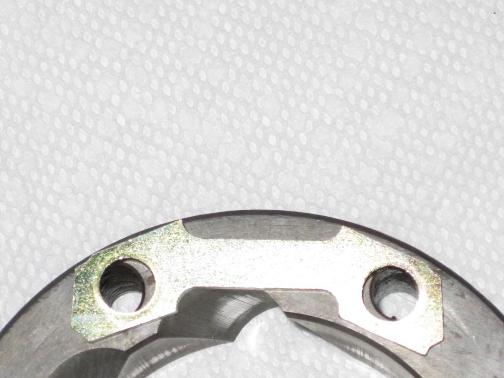

Andy911sc 04-10-2013 07:05 PM
Need some help.
Anyone close by have a used outer for the CV joint that is in decent shape.
http://i1180.photobucket.com/albums/...pscd223147.jpg
http://i1180.photobucket.com/albums/...ps649e301d.jpg
Everything else is in great shape. The inner, the balls and all the other joints. I just need to source the out. I am trying to stay on budget for this, as I will be buying all new cv joints in the next few years.

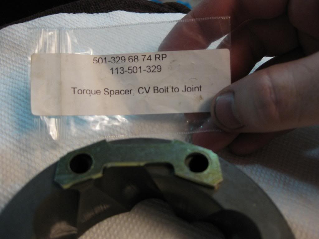

Kevin,
those torque spacers are also too small from VW for the M8 Bolt. See the pictures below.
http://i1180.photobucket.com/albums/...psae58ab86.jpg
http://i1180.photobucket.com/albums/...psde2d15f6.jpg
Since I am running out of time and don't feel like sourcing parts and pay an arm and leg to over night them, I am just going to ax the torque spacers and have my bolts cut down 3mm for clearance issues.
