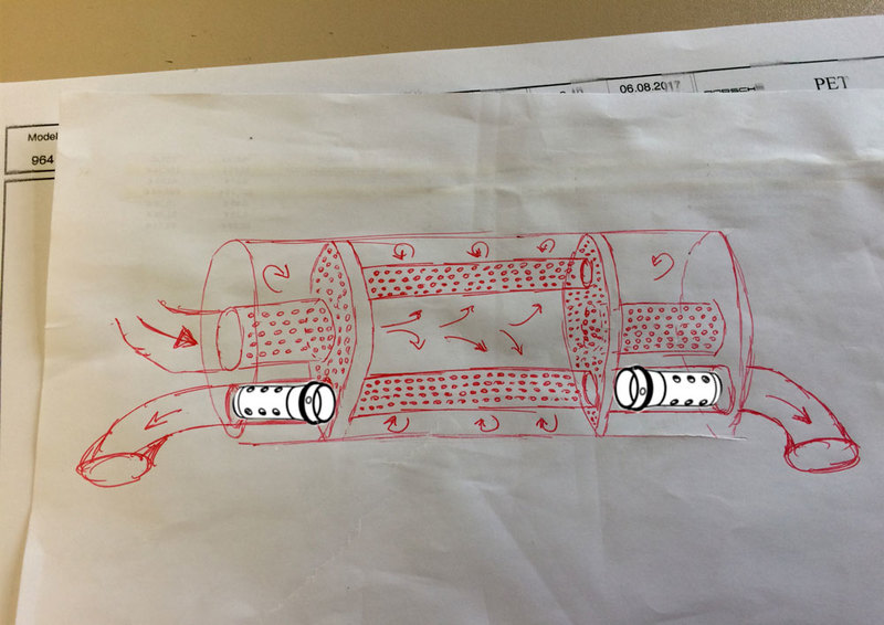

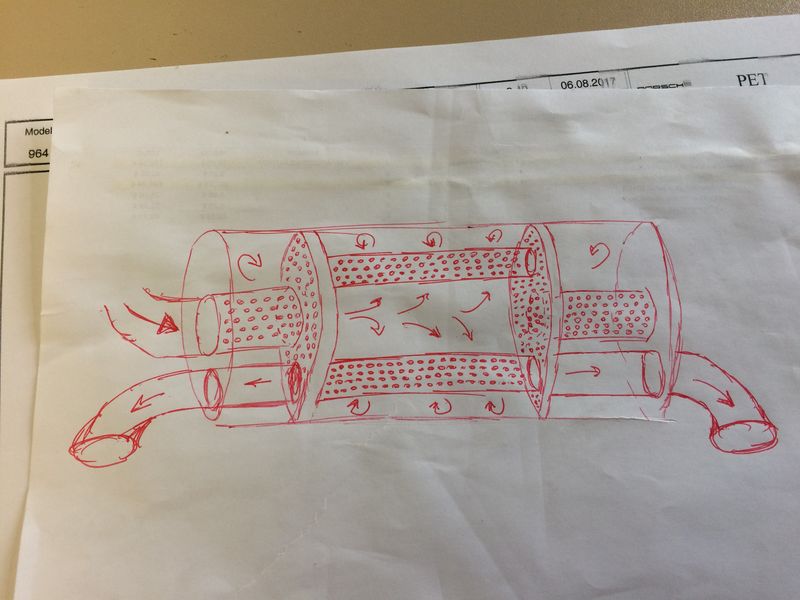

Sorry to bring back such an old topic, but I have this same problem in my car and it is driving me nuts as wife won't ride in the car because of the terrible drone the car makes at highway speeds or when cruising.

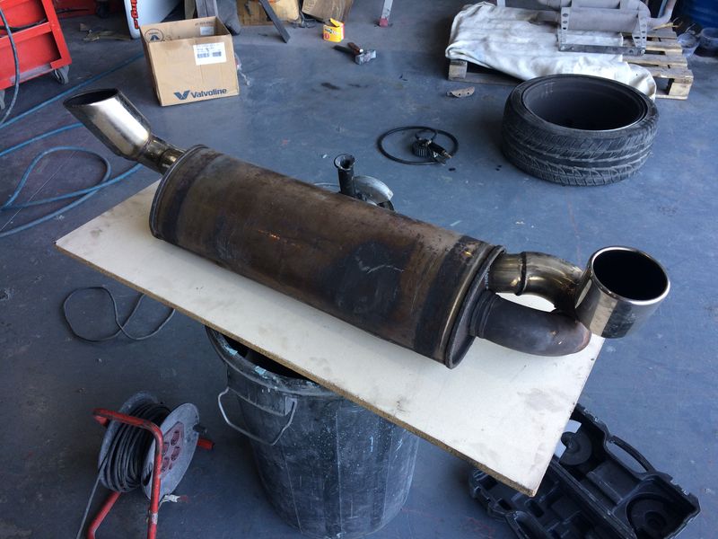

The car is a 964 targa converted to turbo-look by Gemballa in the 90's it had the original mufflers (primary and secondary) and I bought the left valance from a turbo to have both left & right tips. Secondary muffler has been removed the noise has gone a bit up but the exhaust now has a very disturbing drone between 2.000 and 3.000 that makes it very uncomfortable to ride in and makes me try to avoid those rpms all the time.
This is how the primary muffler was modified:
How would I have to install the baffles (dB Killers)? as in pic A:
or in PC B:
Would also be interesting to install another baffle (dB Killer) in the entrance tube of the muffler or that is not necessary?

Pic B is correct.. The round disc end of the baffle goes toward the away side of flow.
